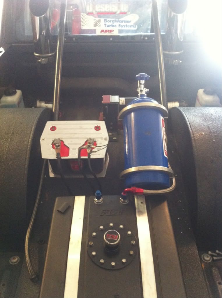

So we won 1st place at the TS outlaw race. We were the least broken in our field. LOL Alomost hit the wall when we blew out a freeze plug on our very first test runs Wed. night. Decided right then and there screw the cooling system, its not needed on a 1/4 mile race truck. So after the TS race I realized she needs a diet, so we cut out the entire cooling system, radiator, hoses, bottles, etc. ALso removed the right passenger seat, belts and mounts, all the carpet, and removed one battery, and one nitrous bottle and moved the other bottle next to the battery.
Its not gonna have time. Tow to line, burnout, 9 sec's of hell's fury, coast to the shutdown lane, tow back to trailer to cool off.

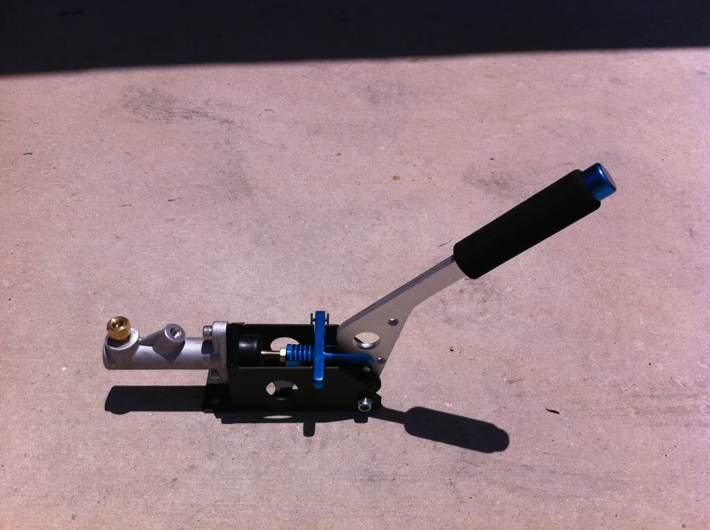

Well decided to put the pinion on a hand brake.
