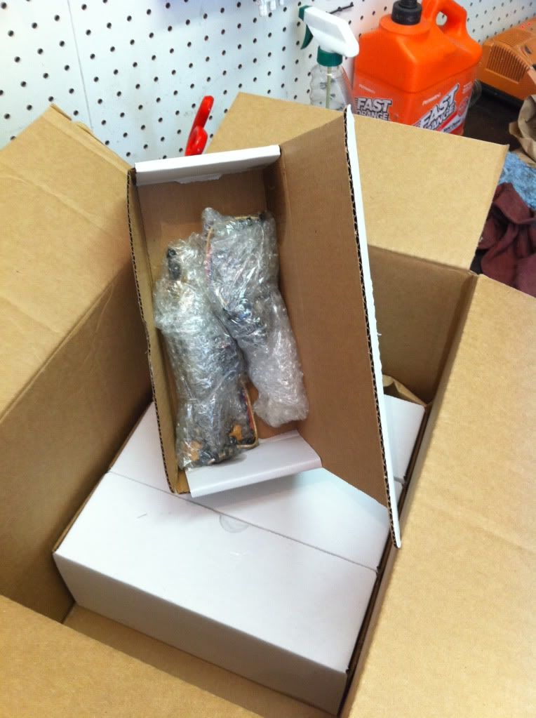

Injectors shipped this morning. Yeah!!!!!!!!!!!!!!!

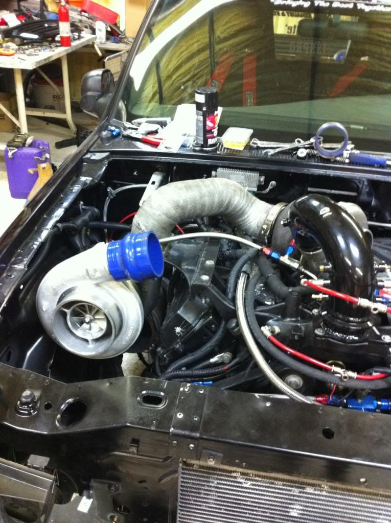

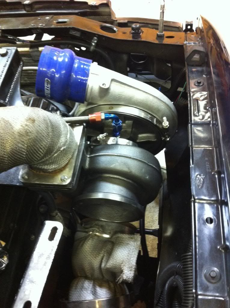

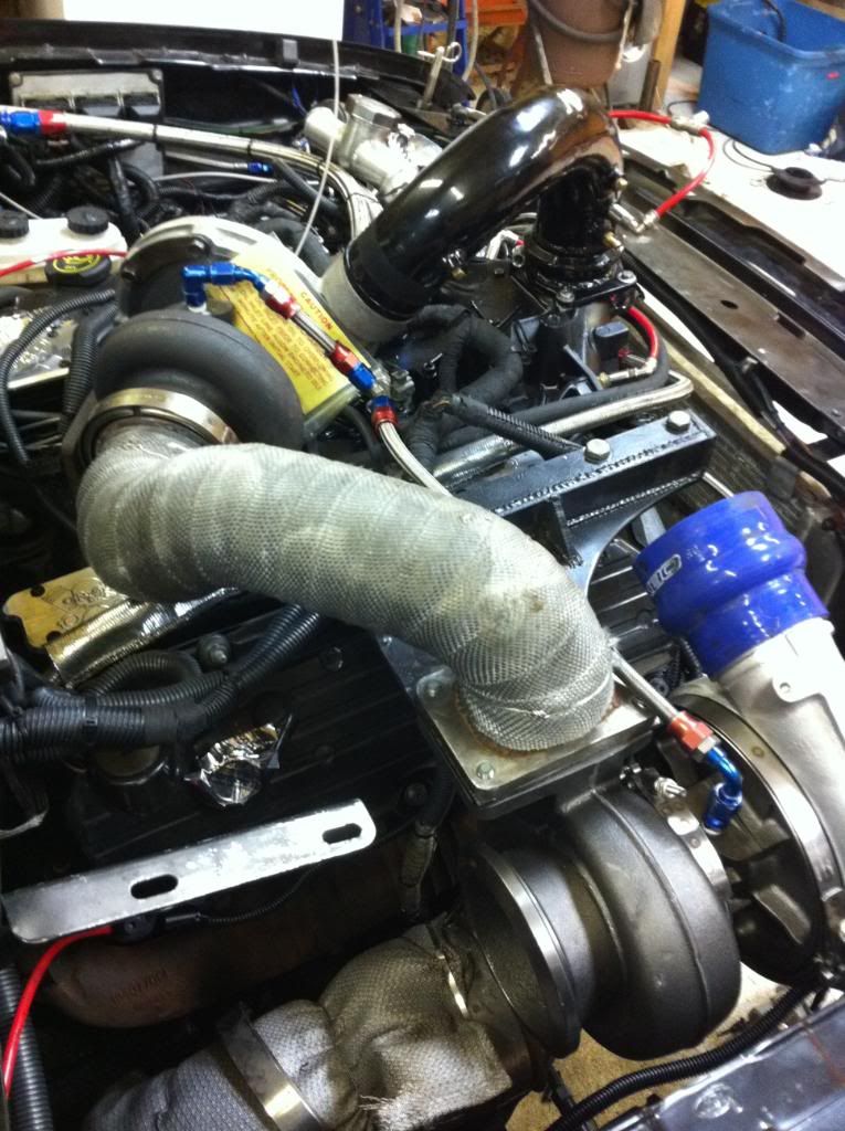

Well, I got the balancer on today, the belt, the radiator, and cross member, and mounted the HP turbo. The LP turbo required a little cutting of the fender well but fits just fine. The Pipe from the LP to the HP turbo had to have the v band flange cut off since the new turbo does not have a V band. I had a boot laying here that some how fits the pipe and the turbo now. Even a blind squirrel finds an acorn every now and then.
Diesel powered, ALL FORD 05 Ranger
Well, the flange was made to actually fit the turbo, and I got it mounted up. Had to "trim" a little of the inner fender but it fits pretty nice. Also convenient that the new turbo has a threaded piece right by the compressor outlet to make a strap so it doesn't blow the boot off.

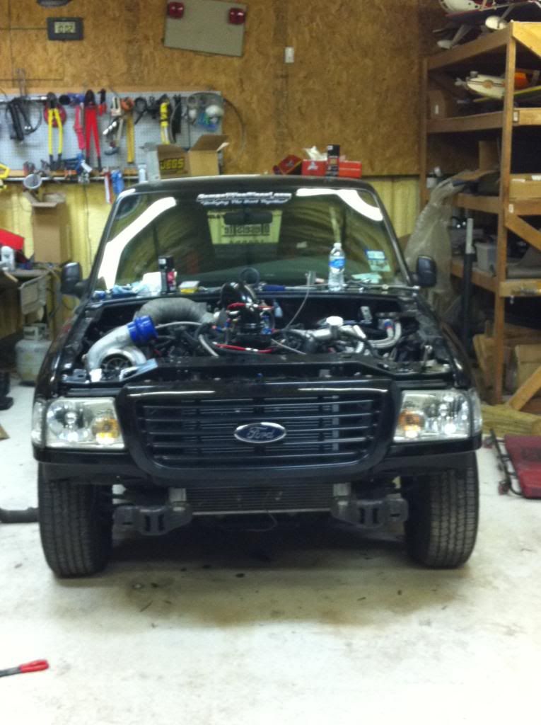

And the radiator is mounted and plumbed and figured I would go ahead and put the grill back on. Injectors get here tomorrow.
Injectors got here today, along with a hurricane. FML I now have everything back. All I need is to get them in, and get one 5.5" to 4" silicone boot for the MAF sensor tube, and air filter element. Oh yeah, and I have family coming in tomorrow till next thursday, then Friday and Saturday is Aquapalooza here on Lake Travis. With any luck though, I can have it ready to go test and tune by July 7th. :nail:

Glad to see it coming back together! That hood deff isnt fitting without a fight with that beast of a turbo!

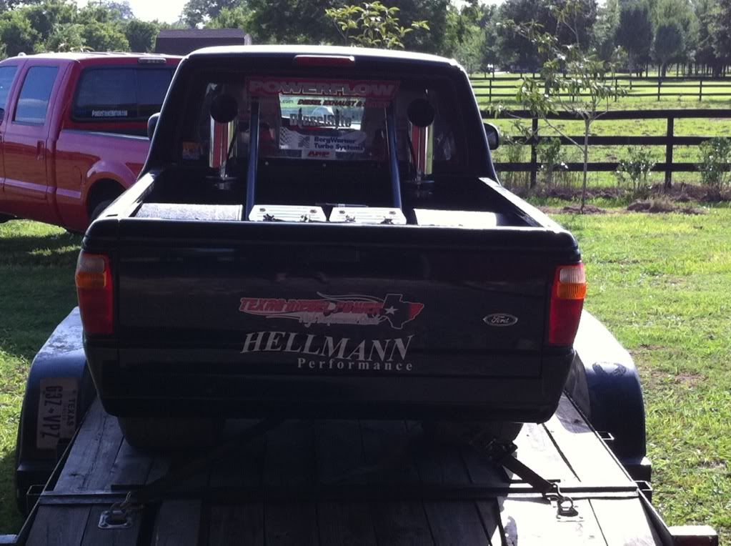

Uh oh, what is that Joe Hellmann up to now?
Nice stuff at Joe's

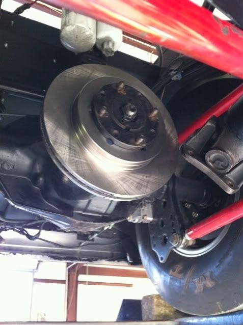

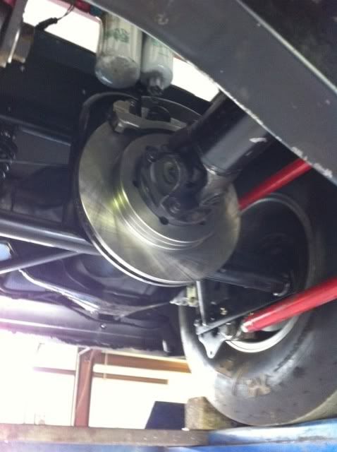

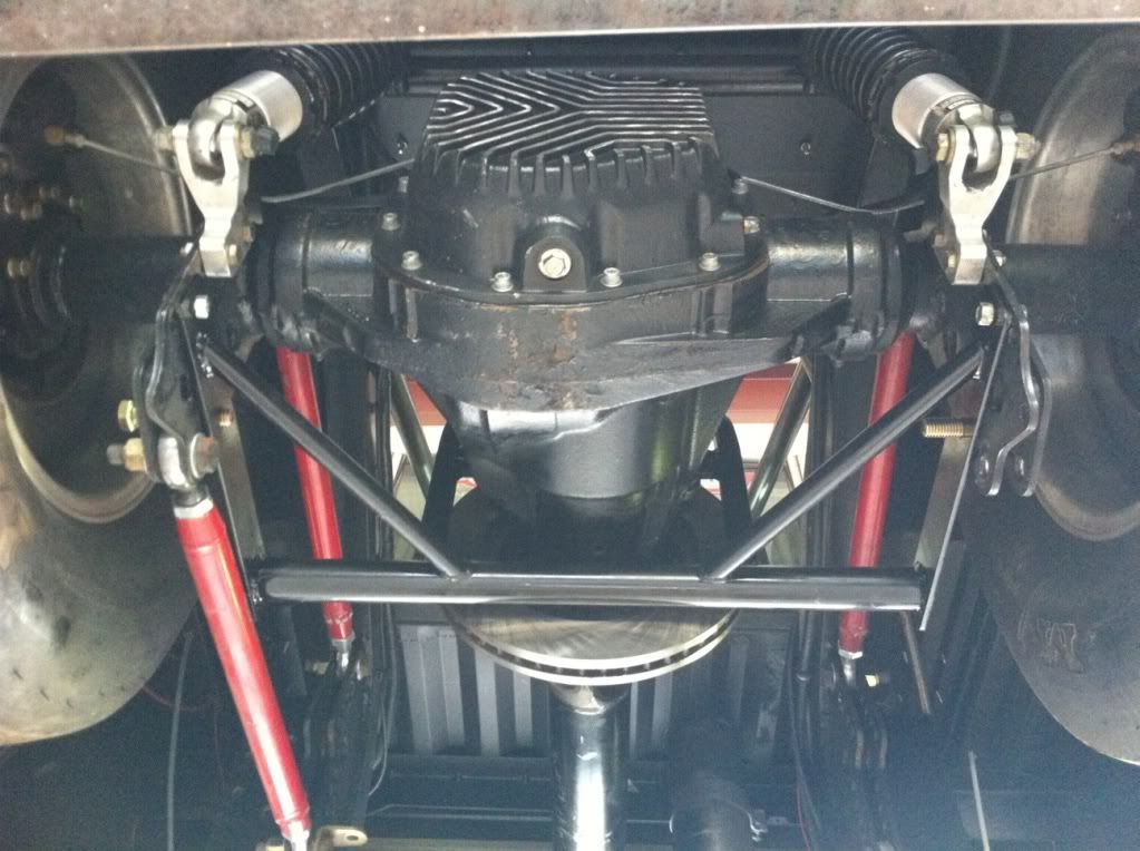

There will be no more problems holding the brakes on the line.

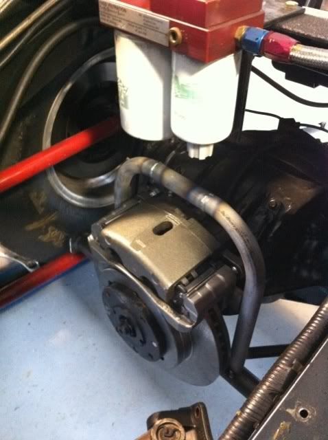

That's pretty clever having the transbrake on the axle instead of the tranny. That should help the driveshaft/u-joints live a little longer.
