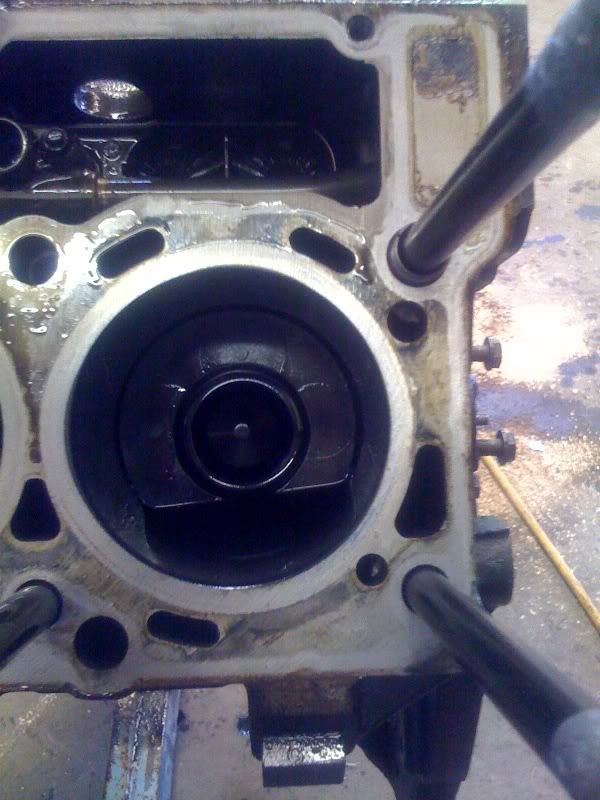

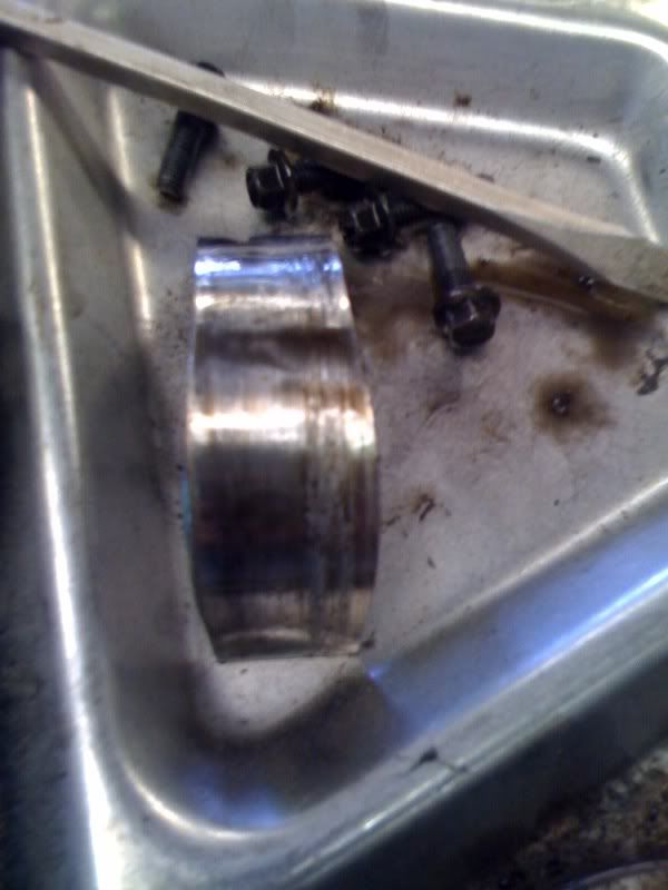

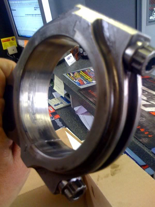

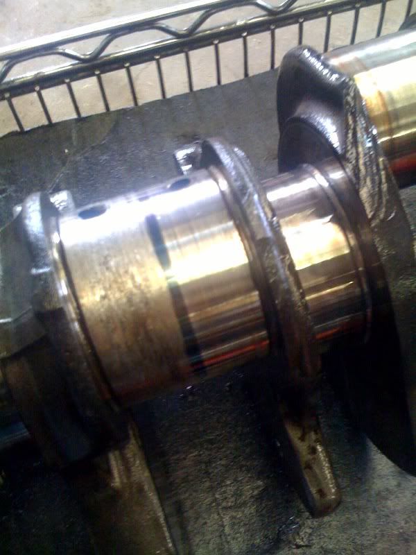

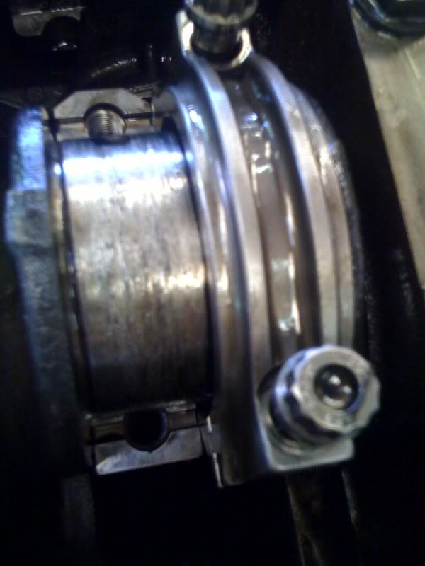

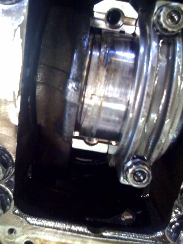

The company that put together the oil filtration system. The 6.0 diesel needs a minimum 20 Micron filter. Their kit they put on uses a 10 micron, then a 3. It couldn't flow through the filter fast enough. They didn't do their homework. Got it tore down, and the block crank heads and 2 rods are at the machine shop. Turned 2 bearings, Machine shop and guys tearing it dwon said it was due to oil pressure being low......as if an oil filter was not flowing enough oil......sound familiar? ANYWAY, the rods are a 1 off set, there are 8 rods that exist on the planet so we are really hoping that they can save them. The crank was pretty bad, but again they can fix that. The block and heads look good, but they are cleaning them reall good to get all the metal out. they are gonna check them and ensure everything is still flat. We did smack one piston, (number 8, one of the ones with a bad bearing) so that has to be replaced, and check the valves real good. Here are a few pics.

Im kinda glad the pics didnt show up...............I would have lost it......
I Read this whole thread from start to finish just now. took like an hour, with gawking at all the pictures. Still speechless.
On the last page, i was expecting to see the truck blurred into a mixture of black and white smoke combined, pulling the front wheels, like it just escaped from the depths of hell..... And when i saw this, My heart sank and its not even my truck or money.
Man I feel for ya. I would def have to let my temper get the best of me and have a few choice words with the "shop". Such an immacualnt truck, and a low quality of parts. I really hope you get this motor back together ten-fold, and make it even badder and better.
