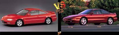

Did Ford make a factory v8 ranger for the public
It also had a trunk where the Probe had a rear hatch.

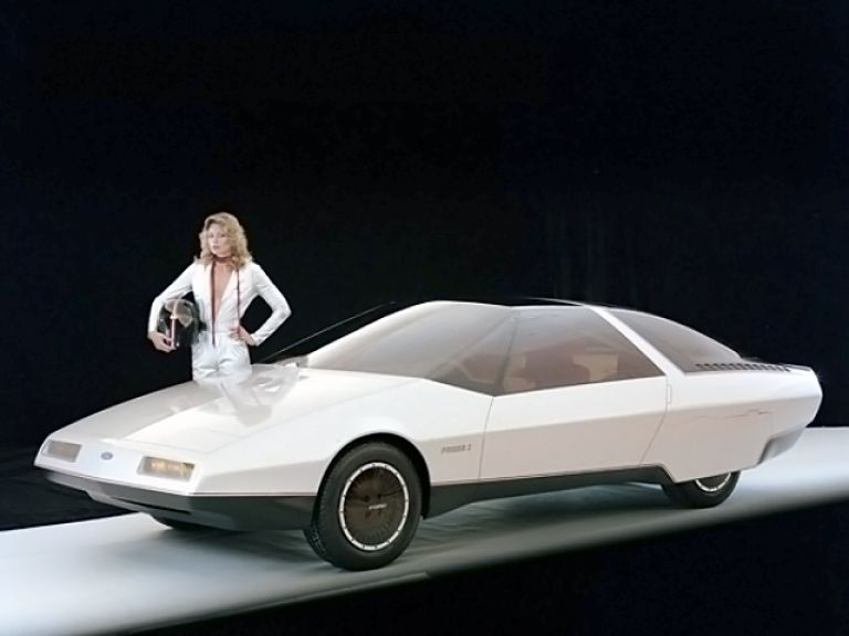

Also, who came up with the name "probe" and were they in the middle of a prostate exam at the time?
It was the name of a concept vehicle, from'79
