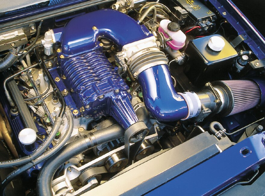

I still like the original 5.4L concept mule. Maybe it's the Sonic Blue?
0303MM_Mini05zoom
TECH INSPECTION
Vehicle:Ford Ranger Standard
Cab Color:Sonic Blue
Engine: {{{2002 F-150}}} Lighting 5.4L supercharged, 380 hp @ 4,750 rpm, 450 lb-ft torque @ 3,250 rpm
Transmission:4R100 automatic
Rear Axle:{{{F-150}}} Lightning 9.25-inches, narrowed 10.75 Inches, 3.73 gear
Wheels Front:Stock Lightning, narrowed to 8 inches
Wheels Rear:Stock Lightning, widened to 12.5 inches
Tires:Michelin Pilot, 235/40/18 front, 345/35/18 rear
Weight:3,800 pounds
Performance:13.6 @ 108 mph
Engine:{{{2002 F-150}}} Lighting 5.4L supercharged, 380 hp @ 4,750 rpm, 450 lb-ft torque @ 3,250 rpm
Weight:3,800 pounds
All that and it's not even a 12 second truck lol awful.
I once read an article about a "mule" Expedition with the "Lightning" treatment. Apparently ford let a few of the testers take it home as part of R&D. Of course it never happened, but a few years after that, one of the guys that drove it home had a daughter who turned 16, she told her dad to buy her one of those "Fast Black SUV's you brought home that one time"
Having to stop for a tire change halfway down the track hurts the times...
I don't know what they did or didn't do, the general consensus was the Lightning engine was too much for the Ranger chassis at the time.
People get Rangers to go faster with more power (a stock F-150 Coyote has more power now, a stock Mustang Coyote has almost over 100hp more) but they probably give up some streetability to do it.
And now you can get a 2.7L Bronco with 330hp from any Ford dealer...
