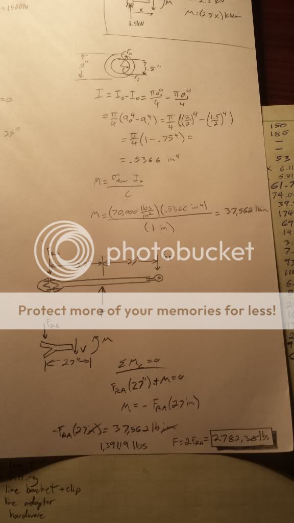

Also just for kicks I ran some quick numbers on max force my radius arms would take before bending, assuming they landed on a rock dead in the middle of them, and it came out to about 2800 lbs per side, assuming infinitely thin rock, static load, blah blah blah. Plenty to set my truck on them. Obviously landing my truck on them wouldn't be a static load, but I wasn't THAT board...
dhkonrad's 93 ford ranger
I also assumed the DOM to have a yield strength of 70ksi. That is what most companies quote for their DOM, but in my material science class, I took a piece of .5" 1020 DOM, threaded it, and turned it down in the center so I could do a tensile test with it. Yield came out to be about 100ksi, and UTS came out to be about 110ksi. I wouldn't trust those values for all DOM, but I thought that was kind of interesting. (in reference, 1020 HREW should have a tensile strength of about 30-40ksi iirc)

I can almost guarantee you the discrepancy you see between the absolute yield strength advertised and what you observed in lab is nice little safety factor to cover someone's ass

That's the same conclusion that I came to, but I still thought it was worth noting.
