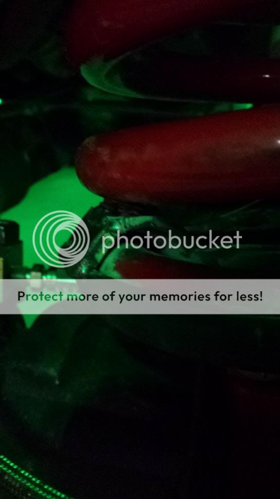

I was going to put them under the dash, so I'm not horribly worried about it affecting my night vision. At least I think I'm not worried about it... :dunno:

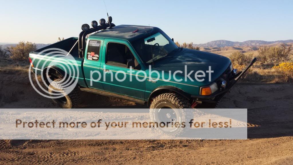

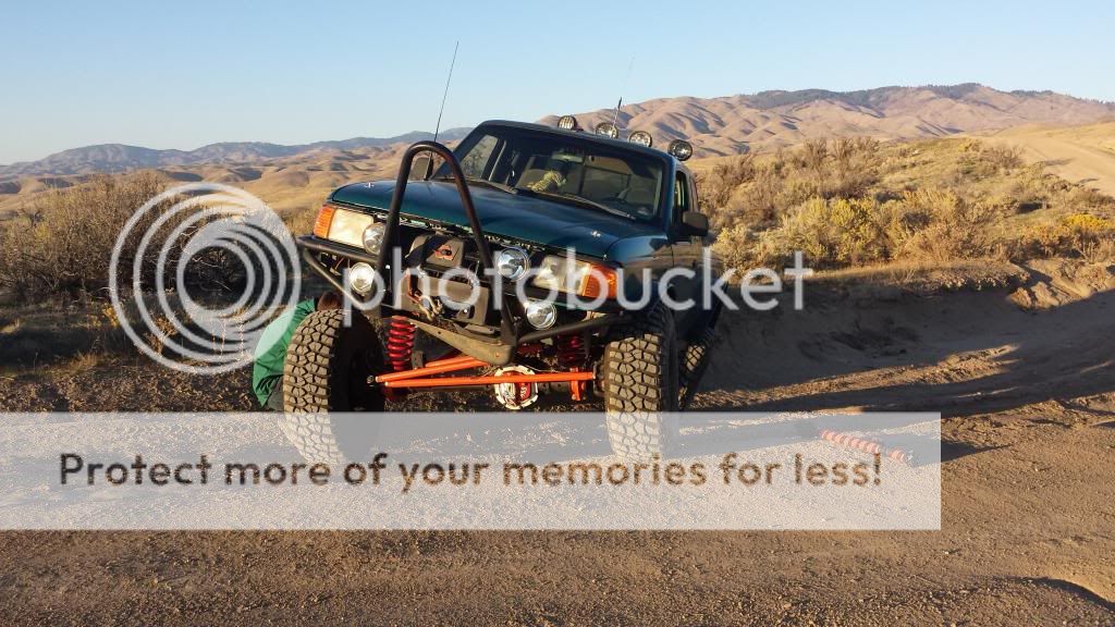

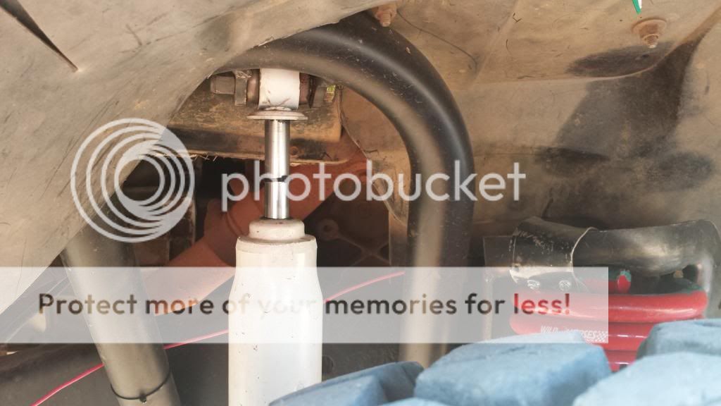

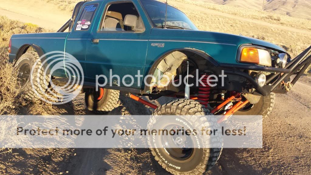

Went and found somewhere I could flex the truck out so I could measure for a driveshaft. Ends up looking like I am going to cut out 1.5" from the stock driveshaft. Odly enough it doesn't seem like the driveshaft will get much if any shorter/longer from full droop to full bump. I guess thats just based on where the radius arms are...
Some pic whoring:

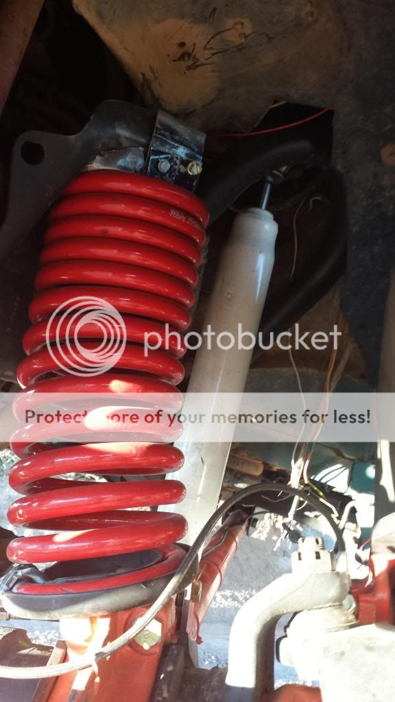

First one side;
dhkonrad's 93 ford ranger
and the shock compression:
you can see from the zip tie that it compressed a little more, but then when I took the picture it drooped a bit
and the other side:
as you can see, the shocks allow plenty of droop and bump. I am pretty satisfied with where the mounts ended up and the length of shock I used, seeing as how it was semi last minute and I just more or less eyeballed it...

It's awesome to see it flexed out in the dirt! It's really looking good.
You should really have it flexed to the point of lifting the opposite tire, with as much weight as you can transfer to the stuffed corner, to really check travel. That's where a forklift or skidloader come in handy. I bet there is quite a bit more articulation in your front, depending on what PPI your coils are. Mine flexes a little less than where yours is in the pic, with stock arms and polyurethane bushings.
Oh, and on a side note. You should really plate those lower spring cups, your fixing to bend them if you haven't already. I just traced them onto 3/16 plate, cut them out and welded the plate to the bottom of the cups. Drilled through the 2 holes, and bolted them back on with the original bolts.

I totally agree, but because I am at school, this was pretty much all I had access to. I think I do have a bit more articulation in the front, but, by my measurements, my driveshaft doesn't seem like itll get much if any shorter at compression or longer at droop, so I should be ok for now. I would like to see how much it'll give me though. As far as I can tell, it seems like I would be able to get away with shortening the driveshaft only .75 inches, so I went with 1.5 to be safe. Maybe more like 1.6-1.75"?
