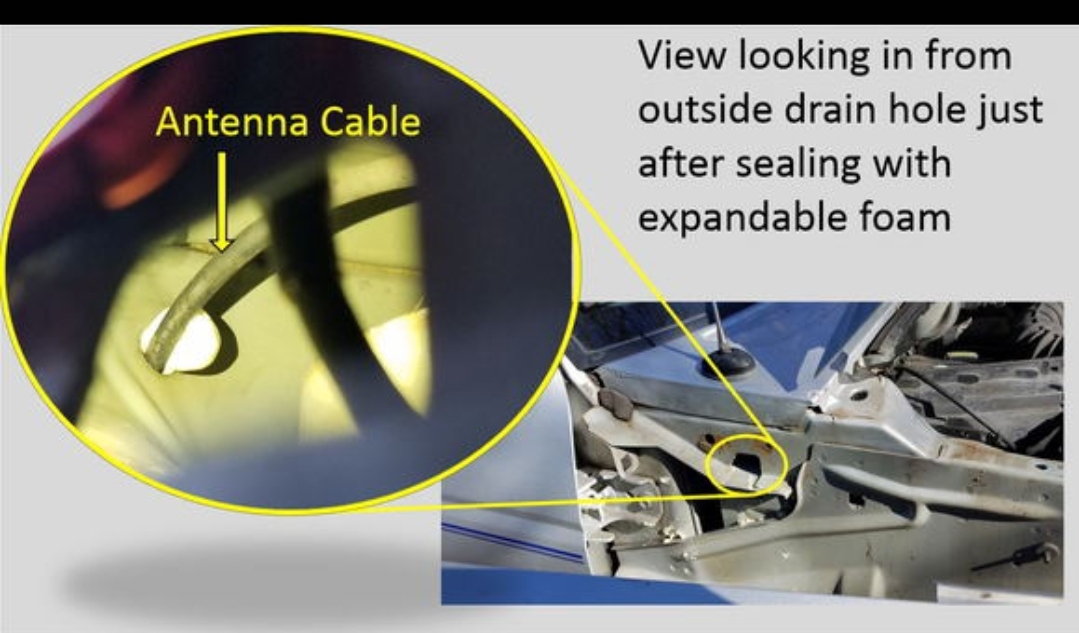

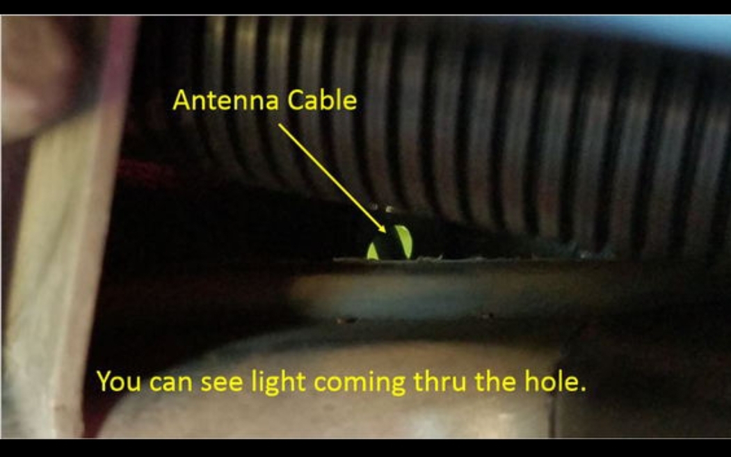

I found this also doing a Google search.
I'll check that drain, shown in photo.
