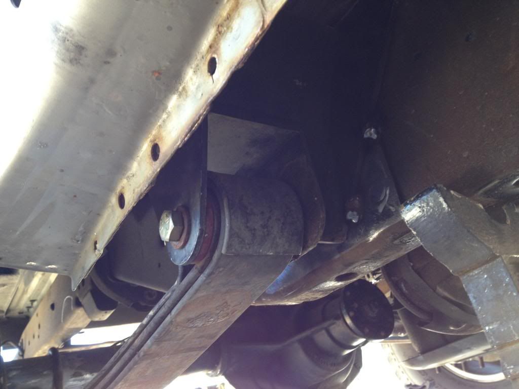

Using the Giant (Ranger) front spring hanger. The top half of the hanger is cut off to allow for placement. There is enough offset between the frame and the hanger to allow for a nut on the back side of the hanger.

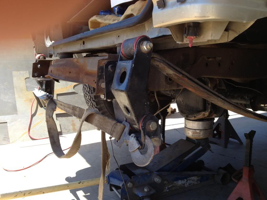

Using the Giant (Ranger) drop shackle mounts. Located near the end of the Explorer frame. Note the spacer placed under the frame to allow the shackle to clear the hatch:

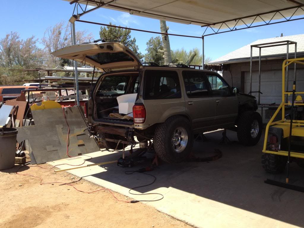

Getting ready to cut sheet metal (should begin tomorrow). At this point, we still have 3"-4" of bump travel before we hit the frame and an estimated 6" before the leafs flatten out. We will likely notch the frame a couple of inches to increase bump travel. How much will be determined once we trim the body.
