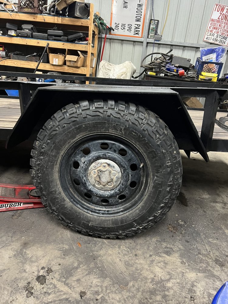

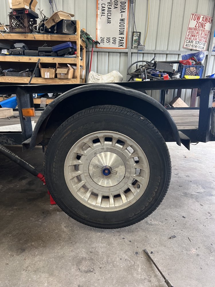

Finished up the other fender today, so pumped how these turned out. Gotta do some minor repairs to the tailgate, then come up with a way to drive a quad up on the front railing easier so two fit nuts to butts with the tailgate closed.

yeah......something got fawked up worse then the trailer....:LOL:

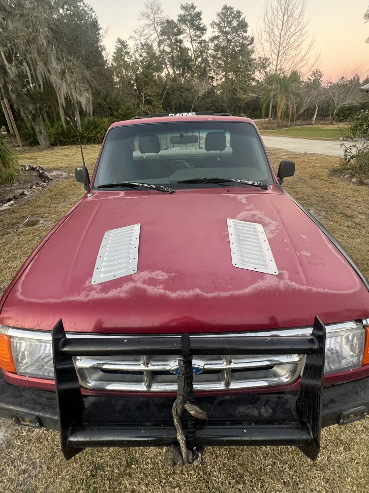

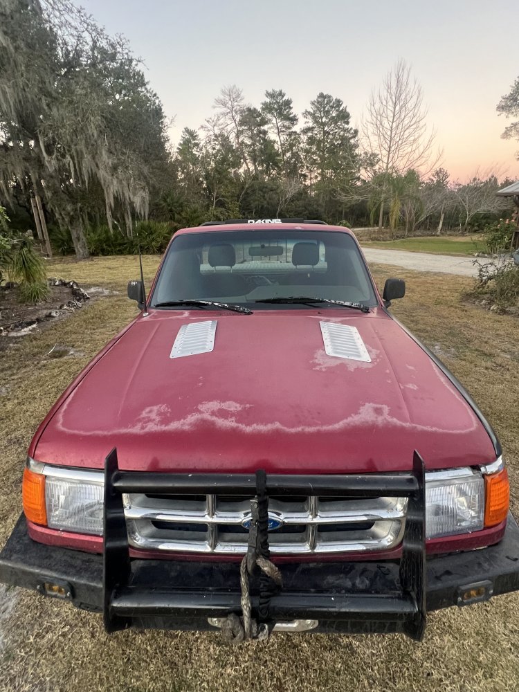

Been wanting to do hood louvers for awhile, and since this thing oddly gets warm during long highway sessions I figure it can’t hurt. However these do not look good anywhere so they are being returned, and the larger one in the last picture is on order.
Anyone have good louvers that fit the 93-97 hood well?
Dans 94, RCSB, 4.0, 4x4, 5spd
In the 1st 2 pics, the louvers are on the wrong sides of the hood.
Not sure how to explain it, but IMO the angles would look better if angled away from the center.
You probably tried that orientation and didnt take a pic.
Ah I gotcha, yeah I think I would have preferred flat ends and 90* corners as opposed to the angles. Should have looked harder at the pictures.

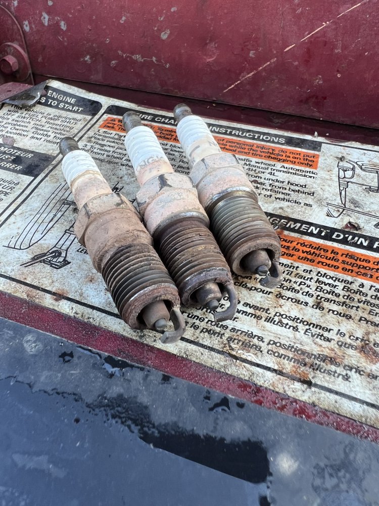

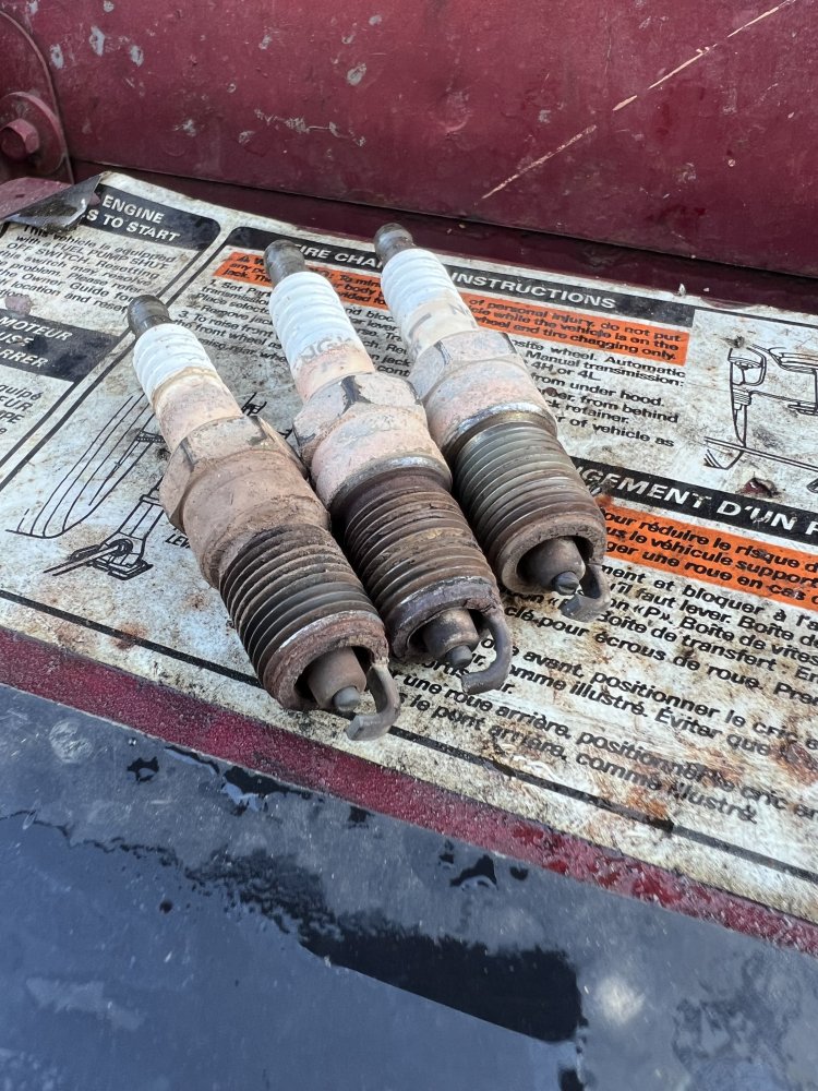

Unfortunately after driving it today I think the heads/gaskets are bad. Previously it only ever got warm after sustained highway towing. Which tbh is more than I expect a 30y/o mini truck to be good at. However today I let it warm up for 10 minutes because it was 37* and it did fine, until I got in the road to work cruising at 40-50mph for 5-10min. It got to the plant letter in normal very quickly for the first time ever. When I pulled in to work I noticed it almost immediately started dropping while at idle. So my sssumption is less cylinder pressure at idle and it’s fine but 2k rpm sustained is blowing compression into the coolant.
I didn’t do the glove test but that is pretty neat! Never heard of that, I might do a compression or leakdown test one of these days but I think I’m actually in the clear and instead just an idiot.
So first thing I did was check coolant, about a gallon low.
Second thing I did was place a bleeding funnel in radiator and watch for compression bubbles, none.

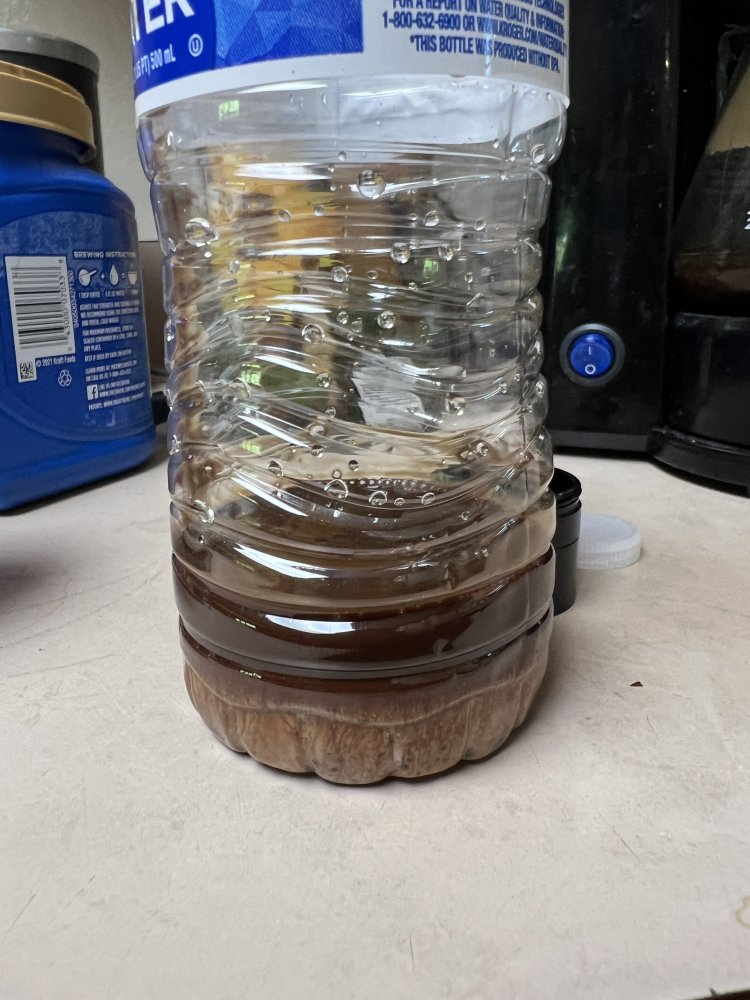

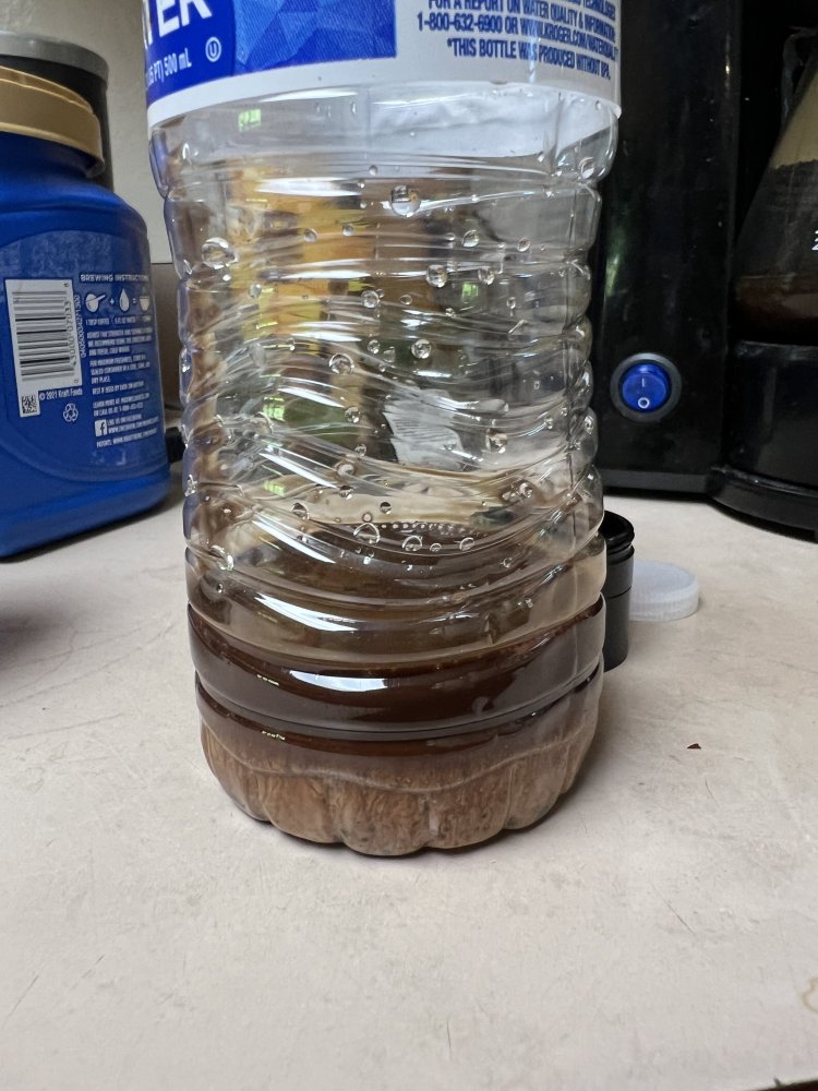

Third thing was check catch can, I forgot to empty it during the oil change a few days ago anyway. It had more oil than expected but not trace of coolant. Neither did the oil during the oil change.

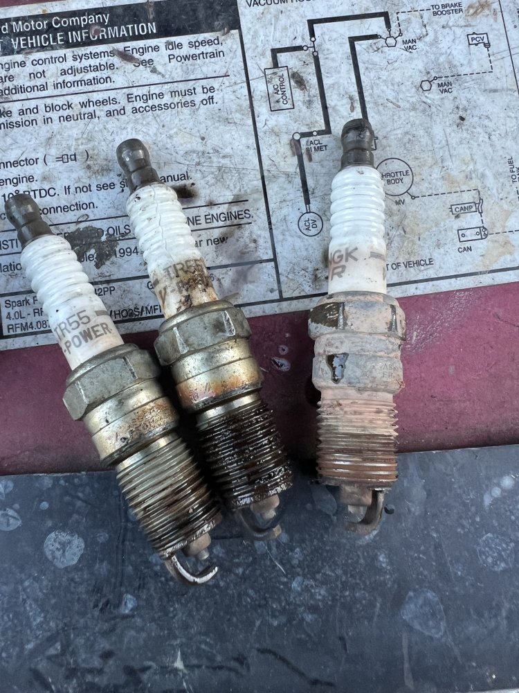

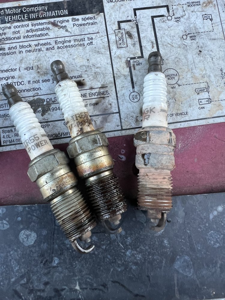

Forth thing I did was pull plugs all which were much dirtier than expected, but in this case dirty is kinda a good thing.
Then I turned the electric fan on and started jiggling everything to make it turn off, since I actually just cleaned up the wiring the same day as the oil change. Nothing seemed to make it stop but I did notice that despite sounding loud, I didn’t feel any real airflow in the engine bay. I had the plug backwards and the fan was trying to push hot air from the engine bay against the cool are trying to come in through the grill. Silly me, but the plug I had used was some cheap non directional plug I had laying around. I replaced it now with one that has a locking tab preventing backwards insertion and I believe I’ll be good to go when new spark plugs arrive tomorrow.
