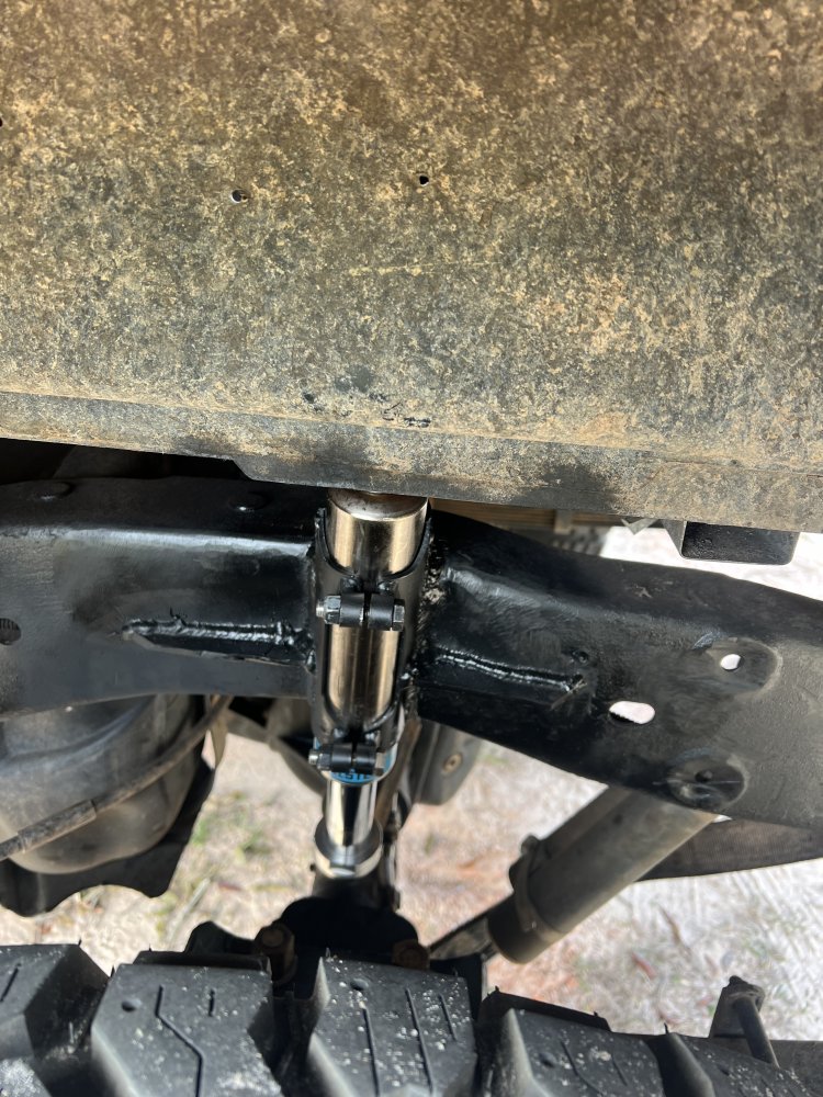

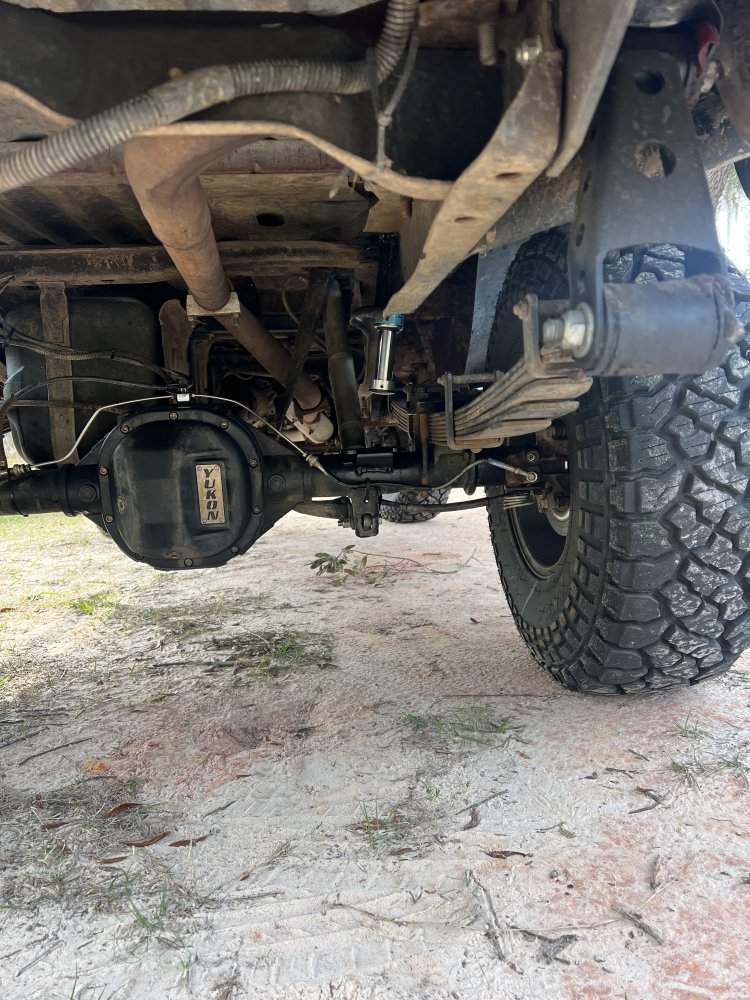

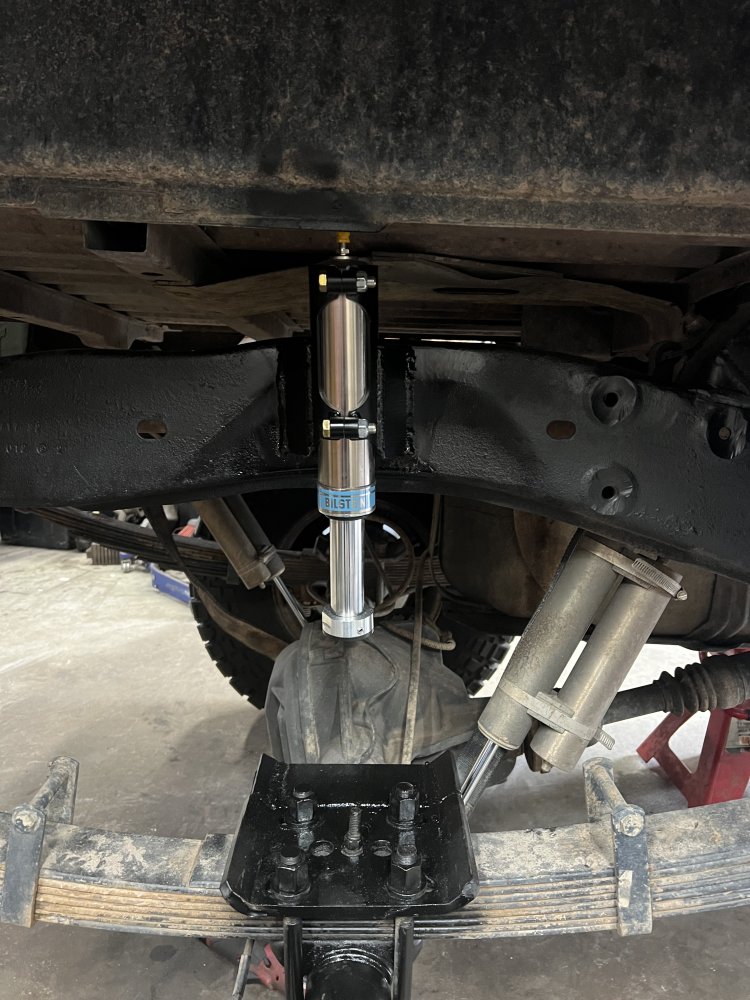

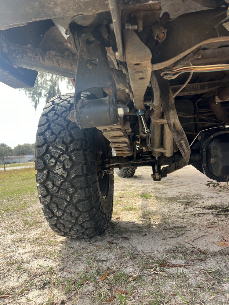

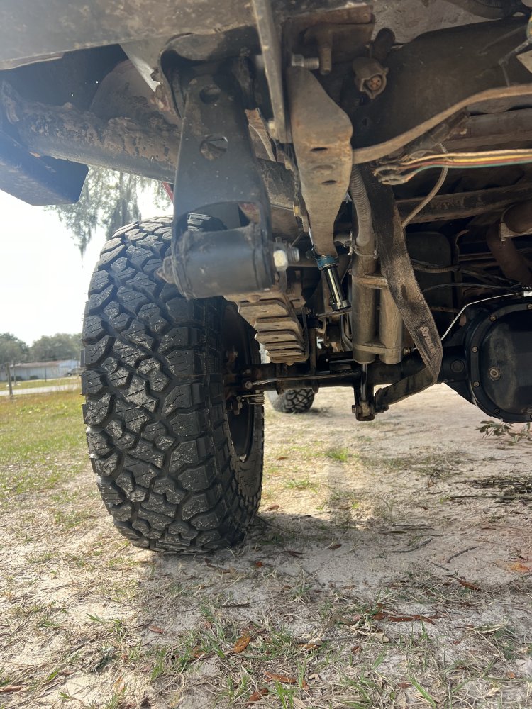

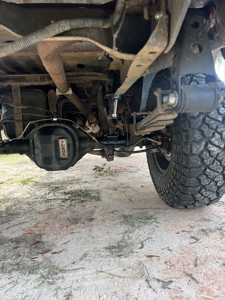

Anyway o to the next thing which was bump stops for the rear! This is my first time ever handling let alone setting up hydro bumps so I figured the rear would be the easiest to start with. Picked these 4” Bilsteins awhile back and figured I could always lower pressure if the 4” stroke was too much.
I think I got them set in fairly well, the only way I could raise them would be punch holes in the bed which I’m not opposed to. I have long thought of hacking up the bed and doing a proper bed cage and have the 7100s standing up instead of at an angle, but enough with that talk. I got the bumps in the best I could without really hacking up the frame to set them in further, they sit at a slight angle with the bottom pointing towards the diff so that it clears the U-bolt plate and nuts. Not wanting to weld some bump pads to the axle because I’m dumb, I built these U-bolt plate extensions that act as a bump pad. Everything’s great except during testing I realized the bump is engaging wayyyyyy too quick. Not sure how exactly I got my ride height estimation wrong but I only have about an inch or so of up travel until the bumps right now and that’s not gonna do.
Got a box full of stuff coming from Barnes 4wd including bump pads, axle tiedown tabs, and some other junk. Once it comes in I’ll re tackle them.

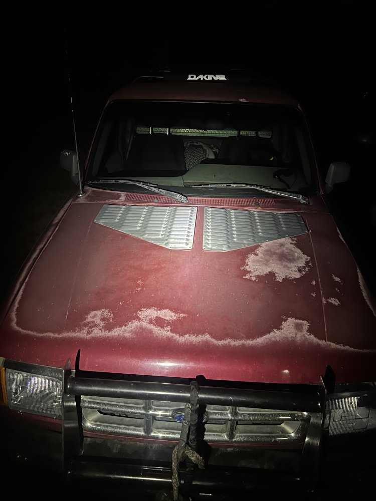

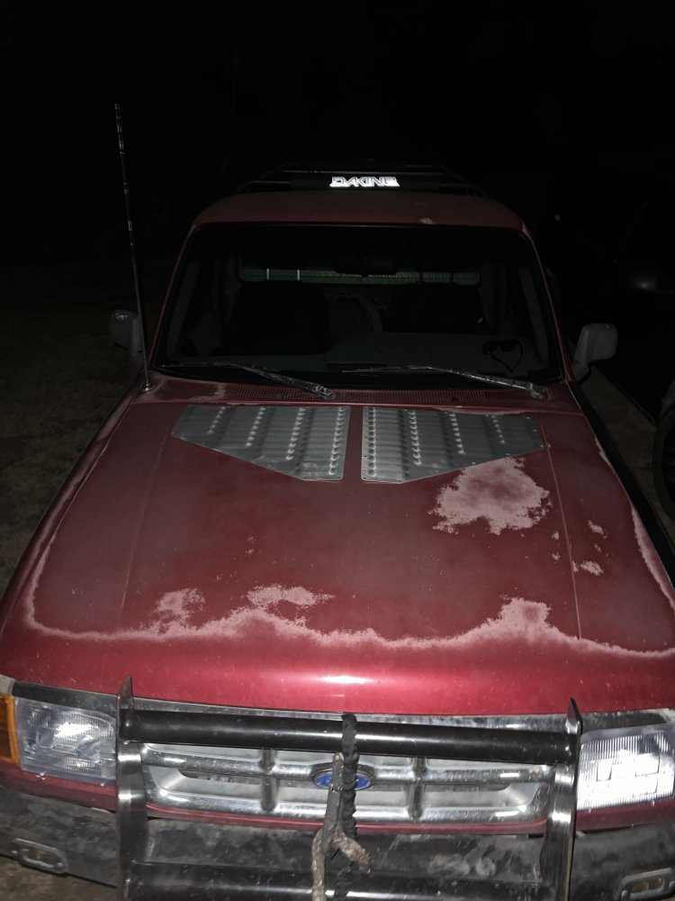

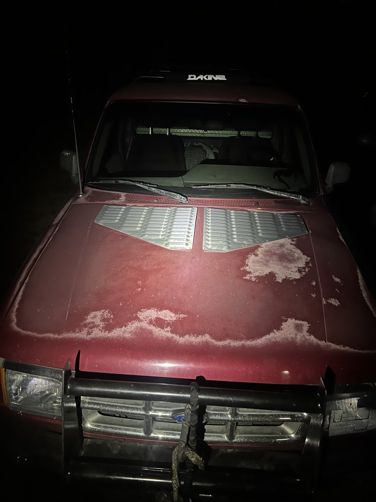

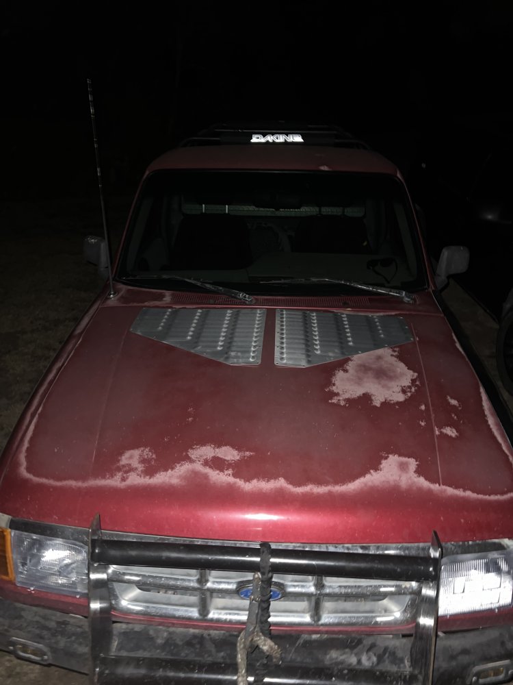

New louvers arrived after dark, I think these look alright and will work well. Not sure if I should leave the bare AL or powder satin black?
It depends on where in Florida you are at and how much salt is in the air. Aluminum likes salt less than steel does. At minimum, you might want to clear coat them.
Alright I scrapped the louvre idea, none of them match the underside of the hoods support well and I don’t want a crinkly hood.

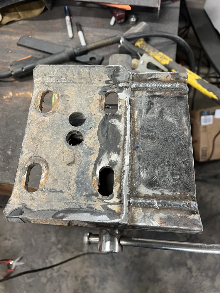

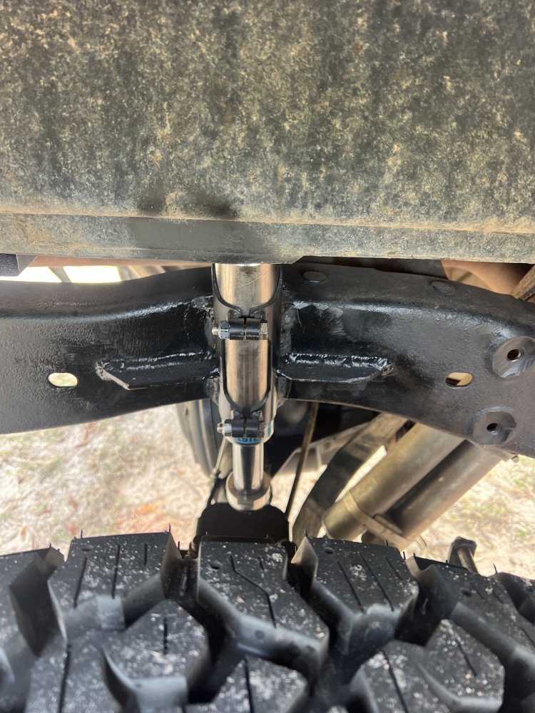

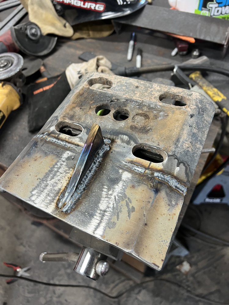

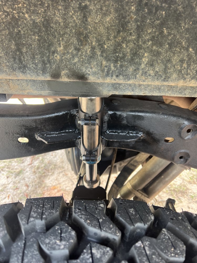

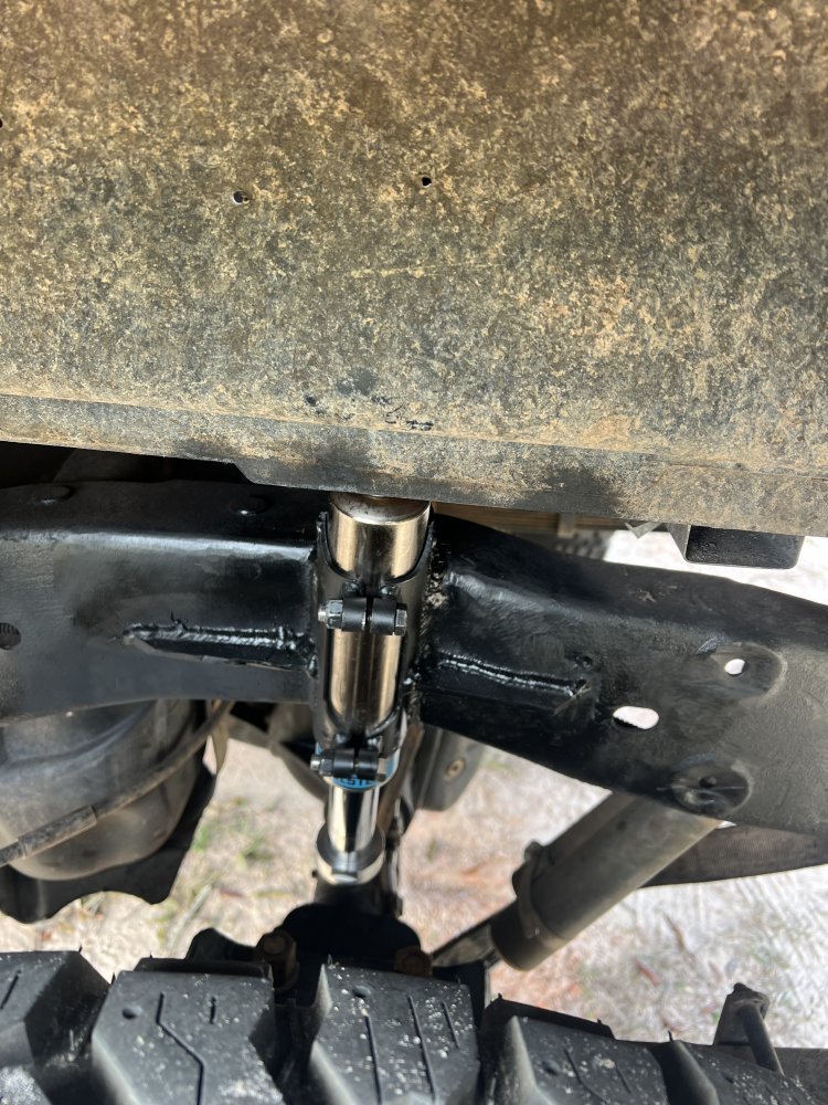

I did decide to cut the frame in half on both sides and French the bump stops in tho. It allowed me to move them more inboard and contact the bump pads I welded to the tubes, without hitting the side of the leaf pack, while also allowing much more uptravel before the bumps engaged.

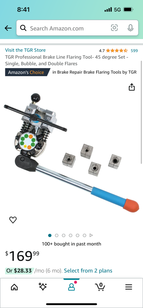

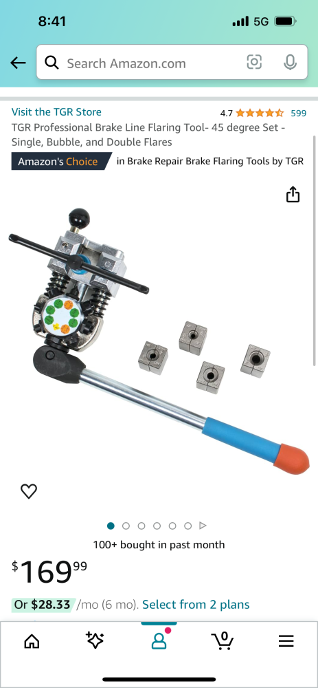

Also got mad and threw all my brake line flare tools in the trash and then ended up buying one of these which works so far superior to the rigid and HF models I had before. I was able to clean up the rear brake line fitment so the flex hose off the caliper wasn’t hanging way below the axle tubes because it was too long.

No pictures but I took a couple laps down my local sandy road. The bumps are positioned very well however I need to get a good nitrogen fill/gauge setup so I can start tuning pressures. My goal was always to have a long bump in the rear and lower pressure to almost act as a second shock stage and bump in one. In this test run the little o ring on the shaft only slid down about 1/4-1/2” which means it’s barely using the bumps. Which is to be expected as I didn’t exactly catch air or hit any huge whoop sections.

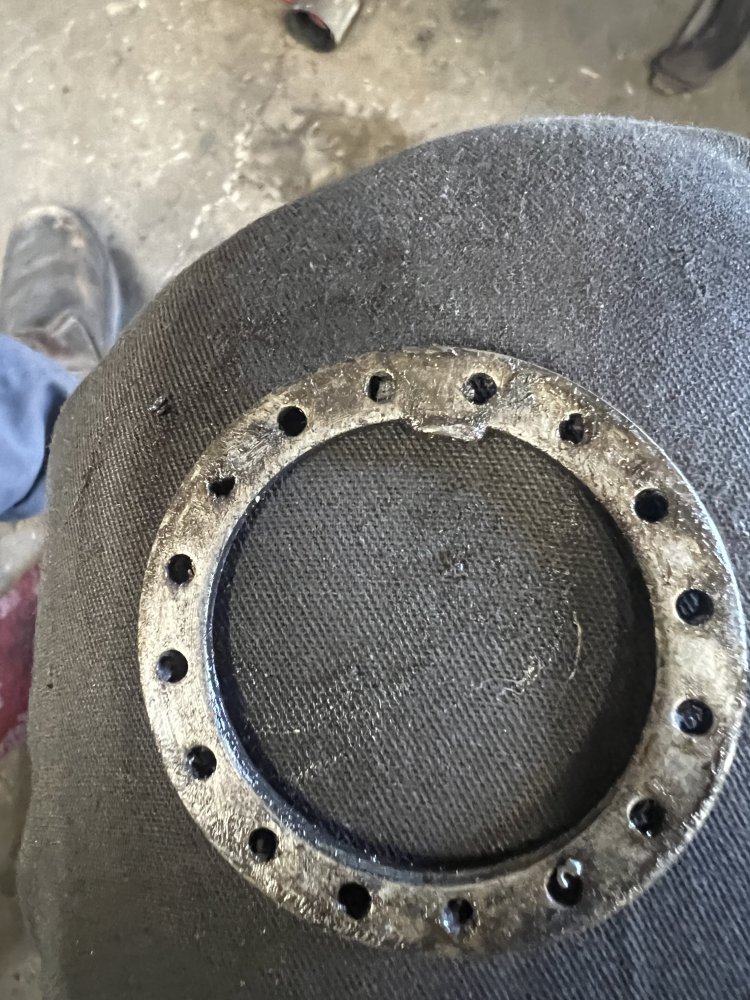

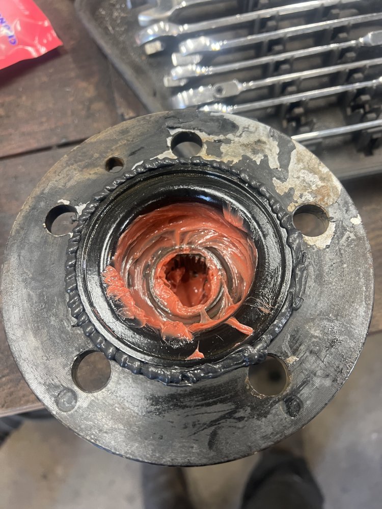

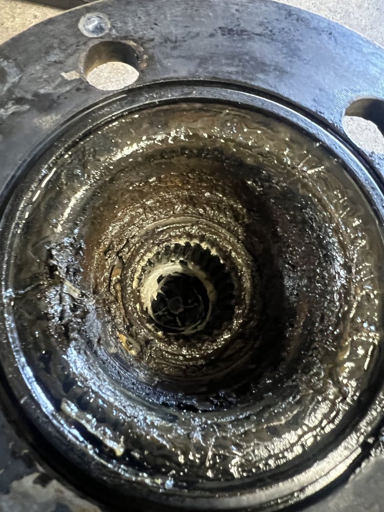

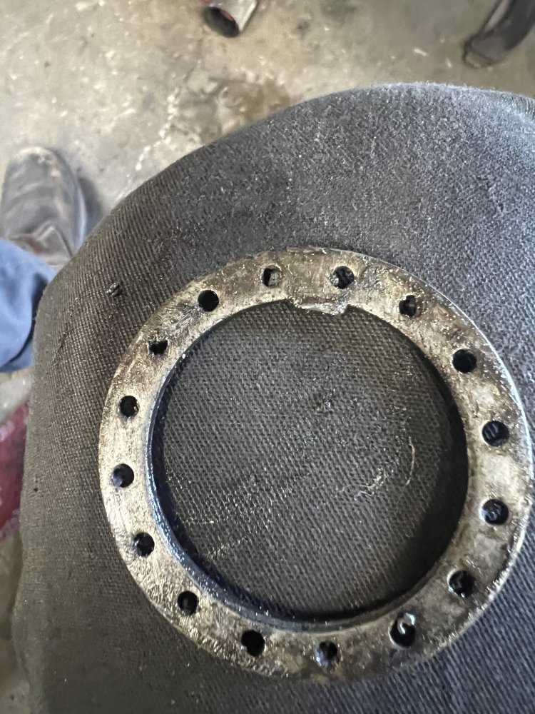

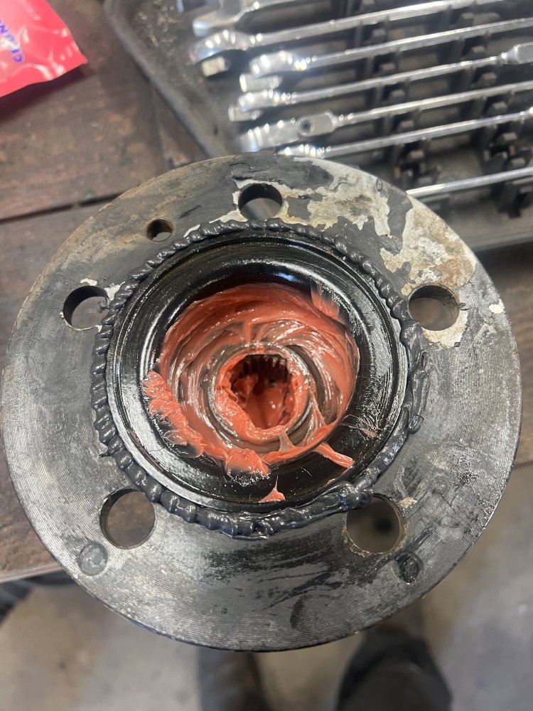

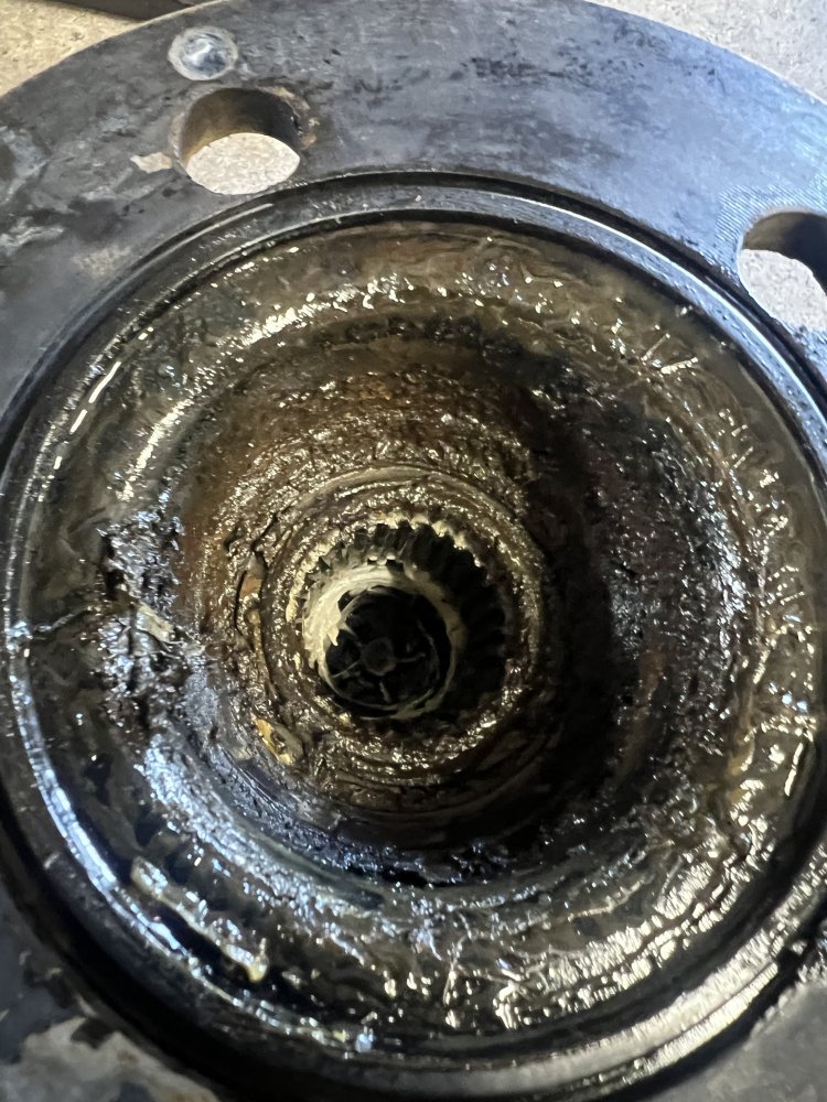

Man these wheel bearings/lock nut system are aggravating. I decided to pull the bearings to inspect since last night I submerged them for extended periods of time and many many times. I found the locking hub seal failed and filled with sandy water, but none seems to have made it to the bearings.
Upon reinstalling I had one of the locking tab washer jump the spindle grove and upon removing it, it sheared the stupid pin in the bearing nut. So I grabbed my spare and it also jumped the spindle groove. I want to disclaimer this was just using hand tools, a 12” long 1/2” ratchet was all I was using to torque down the other nut when these jumped the spindle.
I think I’m gonna order the stuff to do this overkill mod from the tech section. Also gonna use rtv from now on to seal the hubs to the rotor.
