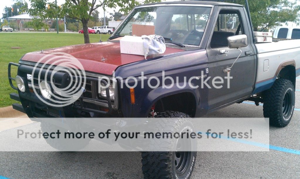

Where it rested at first the got towed from.

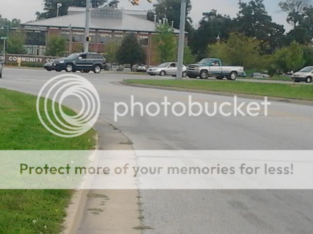

Another shot...it's hard to stop with oil all over your front tire.

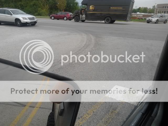

Two miles later at her place and after a small oil fire.

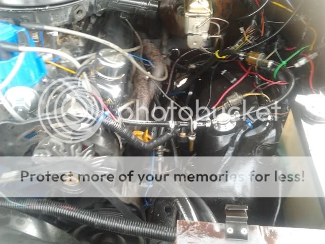

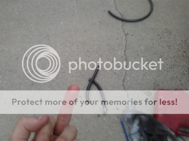

Ten minutes later for the old out and me pointing at the bad setup to ask of you.

That is one reason I switch FEAD's, it was really hard to get the oil lines ran so they wouldn't interfer with anything.
I actually had them come out the bottom and then up ziptied to the radiator hose at the end.
I never did have one break on me though.
It was my fault that it hit the belt from the beginning. What was worse I didn't replace the line when it happened, I just bandaided it. Everything is zip tied out of the way now.

The line that blew at the joint due to a cut a month ago and was fixed was the oil filter relocation line coming out of the block, not my power steering line. I ran zero oil pressure twice but got the engine turned off quick.

i kept the cheap hose oil re locator lines for years till i made 5000 psi ones.
i actually crushed one this year when my filter mount got smased off.
so....ya just never know.:dunno:
I learned not to use a double barb connector for something like this, it could have turned out worse and also not a plastic one that will crush due to the pressure of the hose clamps on it. You live you learn I guess.

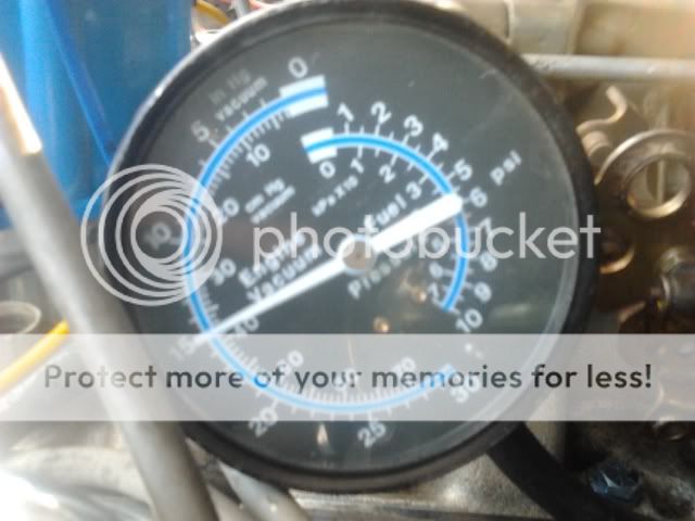

Found the vacuum guage so I set the mixture screws to the highest vacuum that I could get, which is 15. Also when I went too hook the vacuum guage up to the vacuum tree, there was a vacuum cap missing. that would explain why it wouldnt idle so great until warmed up and the tempermental idle that it had, as in sometimes it would sometimes it wouldnt.

Is the needle holding still on the vac gauge or is it bouncing? It looks a lil blurry like it was bouncing or shaking when you took the pic. If i'ts shaking then you still have a vac leak some where.
