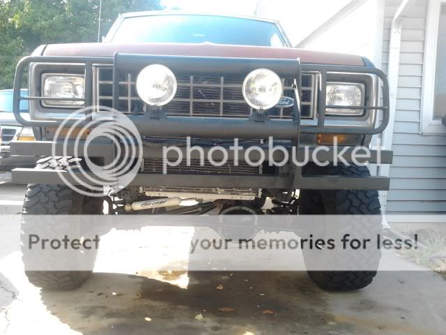

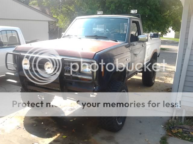

Got the front all back together. Dont have the fog lights wired up yet, had to use the relay for something else. Visually, nothing screams at you that it has had a v8 swap done to it.
The bottom of the rad actually doesnt hang to far below the bumper, but I will still make a guard of some kind for it.
