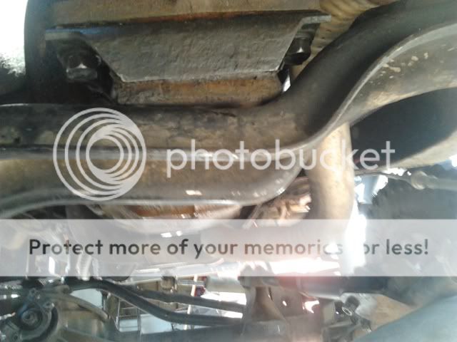

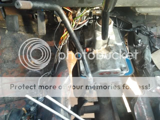

Got more of the exhaust done, got heater hoses done, moded my shifter by cutting it 3/4 of the way through, bending it then welding on the cut line. Now I can shift into 2HI. Also got some of the front end back on.

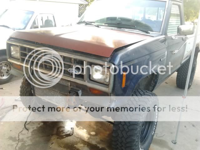

You better make some kind of skid plate for that radiator.
Sent from my PC36100 using Tapatalk 2
Every intent on making a guard for it that still allows for air to get to the radiator. I need to get some ideas for it.
What are you going to do about the huge hole in the floor????
Robert
posted using the power of the almighty T.V.
Simple. Grab a large peice of sheet metal, cut to fit over the hole, use weather striping to seal statist the floor and to hold it down I will get some clip nuts and screws.
I should have plenty of space for cup holders now or even a center console if I do get rid if the center seat.
Back when I was playing a 5.0 Ex fan shroud I was marvelling that on my truck roughly where I guessed the bottom of the rad would be was flush with the bottom of my frame because of the bodylift.
Otherwise something heavy to wrap around the bottom of the rad would be about it. Expanded metal in the front of it might be good for flying rocks and bugs.
In case of mechanical failure you scooch over to the middle and flintstone it. :D
Are you using the split bench seat??!!??
If so there should be a console under it, at least every one else that has did the cut and tuck on the split seat has found one under it.:icon_rofl:

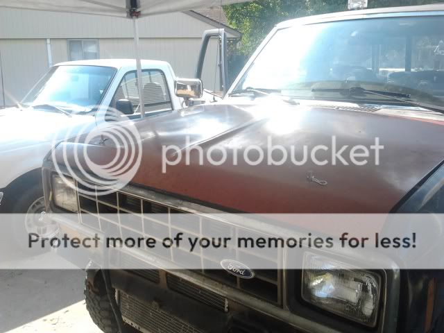

Got hood pins installed. I just have to adjust the height on the driverside one.
