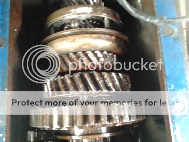

Okay took the top off and this is how the gears are. Looks to be double enguaged in gears and isnt going into netural from what the picture says.
So Im going to manually put it all back in netrual and try again.
Btw what gears is it in?
I'm not sure what gears are engaged maybe some one else can help ya with that?! Look at the shifter forks and where they sit in each gear as if you had shifted it then compare it to where the gears are in the trans. It can't be too difficult but I'm no trans guru lol.
Okay got the trans top back on and for the first time with the engine off, I can shift through all of the gears so I think I got it now. Tomorrow hopefully start on the passeger side exhaust that comes off the passenger side header, already had one for the driverside. I measuered

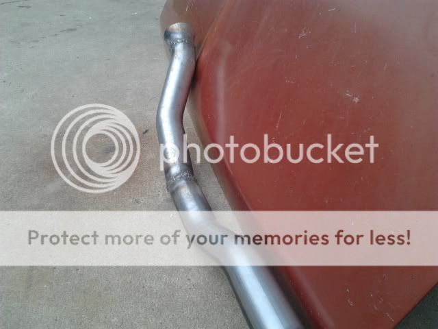

Made the exhaust piping from the header for the passenger side. Have to mod the flange bolt holes to be able to bolt it up to the header next.
