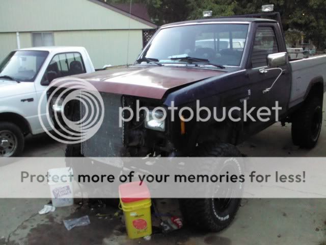

Here's a picture of how she sits now. I'll get a better video of how it runs tomorrow with my internet tablet, my phone doesn't do such a good job.
Sent from my A500 using Tapatalk 2
Dang that radiator is huge!
