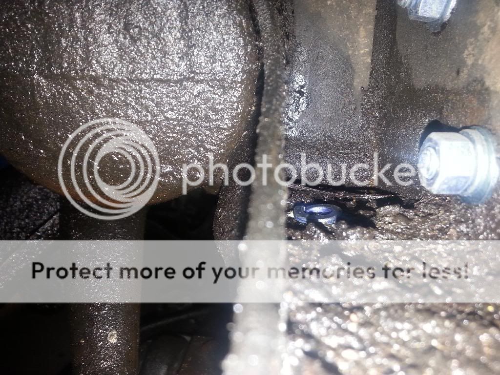

Because the frame is boxed in at the steering box where it mounts to the frame, makes it hard to get a bolt and nut in there.

Drill the holes then tap them. I used self tapping 7/16 bolts. They eve held up without a hint of a issue and haven't came loose once July.
Problem is getting a drill up and in to the tight space to get a hole drilled.
So I figured the easiest way is probably to take the mount off the truck and drill a couple of holes in the lower part of the mount and a couple in the frame, making sure they are going to line up. Super glue can hold a nut in the wrench to get into the boxed area of the frame, so long as I'm not getting in the way of the steering box bolts.

Got the welder assembled and played with it then went and took a look at my track bar mount for the frame and was seeing how I can bolt it to the bottom of it. Turns out, kind figured this anyways, that it is completely boxed in there so what I'm going to do is what one guy did on here is put some self tapping bolts or tap the bolt holes I'm going to put there since I can't get into the boxed section to put a nut on. Plus I will be putting bolts in front of the boxed area and I can get a wrench and my fingers in there.

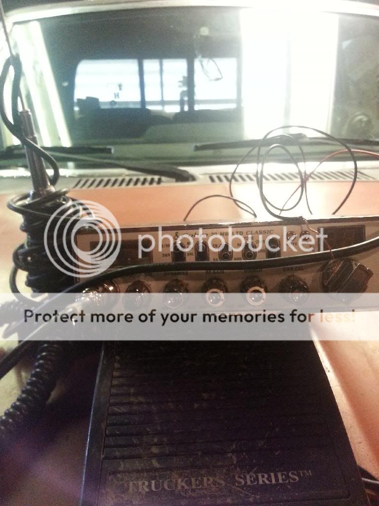

Got a goodie for the truck.
Sent from my SPH-L710 using Tapatalk
CBS are great to have! When you're in the mountains or out of town where there's no cell service they're worth their weight in gold. Marine radios are 10X better but they cost more lol.
I'll be happy to get it mounted in the truck somewhere, probably under the glove box since my shifter comes up right under the dash where most people mount them in these trucks.
