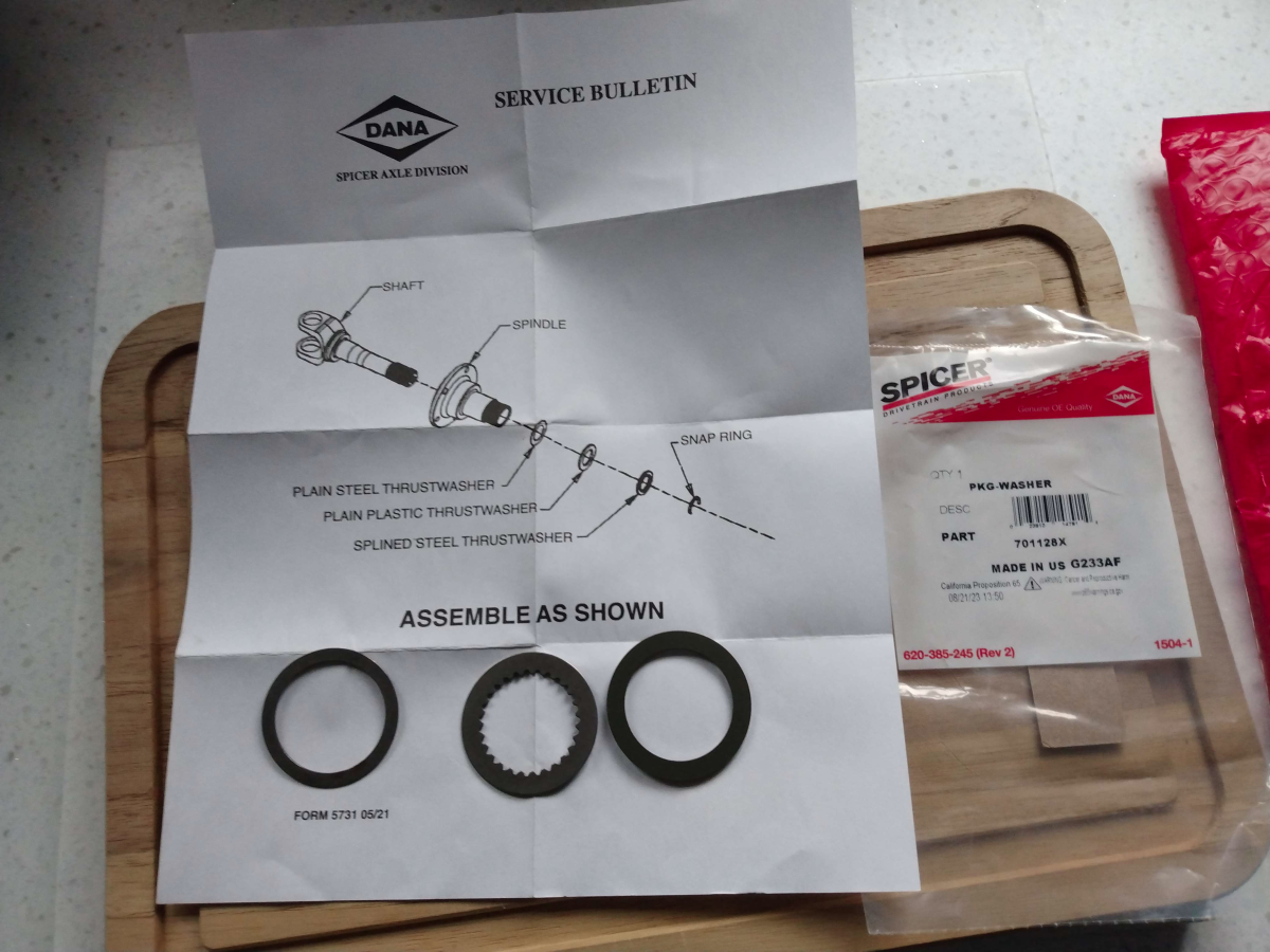

Hello everyone I just wanted to write a quick note about the exploded Dana 35 TTB diagram in the library. Part 61 is Dana 42773 Spacer.
This part is obsolete and has been replaced with Dana 701128X. I see now after hours of research and looking elsewhere that I didn't know how to read the document, but I think this may be useful to many ranger owners here.
Worst case this picture shows how the new part goes together if the previous owner already repaired the hub.
