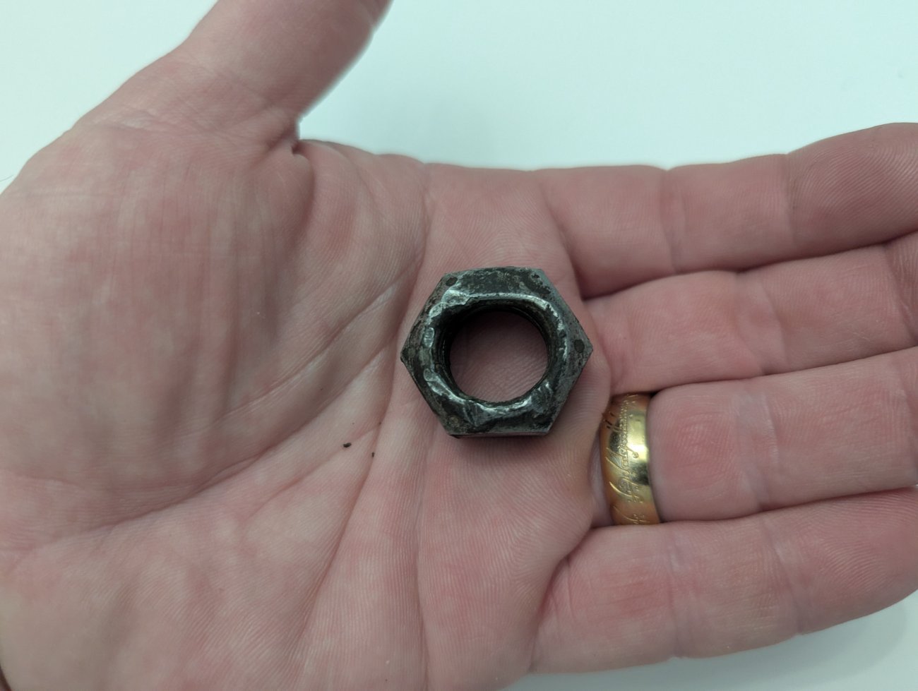

Check out how oval'd out the nut was from this lower ball joint 😱. Also, half the snap ring was missing.
This couldn't have been good for my tires.

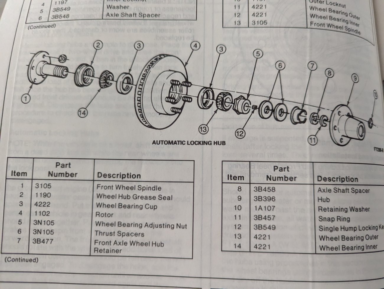

So I'm checking the FSM to find a part number for the thrust spacers and noticed this in the part list for the diagram:
#5 and #6 have the same part number. Is that one of those Ford parts numbering deals or does that imply something else?
That’s… odd… wonder if it’s sold as a set and that’s why or a misprint or something.
I wonder if anyone with auto hubs could give specs on the thrust spacers (material, dimensions)?

I'm going to reinstall the auto-hubs sans thrust spacers until the manuals arrive. Probably going to do a little testing of the auto 4x4 system just to see if it will engage or not. My original test of the auto-hubs a few months ago they worked, but were pretty sticky and it took a bit to get the front DS to disengage. maybe they'll be 'better' now (not holding my breath).
I'm also going to order a manual hub conversion kit from eBay. They're cheap and the only reason i would need to use 4x4 would be snow or the occasional beach trip.
my ultimate findings regarding the 2 thrust spacers were inconclusive:
- i watched every ranger auto-hub removal YT video i could find and none of them had any thrust spacers behind the cam assembly.
- internet searches revealed a number of other folks with the exact same question and no real answer
- using the ford part# from the FSM revealed no hint at a replacement part, aftermarket or not

Maybe that’s why the thrust spacers usually aren’t there? Like I said, I haven’t messed with auto hubs in forever though.
