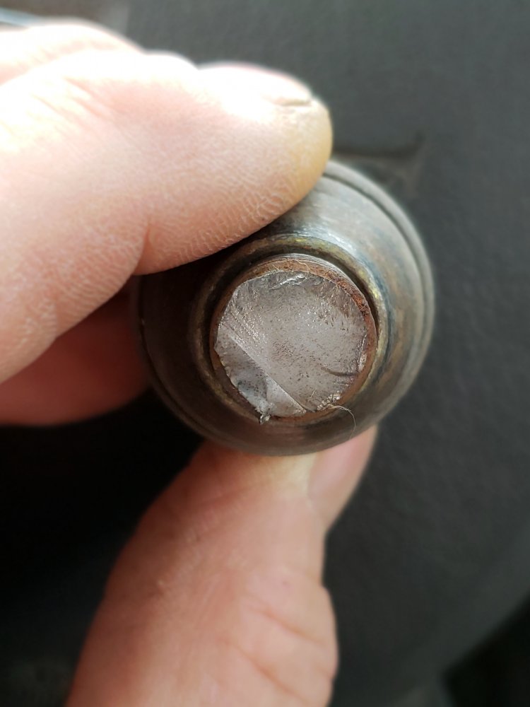

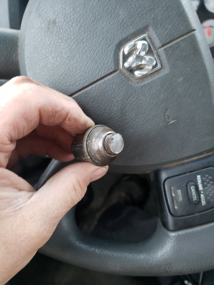

I swapped winter tires onto my work truck, a 2006 Dodge Ram 1500. I torqued the nuts to 110psi to start, and was going to finish at 135 as stated in the book. Sheared off a lug at 110! Not sure how that happens? Perhaps someone previously over tightened it. Now i have to fix the damn thing...and the snow finally started sticking a couple days ago and i have no shelter to work in. Woah is me...lol.

I swapped winter tires onto my work truck, a 2006 Dodge Ram 1500. I torqued the nuts to 110psi to start, and was going to finish at 135 as stated in the book. Sheared off a lug at 110! Not sure how that happens? Perhaps someone previously over tightened it. Now i have to fix the damn thing...and the snow finally started sticking a couple days ago and i have no shelter to work in. Woah is me...lol.View attachment 68932
That looks like an awful small diameter stud to hold 135 ft/lbs. Are you sure it's right?
Stock lug and i looked in the owners manual for the torque specs....

If you can and care to, post a clearer picture of that fracture face. Before retirement one of my jobs was doing failure analysis of bolts, and if I had a better look at the face I could maybe tell if it was a single overload fracture or the result of a crack that had been slowly growing and finally gave way when you were tightening.
PS, you said you torqued to 110psi, but that is a pressure not a torque - unless you are running 110psi into your pneumatic impact wrench ;)
Psi...oops...lol.
Ill try to get a better pic tomorrow. But there was no sign of rust that i would expect to see with a crack.

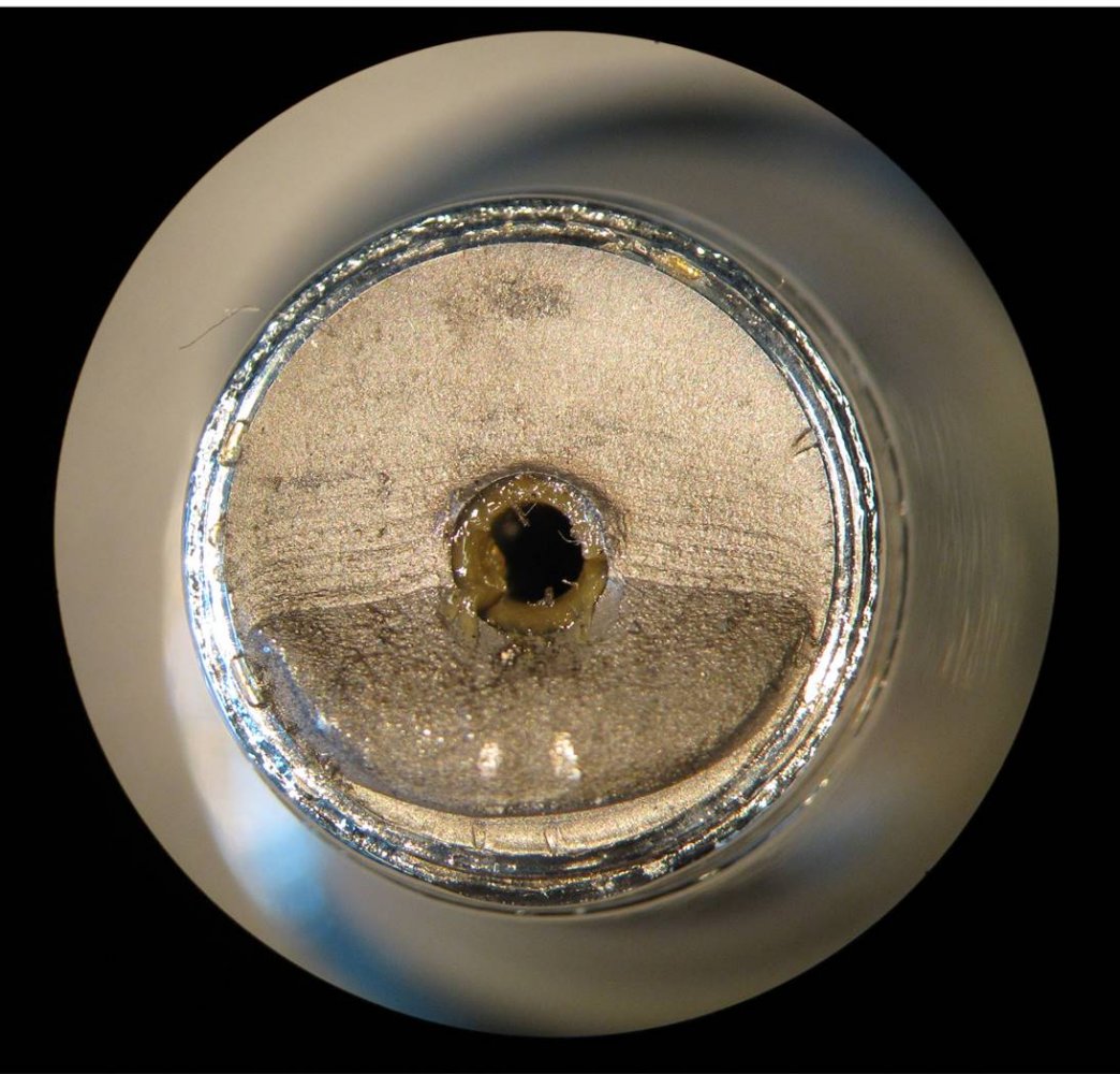

Yeah, rust is one of the things you see if there was slow growth, especially with carbon steel. The other thing you look for is a flat surface that has beach marks typical of fatigue. Here is a bike pedal that started cracking due to fatigue and finally failed due to overload, launching the rider and breaking his collar bone (thankfully not me). Take a look at the attached picture, the lighter surface is the fatigue crack, and you can see the beach marks as the crack started growing faster. The dark area was the meat holding the part together till it let go real fast.
Yep, i see the beach marks.
