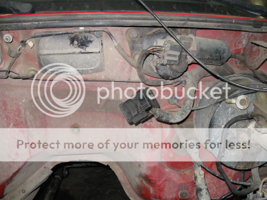

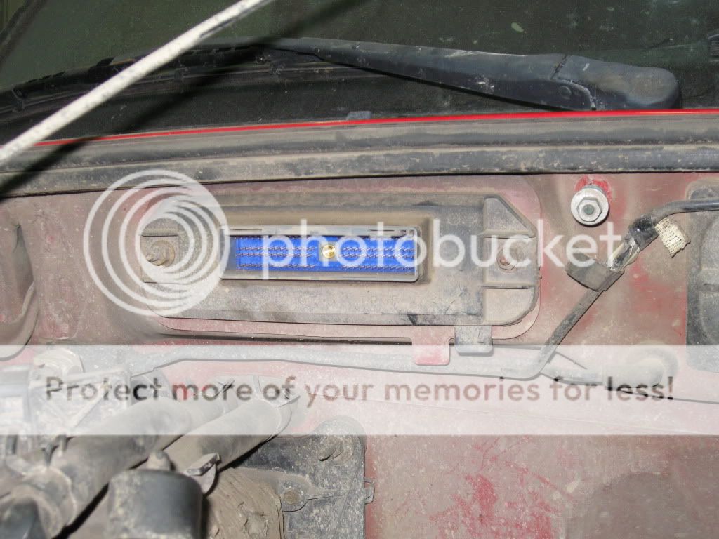

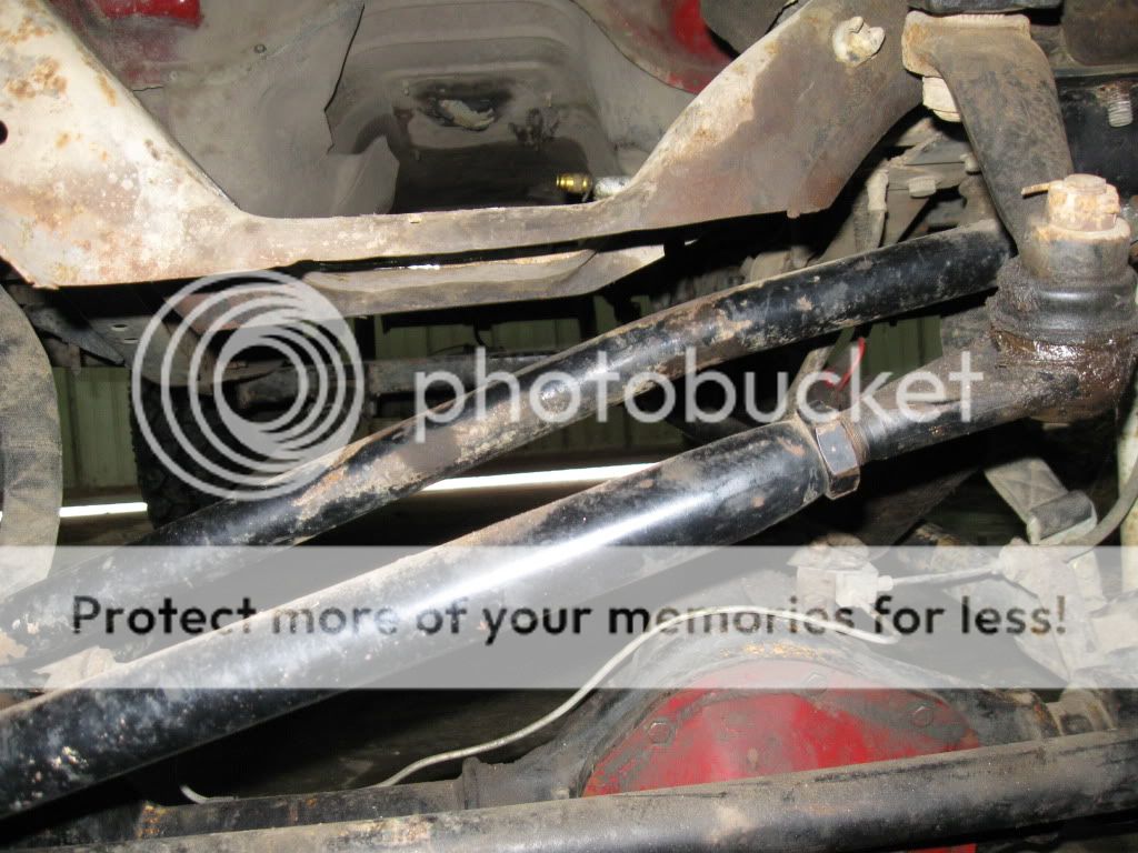

Here's the pics of the two plugs I was talking about, and the bend in the trac bar. I should've got a pic with the axle at full bump, but I didn't feel like movin shit around so I could get the jack under it again.
The first is your ECU, undo the bolt on each side of it, and it will slide out, your new ECU will go in the same place. The second is the 42 pin plug that we talk about, this will plug straight into your 4.0L (or 5.0L explorer) engine harness, and is plug and play. Make sure you get the trans harness as well, which should be intergrated into the engine harness via a 12 or 16 pin plug located about the center of the top of the bellhousing. :icon_thumby:
SVT
Yep, I remember that plug as well. The 4.0 Ex is an auto, and I'll be putting an m5od behind it. Does that matter? Thanks for all the help man.
Anytime, Bray. Yes, and no. It will run, but you will have codes out the a$$ cause its searching for the trans. Might idle funny too. If you can source a 95+ 4.0L ranger that had a manual trans, all you need is the ECU from it, nothing else. The engine harnesses are the same ( auto and manual), just the trans harness is different. You can also use a tuner to delete the auto trans if you have one of those :icon_thumby:

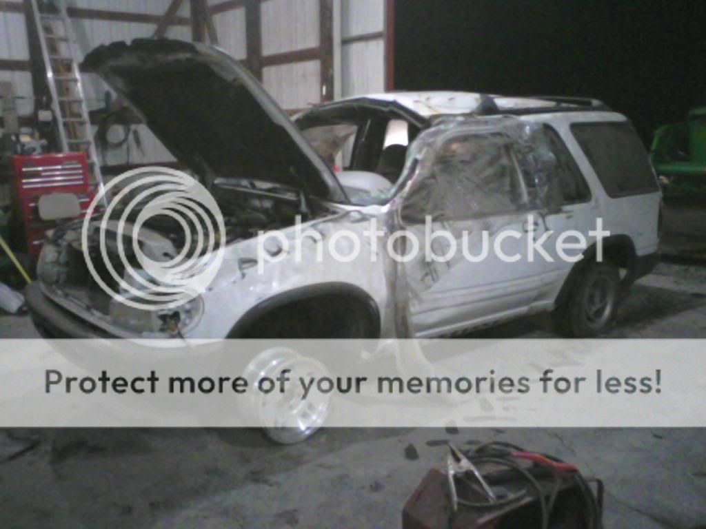

I did get Explorer #2 down to the shop today. Here's a cell pic of it in all its glory:
My Dad had surgery this week and is in the hospital, so I'm gonna run down and see him tomorrow. I'm Hoping to get a good start on this thing before the weekend is over though.
