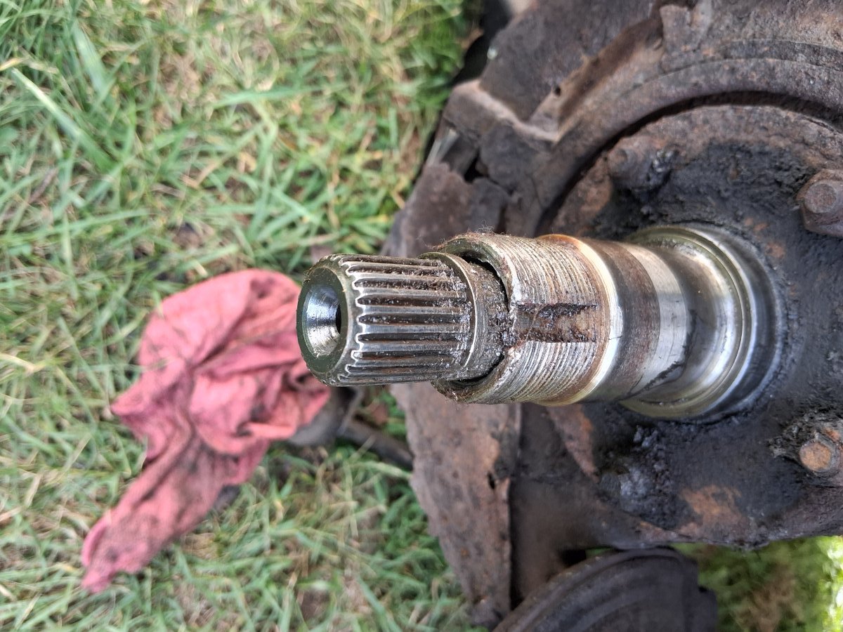

Also....i should honestly probably replace the spindle. It looks like the first couple threads are pretty ate up from what grenaded in there. Or do you think i could try to file them down and get away with it?

The hub i bought actually came with 2new hubnuts. Which is good cause i obliterated the old ones getting them off. Ill take a pic of the spindle and you guys can tell me if its worth saving or not.

Heres a pic of the spindle...it doesnt look as bad as i thought...
