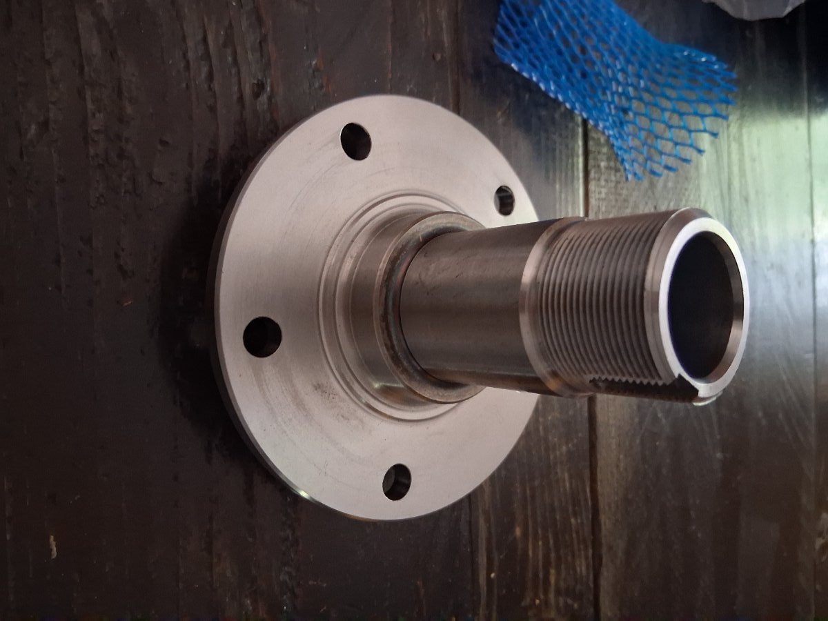

I was curious. I did notice they went in from the back and also felt similar.When I replaced my spindle hardware I found out they were Geo wheel studs. M10 and just hammers in from the back. Don't worry about snapping them.
Can i heat them a bit if need be without messing anything up? Im thinking if i clean the exposed threads, hit it with some MAPP and use my impact they probably will survive
