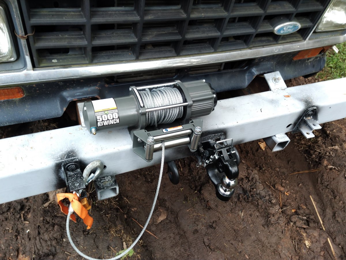

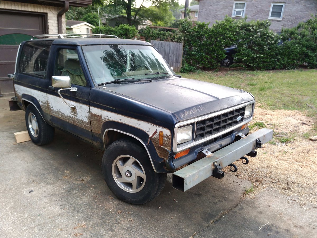

If I do not care about looks (aka my own vehicle) I go with something such as this:
Probably the simplest way and cleanest way for most people is to install a heavy duty receiver hitch (10000#) and run a strap through the 2x2 tube to a 5/8" pin. They make adjustable front mount hitches too.
