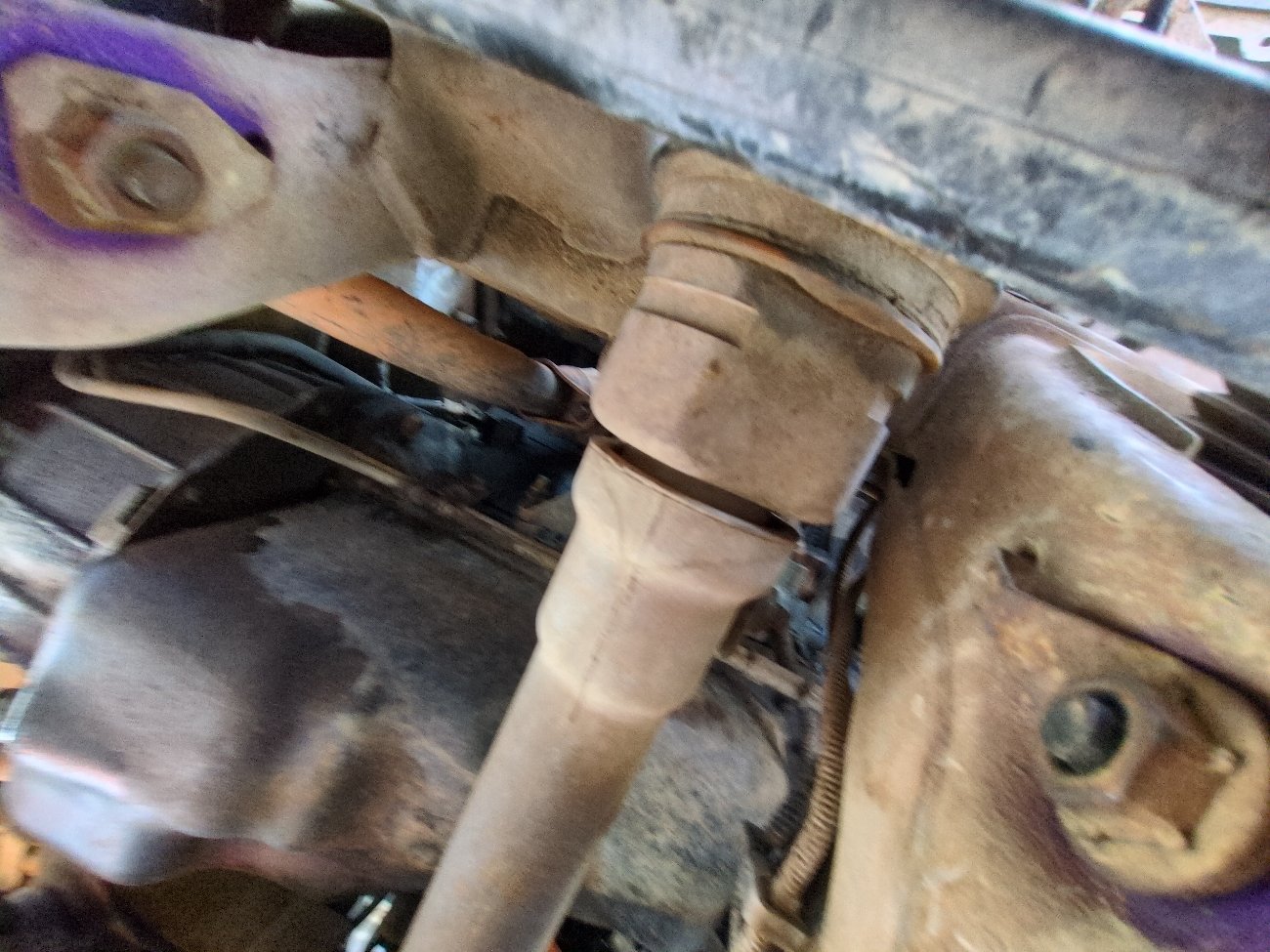

So I have a new to me '99 4x4 ranger which probably drove for quite a while with little to no suspension left, the torsion bars were all that was left so to say suspension wise.
My learning journey started with a shot lower ball joint and I'm ending up basically redoing the entire front. As far as I can see it's all original that I'm taking off and I gotta admit, it held up.
Ok, so I got everything off, which was quite the fight in some areas and I'm thinking... I got everything off right now, these CV joints are probably also original. What is wisdom?
27 year old CV joint,180k miles and I don't "see" or "hear" anything wrong. However, I'm also not sure what to look for. All those silly youtube video's are for cars with their wheels on driving around! I don't know what the lifespan is of these CV joints or the grease inside and if there's something I can do to ensure that I won't have to do this anytime soon.
Any ideas, thoughts, feedback here are really appreciated.
If the boots are good... no grease slinging around... splines and axle nut threads are good...
Since it's all been apart and you know how to go back in if you need to... run them until they're not good.

I would say if the boots look good (as in no weather cracking/drying), run 'em.
It's not real hard to pull the shafts out later if need be (which should be a good number of years in the future if they currently still look good).
Aftermarket shafts & boots tend to be inferior to the OEM ones anyway (not sure if OEM boots are still available or not... If they are, you should be able to reboot your existing axles for much cheaper than it is to buy any aftermarket axle).
I think you actually got a point there. I can't "see" or "feel" anything wrong and I do know that I can back in there if I need to. Plus, I think that with all the holes and threads cleaned disassembly should be a lot smoother next time.
