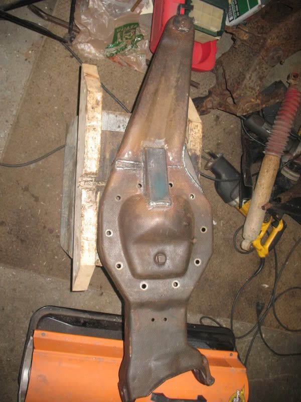

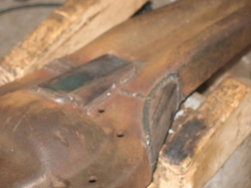

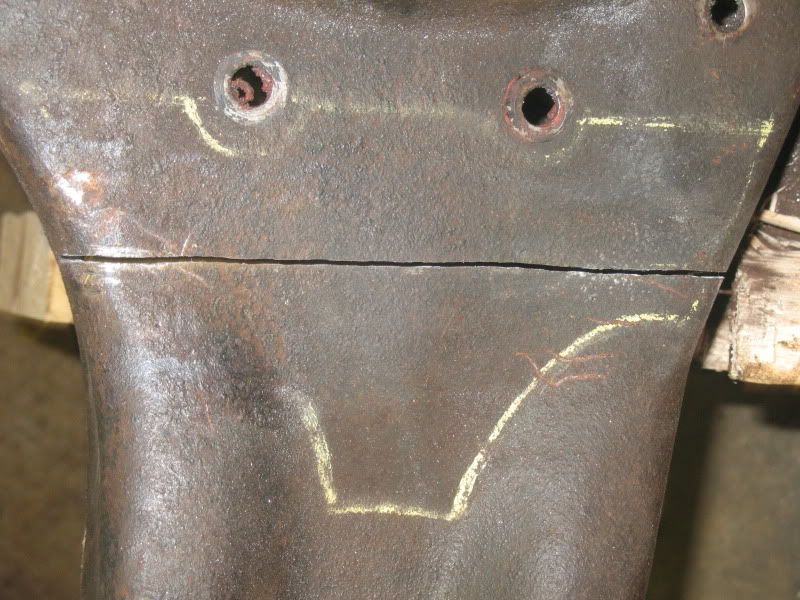

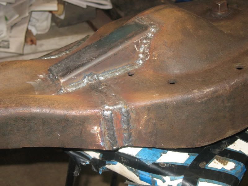

Here are some pictures of my results:
vertical cut beside diff
Filled gap, trussed
