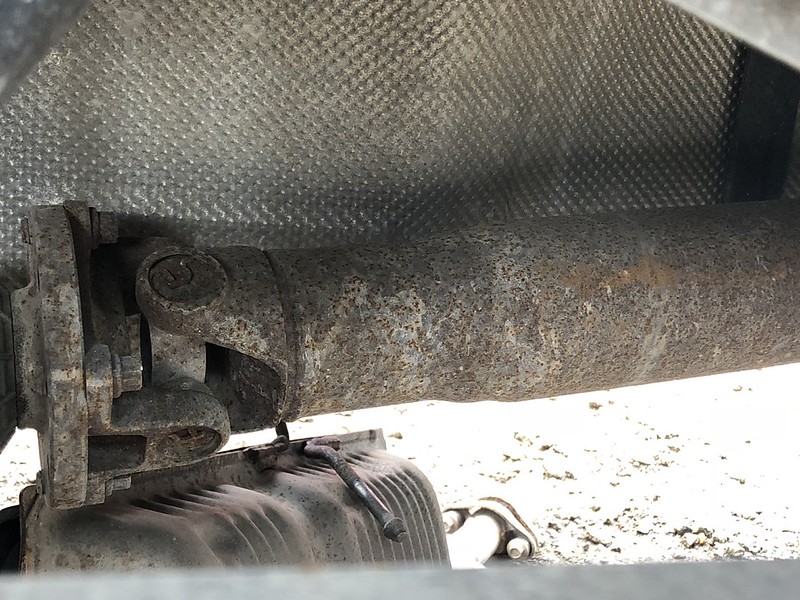

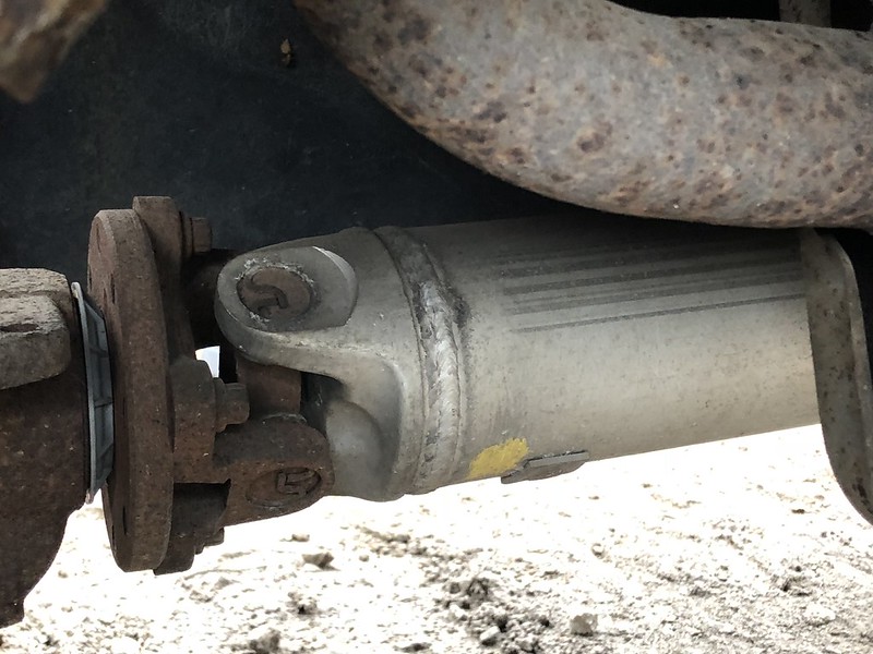

From what I could tell on them between an '03 with a steel shaft and a '98 with an aluminum shaft the shafts themselves are about the same diameter, the ends taper a bit more on the steel one though. Note how the major OD of the driveshaft compares with the yoke:
I do like how the older aluminum shaft looks compared to the steel one though...

That shaft doesn't look at all like the one we put into a friend's '93 SC... His has the same diameter (about 4" dia. IIRC) it's entire length. It was said to have come from a '99 Ranger (my brother's '98 4.0L also has the same shaft as well). It's definitely smaller than the aluminum shaft.

Do any two trucks actually have the same kind of driveshafts?
Holy cow. Had steel forever, went to aluminum back to steel but now we have different diameter steel shafts. :rolleyes:
