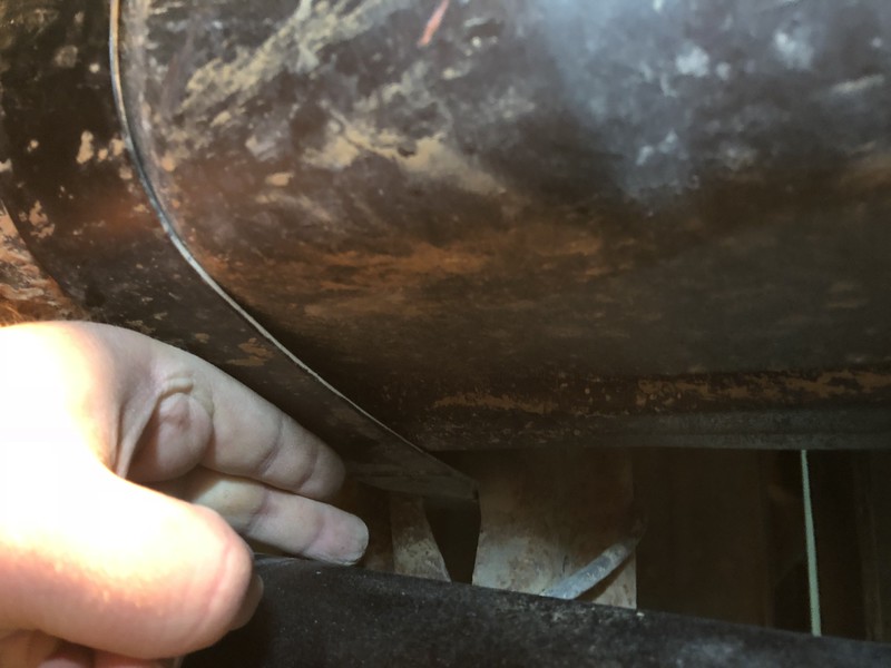

And for fuel tank clearance it is baggy with two fingers, probably could get 2.5 but I am not dedicated enough to find out. :icon_thumby:
In the trucks I looked at it seemed like the 98+ trucks had a flatter/wider fuel tank where mine is almost square.
You have a -lot- more clearance around the tank than I do.
I don't doubt it, you can see where the driveshaft had been rubbing on a big cardboard shield thing between the driveshaft and fuel tank in the '99.

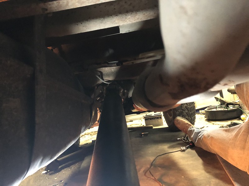

Pretty much the same thing we did, I had new u-joints installed, when we got under the truck ittook longer to remove the carrier bearing support and only about 20 minutes to put the drive shaft in place which fit perfectly, did not even come close to the gas tank like I thought it would, crossmember remains doesn't seem to be a problem,
I had to knock 10" of length off the shaft which was done last week, new u-joints and slip yoke grease are due Friday.
