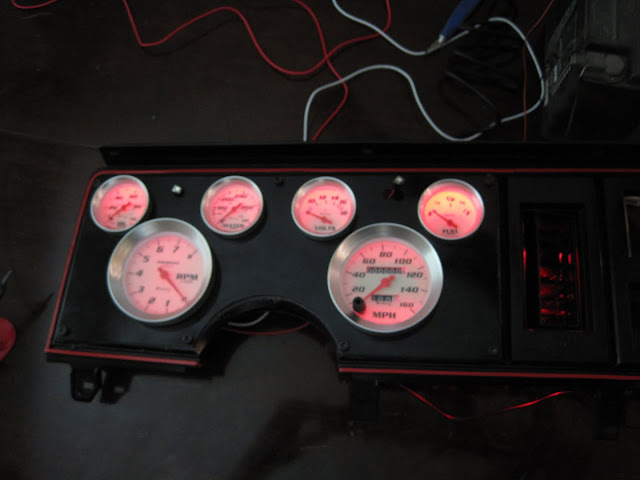

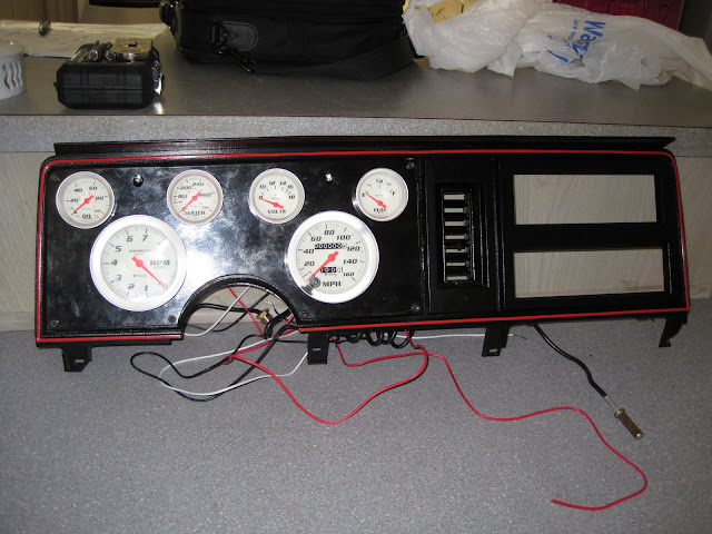

Here's what I did in my 88, managed to keep the radio and vents...
Lit up...
Local Oreillys and no I didn't have to change the float!
Lit up...
how did you wire that up? did you bypass the ecu? or did you pull the cluster and use the wiring off the ecu? ive been thinking about doing this to mine just wasnt quite sure on how to wire it all up.
I am not using the ECU and most the gauges came with their own sensors. The only exception was the fuel gauge, I used the existing wiring for it and the lights so they dim via the switch. The turn signal lights also come from the existing wiring.
