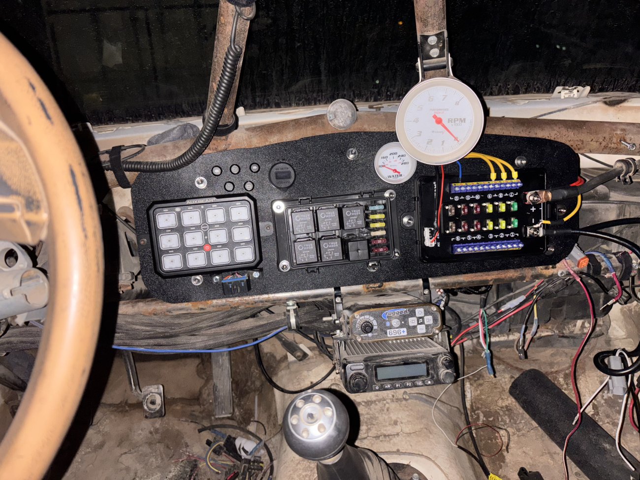

The truck is running a factory engine harness through the factory C124 plug mounted behind the PS pump and from that plug I have leaned out the harness to make it a somewhat stand alone harness for my application. That harness goes to my dash where I have an all the switches, fuses, relays etc.

I got my dash panel in with the led battery light wired up. I fired up the truck and let it run for a minute and the battery light never turned off.
Couple of things to note: I do have a volt meter that is built in to the usb port I put in. That meter was reading 14.7-14.8 volts. I need to verify what reading I’m getting directly on the battery. I do know that with my old dash panel I had a similar volt meter and it also read high around 14.6-14.7. I should also note that my old battery is toast and the regulator may be cranking up the voltage to charge it.
In the next couple of days I’ll go out and verify voltage at a few places and see if everything is getting the voltage it wants/needs. In the meantime I’m going to do some reading and see if I can’t find a way to get the light to turn off when the alt is charging. It may be as simple as the 470 ohm resistor in parallel with the bulb. I’ll report back in the next few days.
