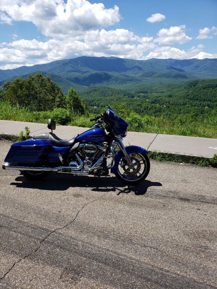

View attachment 52692View attachment 52693
Maybe I ought to think about painting it Blue .. huh ? The truck that is ...
I know its off subject.. but how are.you liking that 124? I may go that route once my motor decides if its had enough of the 6600 rpms, wot powershifts , clutch dropping banging the rev limiter and tire smoking rides. I do ride it normal when the boss is on back..lol
I swapped in S&S585 cams fuel motor x pipe and thunderheader slip ons and tune. did 100/111 on otherwise stock 14 street glide. Bought it brand new and 4 months after I had it tore the engine apart.
