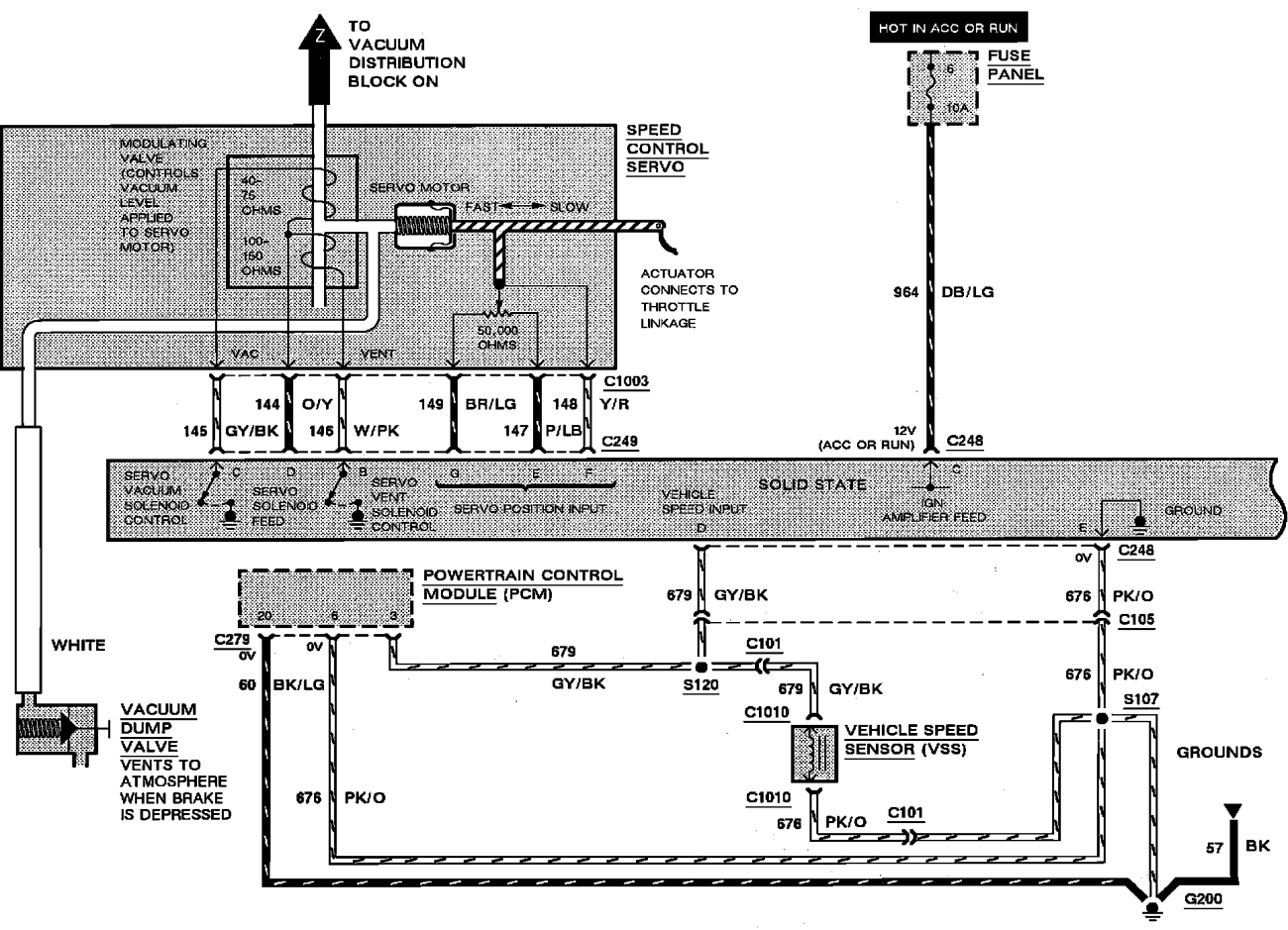

You didn’t mention checking the fuse. Here’s the diagram in case you don’t have it.
