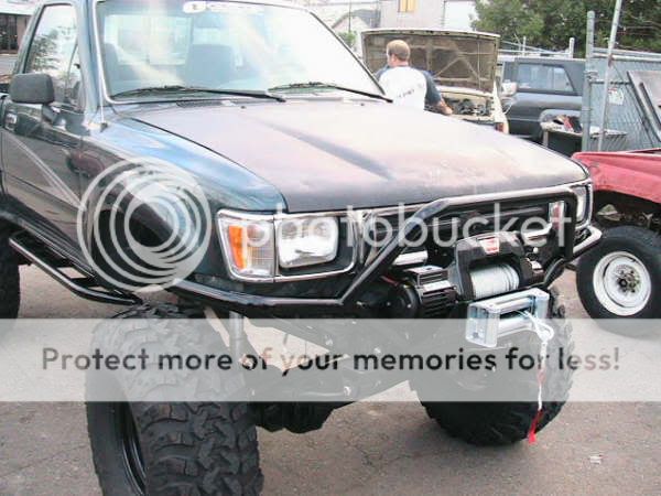

got my self a raw 32" wide winch plate that I want to run between the frame rails so that I can keep my approach angles and then fab up bumpers similar to this.

should be similar to this
That will look cool if you could get the factory bumper back on it some how and put the fairleed on the opening in the front bumper.
in the works... will attach some bent HREW and reinforce the bottom with some thicker plate this weekend i want to be able to pivot around rocks with them

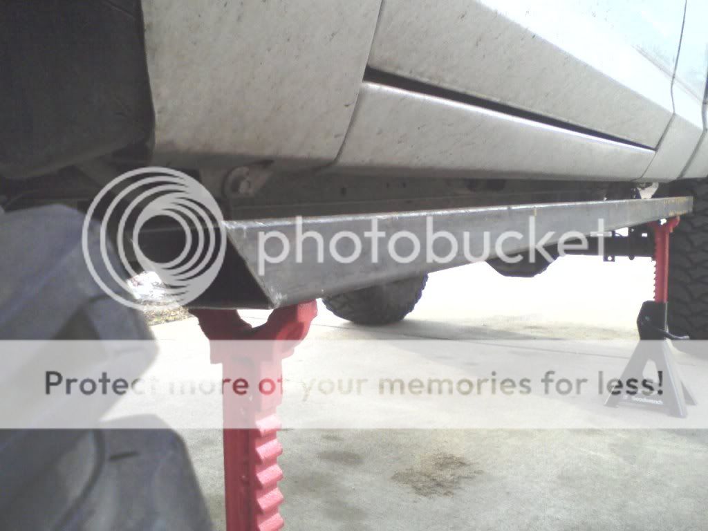

sliders are nearly done, just got a few bends to make:icon_welder:

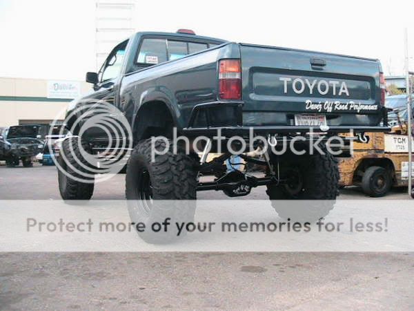

this is what the former owner used it for...rolled yota truck turned crawler with dual trannys. should be sick when its done. Anyway it obviously can bend

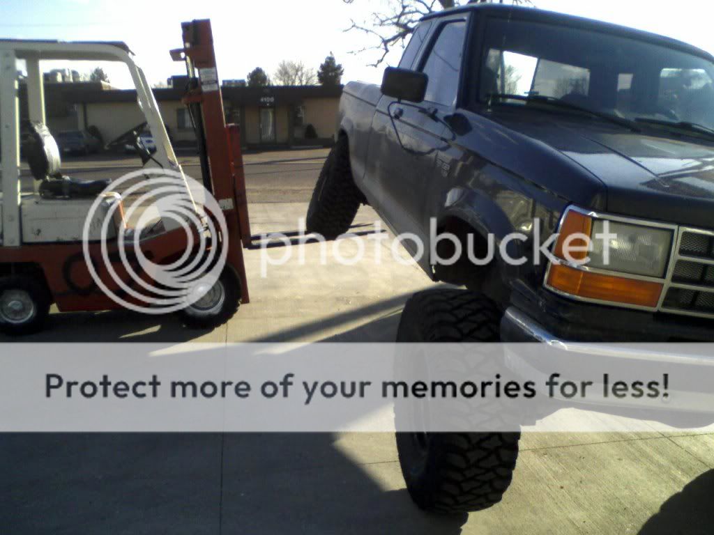

Hey Crawlin91 nice build. What size list are the drop brackets for? Did you do the 4" lift 6" spring swap thing?
thanks Kona, I used 5.5 superlift brackets on the 6"(bottom) hole with 6" skyjacker soft coils. I may add washer spacers in the future to raise the front end up a little but Im not sure how that would affect my alignment or if I would have to get new bushings.
