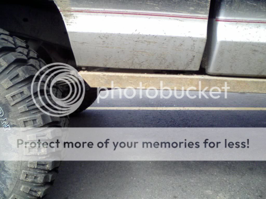

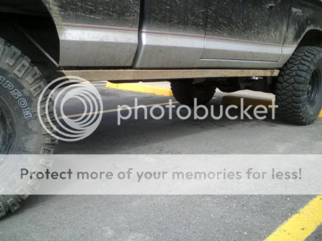

got the start of my sliders done... they got a lil rusty
any pics of how you attached the sliders to the frame, thanks
yeah Ill get you a pic of the mounting brackets I used.
