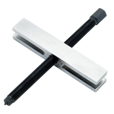

I've got a 93 Ranger with the 4.0L, been scratching my head for a couple days trying to get the pulley off the crankshaft so I can get the timing cover off. I was trying to do it without taking the radiator and condenser out but wasn't working so I took them out and now I can see that this pulley isn't like any others I have worked with. is there anyone here that can give me some clue how to get that pulley off? I have been using these types of pullers.
a few hours later and 19 looks and I figured it out. I had to use the bolt to push against. I put a little pressure on the pulley with the puller then hit it with a 4lb. hammer and brass drift, rotated it to hit all the way around it. pull a little, move the bolt out, pull a little more, repeat many times then go get a longer bolt to finish pulling it off. I'm getting a new bolt to replace the one I've been using the puller against.

At home I have the factory puller for the 2.9/4.0, it looks just like the puller you were using except it has a really L O N G "snout" on the jackscrew that can reach to the bottom of the retaining bolt hole and actually push against the crank without touching the threads.

I would think a cheap alternative would be to buy a replacment HB bolt from the hardware store around an inch longer than stock. Thread it in by hand (don't want to damage the crankshaft) and press on that. This should protect the threads. Note you will probably need to grind off the threads near the tip, since threaded holes are never tapped all the way to the bottom.

on most atv pullies that are similar the inside of the pulley has threads and a bolt threads into it and pushes against the shaft. I was wishing I had that long snout for my puller, would have been easier.

the bolt cost me under $4 at westlakes hardware. I'm sure the long snout for the puller would have been much more than that. once I got it to move a little there really wasn't that much pressure against the bolt.
I didn't put it all the way to the bottom, didn't want to damage the threads.
