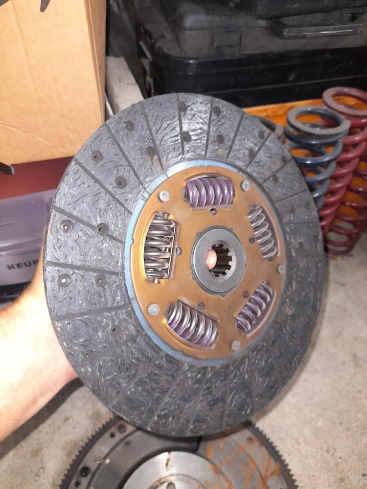

I bought a 302 of 99 to 04 vintage and began buying parts from a local guy who did this swap to his ranger - I already bought his flywheel, course spline clutch disc and pressure plate all with less than 400 miles on them - I now went to buy the T5, which I knew would bolt up since it did in his swap, and it turns out that the case is cracked so he junked it - now I come to the issue of choosing another trans on my own and I am not that up on my Fords anymore - I found a T5 locally that sat behind a 4.6 so I know it will handle a stock 302 but will the bell housing bolt up and is the input shaft the correct length - I have attached photos of the clutch disc I already bought (10 spline) , the input shaft on the T5 from the 4.6 (appears to be also 10 spline) and the serial number of the 4.6 T5 for sale - could anyone help with info? Thank you

Few thing here...
1) 5.0L/302 is commonly referred to as a Windsor or Small Block Ford (SBF). The 4.6L is most commonly referred to as a Modular (mod) motor. Their bell housing patterns are commonly referred to by the same names.
2) Nearly all SBF and Mod motors had different bellhousing patterns. The mod motor bellhousing pattern was new for it. Some very early Mod motors had the SBF pattern, allegedly it was only the first two casting runs of the engine, that would be in the early 90s and they didn;t start putting a manual transmission behind them until the mustang in 1996. Can't speak for the inputshaft, but it's probably same as the bellhousing.
3)That is not a Borg Werner T5. That is a Tremec TR-3650. Those were introduced in 2001 behind the 4.6L in the Mustangs. While it is arguably a better transmission, I can pretty well guarantee that it will not bolt up to your SBF. Also the 3650 has an integrated bellhousing so it can not be swapped out to make it work.
You'll need either a SBF or 3.8L/4.2L V6 T5 to have the same bellhousing.

Will the 3.8L/4.2L V6 T5 be able to take a non fuel injected 302 and still live even though it was built for a V6? And will the input shaft be the correct length and be 10 spline? Thanks
I can't say for certain, but I think that they were the same strength wise as the SFB version (called a T5 World Class), but may have had different gear ratios. I haven't looked closely at using that version, just recall that they should fit behind the SBF.
Of note when looking at V6 T5s, the 4.0L Mustangs also used a T5. The 4.0L T5 will not work with the SBF, it had the same bellhousing pattern as all other Colgone engines.
