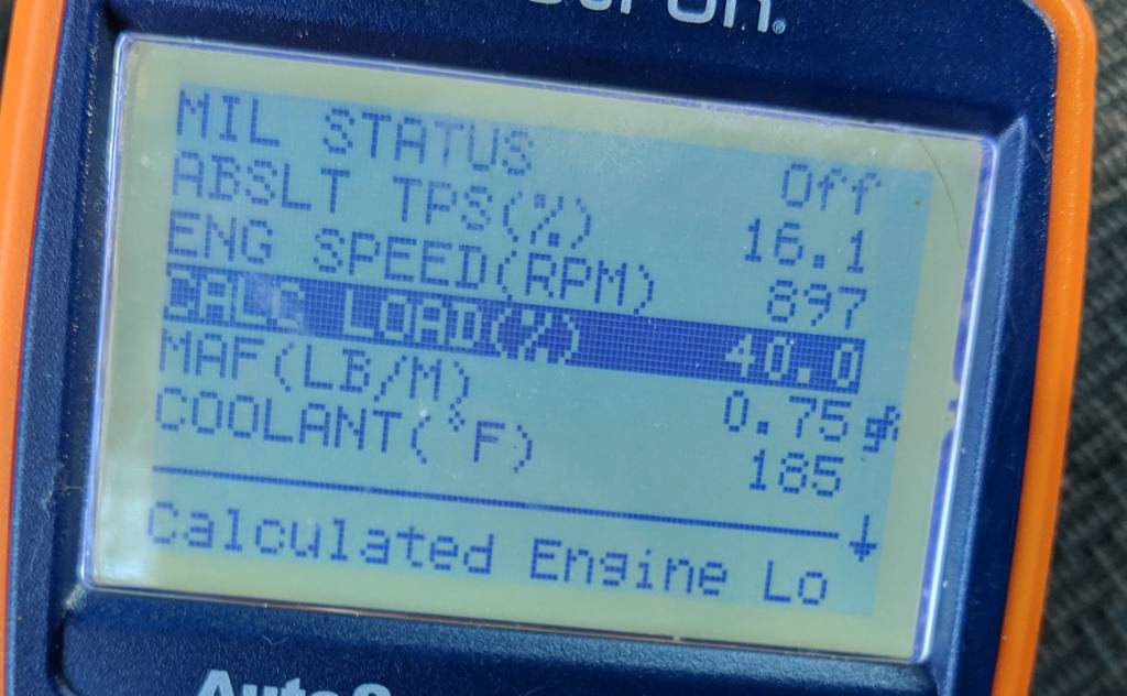

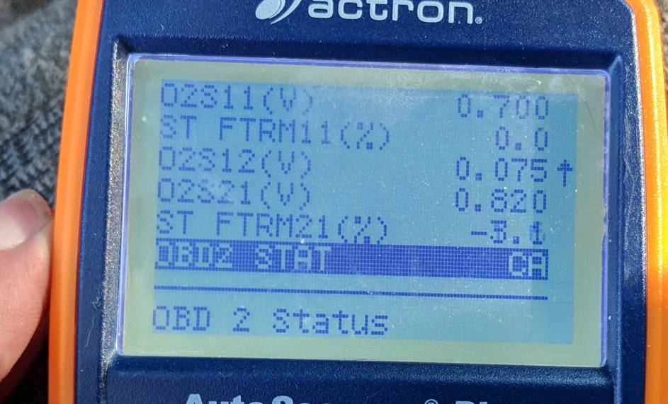

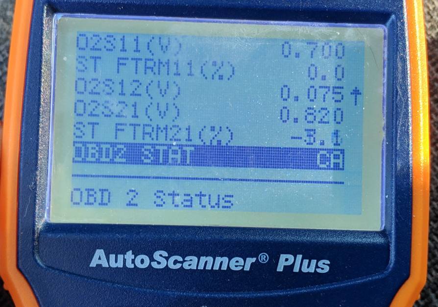

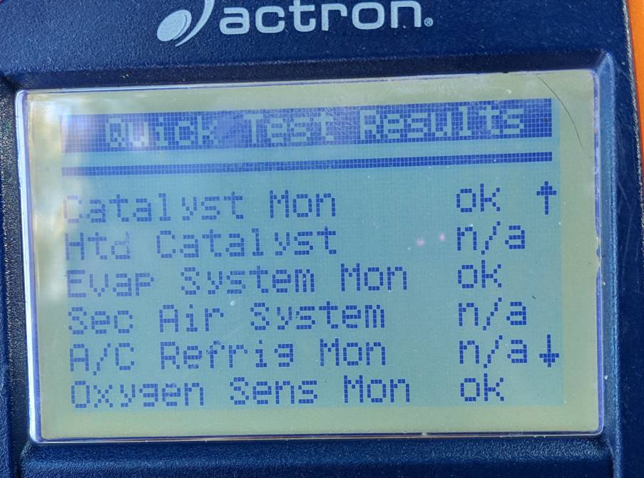

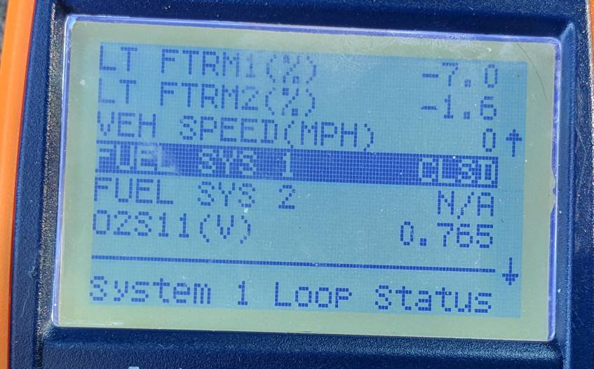

I was unable to get the gauge to go hot by grounding it/following the procedure you specified. I'm beginning to wonder if there's an electrical issue somewhere. Anyway, today as I was doing these tests, the engine was really vibrating and just doesn't seem healthy. I'm going to attach some photos from my scan tool, I think there is probably something obvious going on here that I'm missing.
The photos are live data taken while the truck was idling, it was running for about 15 minutes before I captured the photos.

Sorry, I'm still a newcomer at all of this but by 180 do you mean thermostat degree spec? Also the temp gauge is completely non-functional. Did you spots something that non-standard in those readings. This truck was my dad's and I'm currently trying to fix it up. He is suffering from dementia and cannot recall the work he did to the truck over the years.
Also isn't a 40% load pretty high while the truck is in park, warm, idling at 890-920 rpm?

Coolant sensor is showing 185degF so thermostat is working like it should
It should be rated at 190-195, so engine will run at 185 to 200 deg
180deg T-stat just wastes fuel, lol.
Yes, your wire from temp SENDER to the dash is not connected to the dash or the gauge in the dash has failed
900RPM idle is high after warm up, i.e. temp sensor showing above 150degF
ST fuel trims are showing high voltage at O2s
.1 is lean
.9 is rich
so .7 and .8 are on the rich side, but..............that is normal at idle, which is rich, O2s are not used at idle or WOT(wide open throttle)
While cruising along you should see .3-.5 average
