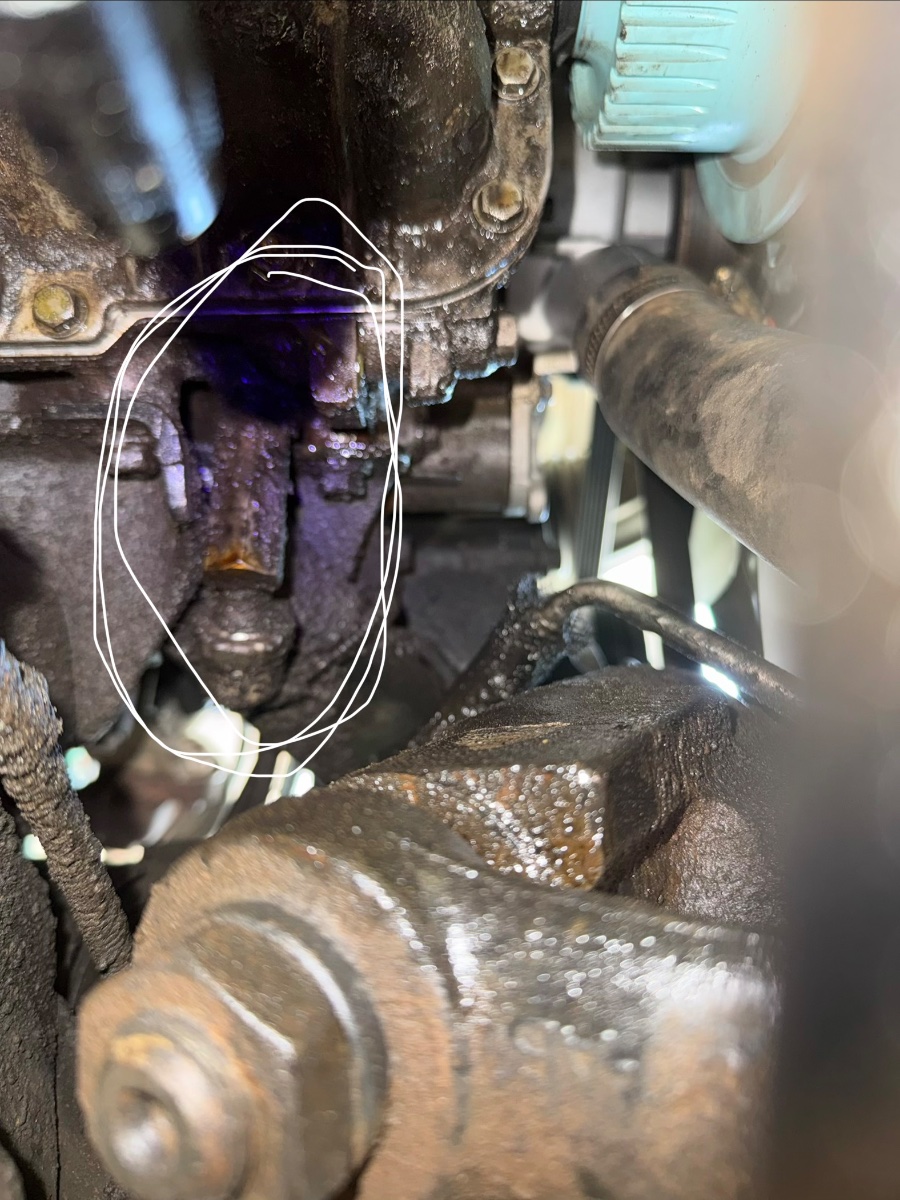

I found a coolant leak on my truck about a hour ago. We put uv diy in it a few months ago for another leak so it was still in the coolant. I put a uv light on it and found it was leaking from one plug. Can anyone tell me what the plug is? It’s on the driver side rear on the engine.

That's your oil pressure sensor, so it better not be leaking coolant from there.
Just above it however is a core plug. Could be leaking there...
