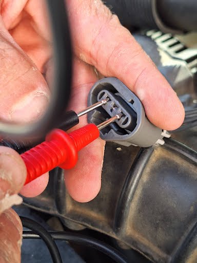

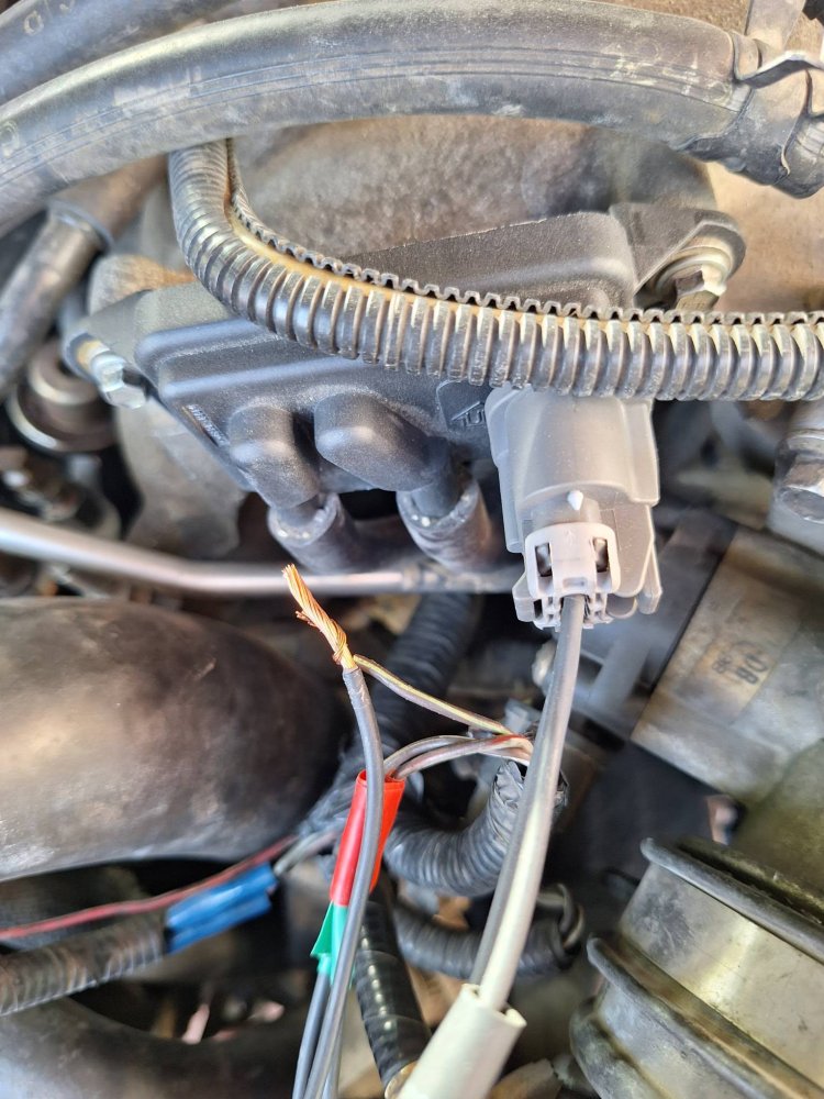

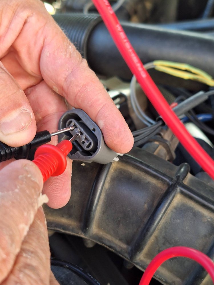

Hello. Thanks for the input. I matched up the pigtail as image shows. I also went and used a Meter to test the DPFE with "Key On" and took the images attached. I am not a Pro or even sure I did it right but I do not get .5v...
Are these correct? What to do from here? I never traced a bad ground before so not sure of process...thanks for all the support!

You need to find a way to test the voltages on those wires with the plug plugged in. (and key on) If you can't probe into the back of the plug, perhaps you can test where you spliced them together?
To test, connect the black lead to ground, either batter negative or another good clean ground like the engine block or cylinder head, and then touch the red probe to each of those 3 connections. One should read 5 volts, one should read zero, and the other should read something between .5 and 4.5V
You can backprobe by sticking sewing pins into the wires. Just push them through the insulation so they touch the wires internally. Then attach your meter to the pins.
Technically, back probing doesn't pierce the insulation. You slip a conductive needle between the plastic connector shell and the wire so that it touches the blade/pin in the connector.

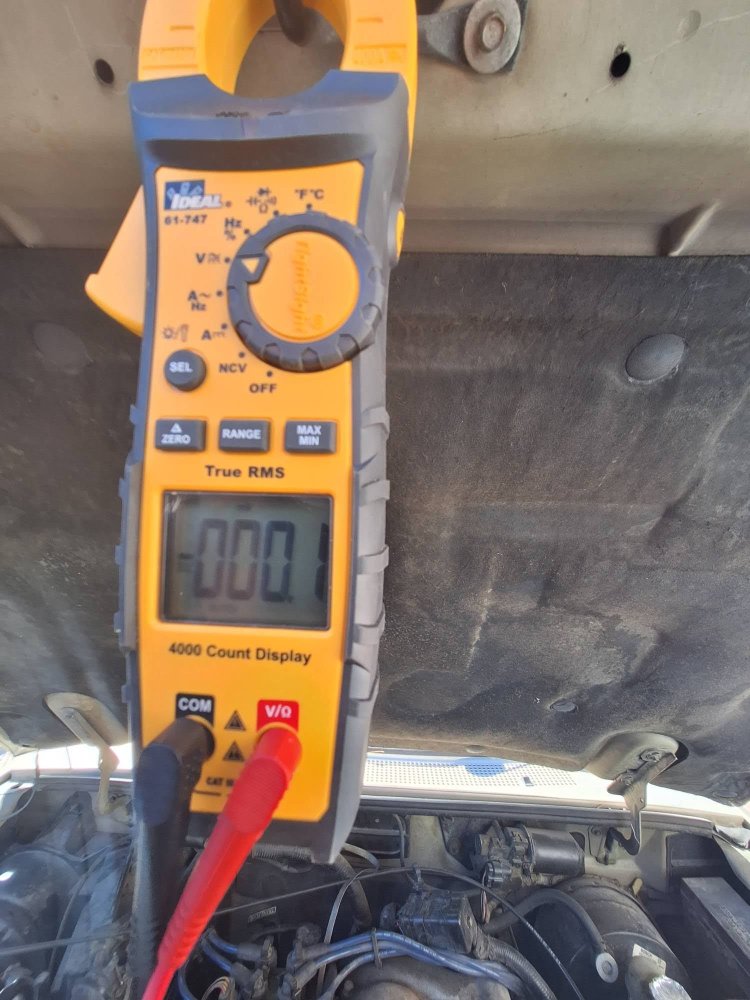

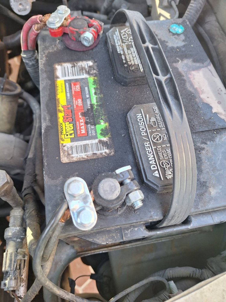

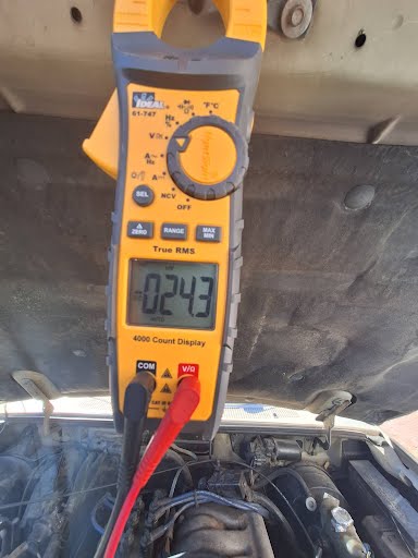

Hello. I was finally able to test the ground wire; just making sure I am doing it right before I continue with the other two wires if needed.
With the KEY ON...I took the BLACK end of the test probe and placed it on the Negative Battery Post. I took the RED probe and placed it onto the DPFE pigtail green GROUND wire where it was spliced to change the pigtail.
The meter was set to DC Voltage. The meter bounced a bit but generally stopped on 5v. Tested several times.
I was told 5v is correct...so I am doing this right? Seems this wire is Ok....
Thanks for the input!!... My power animal is a turtle...so I am a little slow sometimes.
-SRD

Sorry, forgot to add a pic of the DC voltage....stops between 5.00 and 5.05 volts.
Thanks.

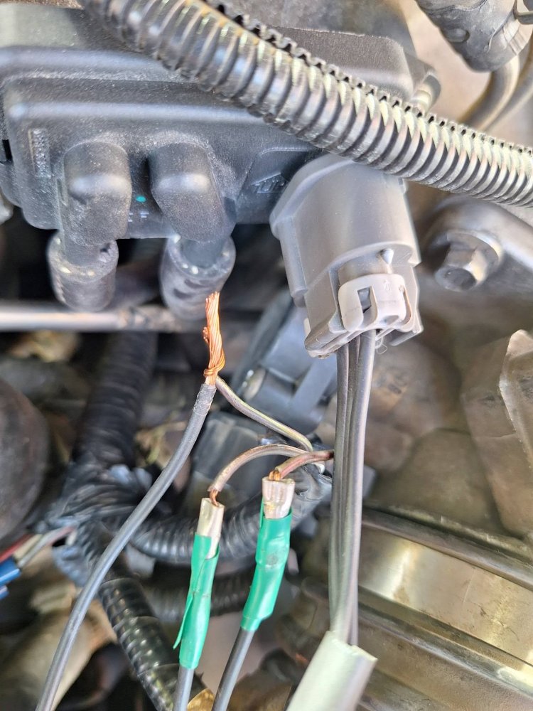

I'm showing the color codes as:
Brown/white 5v
brown/lt green sig
gray/red sig return (gnd)
You are getting 5v on the signal wire (incorrect).
Do the same test but move over to the gray/red wire. that one should show ground (or very close).
Wow! Thanks, for the fast input! I was at my truck and did the same test on all 3 wires per your instructions with the following results.
1. Brown/White 5.08v
2. Brown/Green 5.05v
3. Grey/Red 31.2v
So, this is not at all what I should be getting I take it?
Also, I had these issues before I changed the pigtail....thought that might have solved it. Guess not....
-SRD
