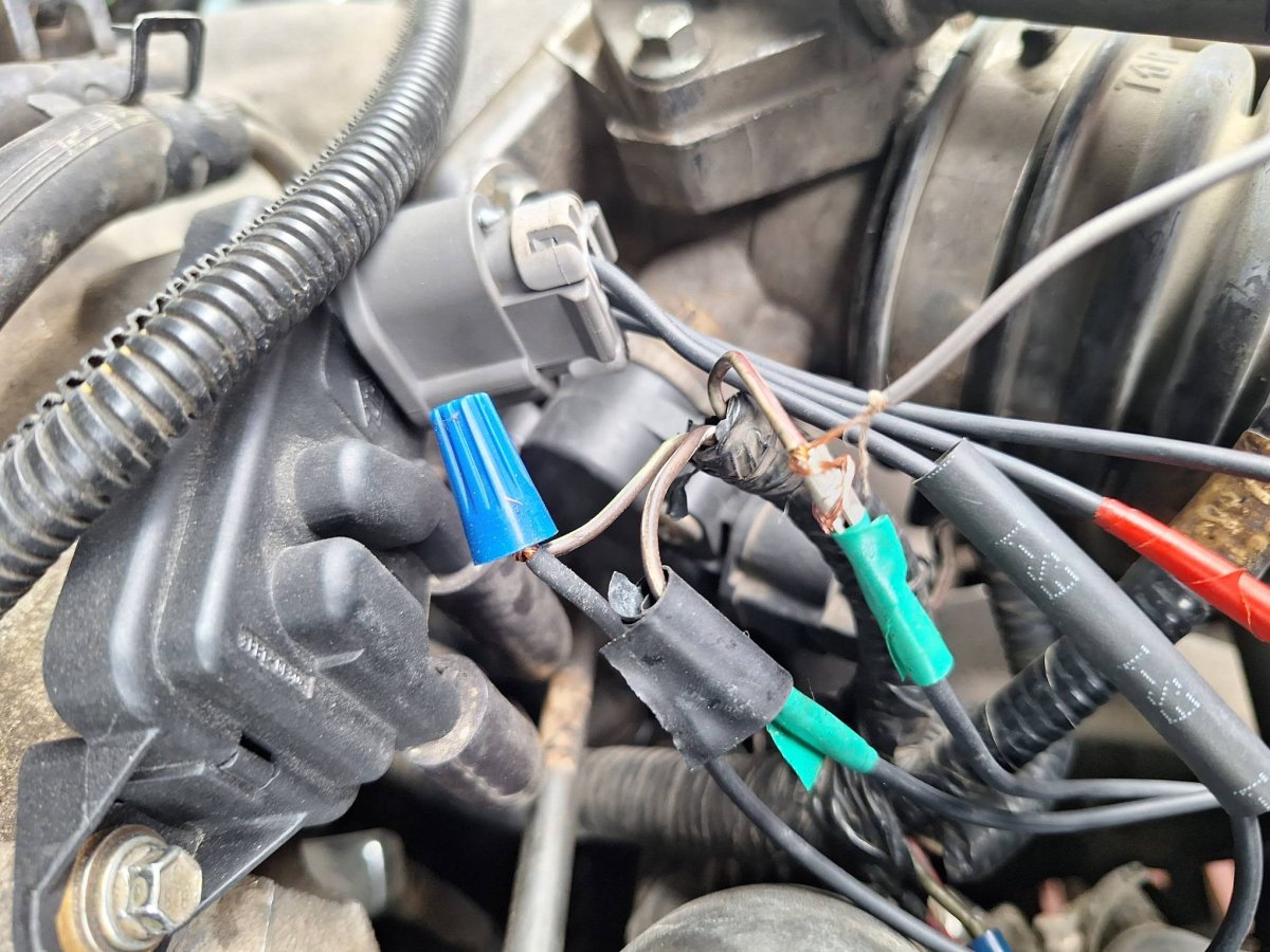

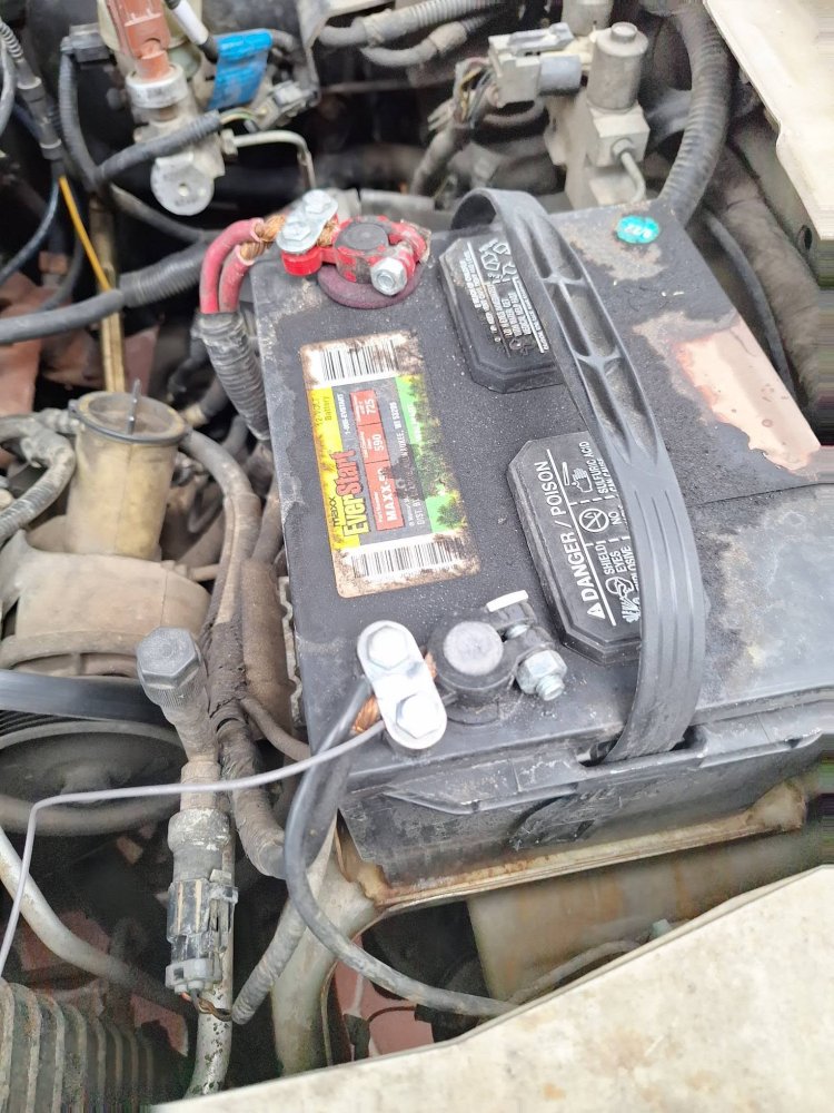

I finally got some wire and connected it from the red/brown wire to the battery negative terminal. See Image.
Then with the Key ON, and the connector plugged in I placed the Black probe on the Neg battery terminal and the Red probe on the wire connecting the red/brown wire to the battery terminal.
It bounces but ends on 24.9 and 25.0 mv on Volts DC mv.
I did the same thing with the Light green/brown wire and I got 5.05 and 5.04 Volts, not mV.
I used an old wire not sure if it needs to be a certain gauge or not etc had no automotive wire but will get some if needed...my first try so if I made an error let me know.
Thanks for your patience and assistance in figuring this all out.

Any wire will work for this testing. I can't see the wire colors in the photos and after a couple days I can't remember which color codes are which because old man memory. :LOL:
Mechrick was suggesting to supply your own ground to the sensor, which I believe was gray/red? So you'd run your wire from there to the battery negative. Then test the signal wire- brown/green was it? test with key on from green/brown to ground. Don't worry too much about which color lead goes where, that's for later electronics lessons. If you have them reversed the meter will read negative volts but it won't hurt anything and the value will be the same, just negative.
edit: FYI, in your first test, you were basically measuring the voltage drop across your improvised ground wire - all wires have a small amount of resistance and therefore the voltage will drop a small amount across a length of wire. These very small fractions of volts can be ignored for these tests. It's that second test that you did that's important- 5 volts is too much there, it needs to be between .5 and 2V
So that light green/brown wire should now be reading less than 2 volts. Either the pin of the connector(s) is not making contact with the sensor, or the sensor is bad, or it's wired incorrectly.

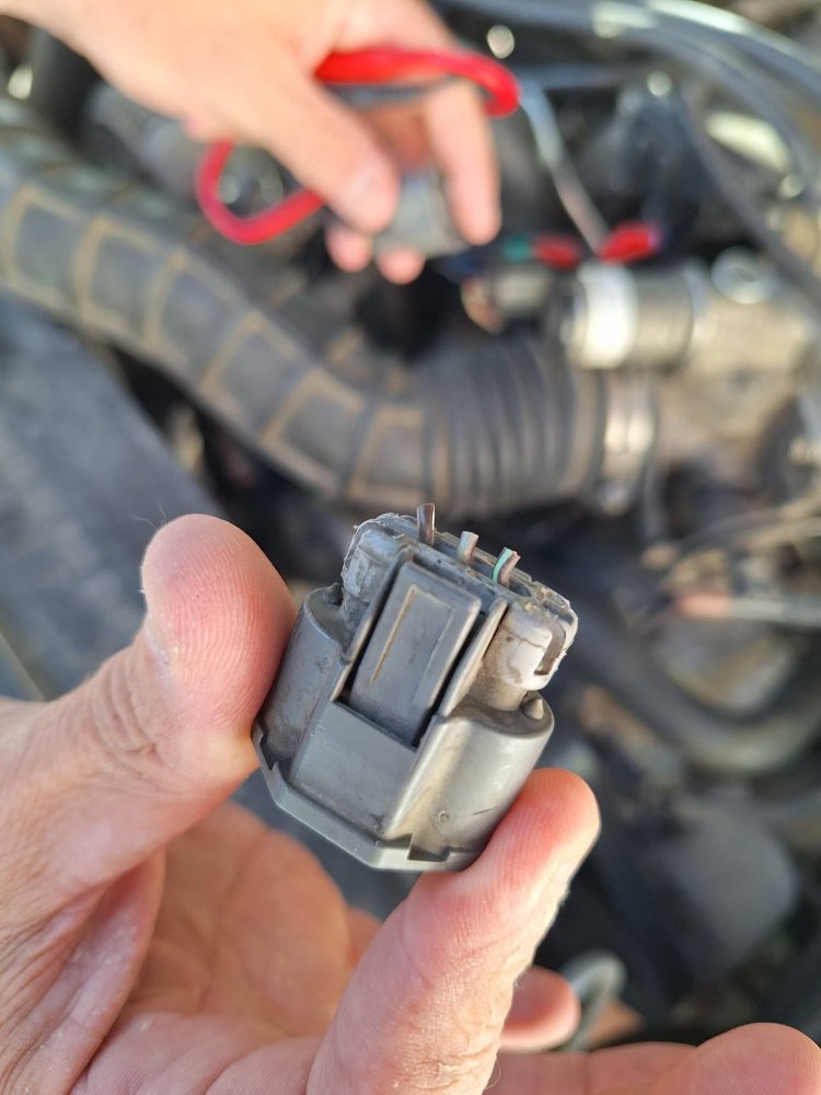

I can't find a connector diagram. Someone else want to take a look at their truck? The location of the wires in the connector is what we need.
I am not sure if this helps out with what you are looking for. I took a picture of the connector when I changed it so I made sure it was facing the correct position to plug in and I matched wires to color with that so they lined up perfectly and plugged in the same way.
*The connector pigtail might not have been bad if the same issues after replacement. I do make millions of errors so possible I could have done something when installing maybe.
Thanks for the assistance!
SRD
My concern is they weren't correct to start with.
Well, the connector and pigtail wire looked factory original when I cut them to replace them. The Check Engine Light issues here came on 2 years after I bought the truck so the wire should have been fine until this issue started happening.
*Should I try to swap the end wires to green etc...the center wire stays the same I think. Just an idea as I don't know enough to know really what I am doing just learning what I can.

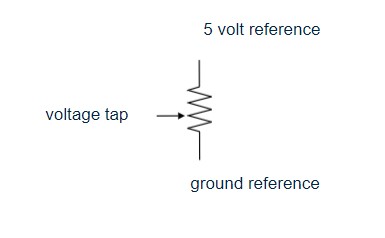

What's going on isn't making sense. The DPFE sensor is a voltage divider. It works like a potentiometer, in that the voltage can vary between the source voltage and source ground. At rest (Key On Engine Off) the sensor output should be less than 2 volts. With all three wires properly connected to the sensor, the ground reference (gray/red) will allow the sensor to pull the output (brown/lt green) down in voltage.
If you lose the ground reference, or the signal wire is open circuit between the sensor and the PCM, the signal voltage will float to 5v because of an internal pull up resistor in the PCM.
The image below shows a voltage divider. If the wiper of the adjustable part is dead center on the resistor, the voltage will be divided by half and the output will be 2.5 volts. If the wiper is closer to ground reference, the output will be closer to 0 volts. Closer to the 5 volt source voltage, the output will be closer to 5 volts.
The DPFE works similarly, in that if connected and Key On Engine Off, voltage output will be a fixed value less than 2 volts.
The reason to check it at the sensor is to verify the integrity of the sensor. If you are truly getting 5 volts on the brown/lt green wire and you are sure the connections are good, then the sensor is bad.
