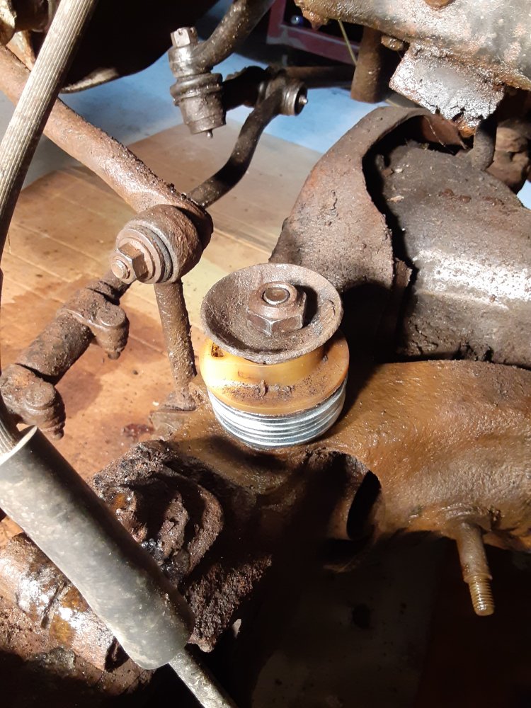

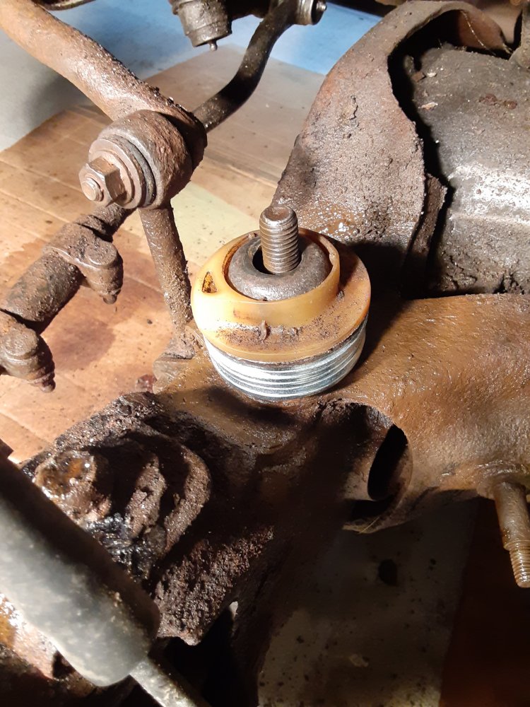

I had a closer look at it - with my glasses on :cool: and a magnifying set on and it looks like it's just the top couple of threads where I whacked it with the hammer. I'm thinking if I carefully grind off the end down to where the threads are good, I'll be able to salvage it. Should only be about 1/8 of an inch.🤞
That will workjust back it out carefully, and when screwing in the new one give it a good push, it will bite fine...a little loctite won't hurt...
Maybe try to hit it with a wire wheel first. Also I've had luck cleaning up threads with a corner file.
Got it done last night. Wire wheeled it to death, hit with a grinder to level it out. Corner filed the first few threads to clean it up and viola. Film at eleven.

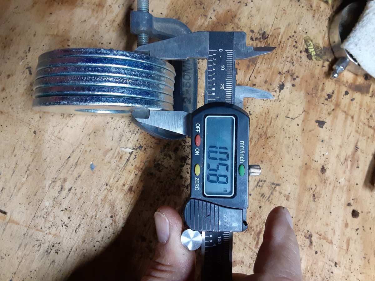

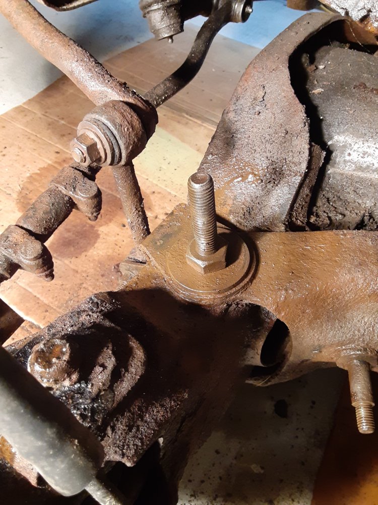

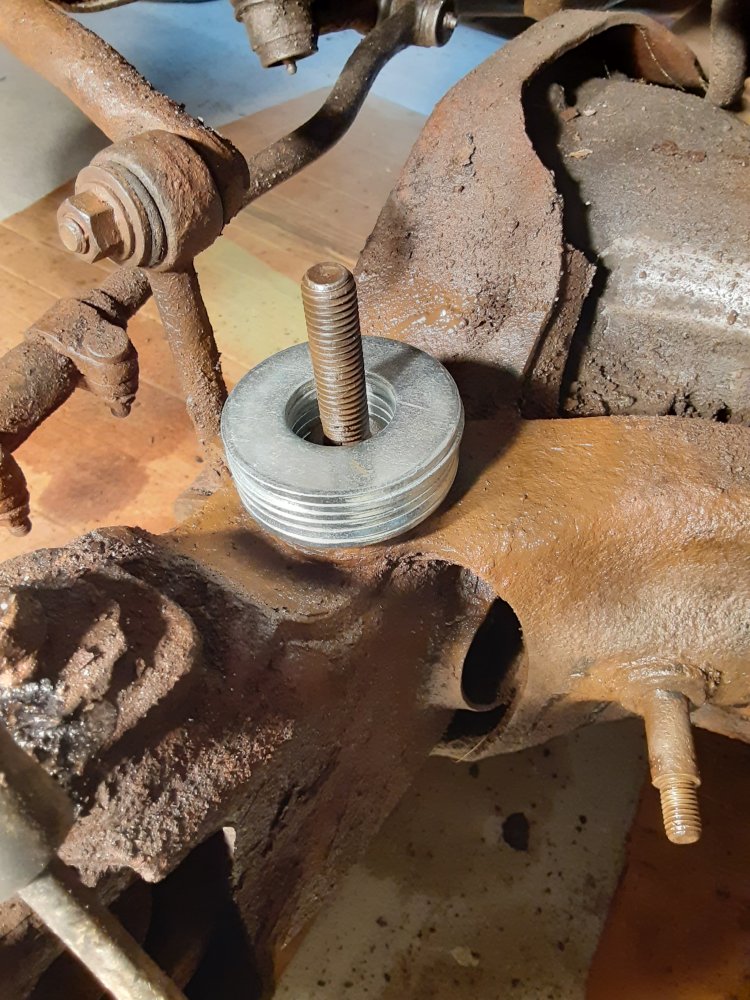

James Duff is a little out of my price range ATM. But on another note, I am proceeding ahead with the washer lift while I await shocks and springs.
Here's a couple of pics
: 20220106_170024.jpg 20220106_165538.jpg 20220106_165619.jpg 20220106_165704.jpg 20220106_165826.jpg

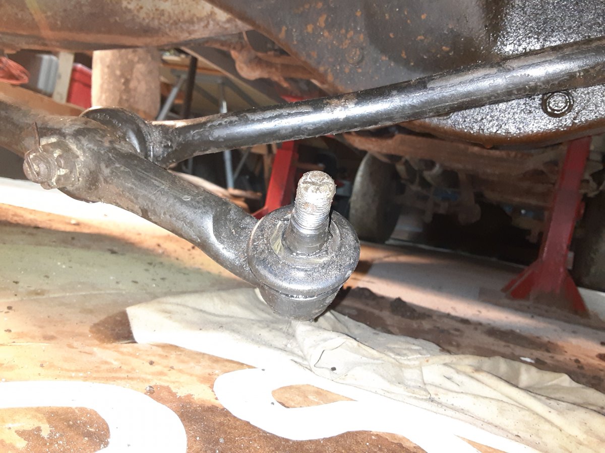

Well....it looks like I damaged the threads on the zirc fitting on the drag link...this one:
Haven't looked yet, but will prolly have to replace it unless I can file the threads open enough to get the nut on.
Still in the barn cleaning stuff...dammit. almost made it with no casualties

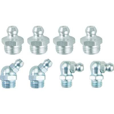

Hey. Just for a little education for the future so you understand the terminology. I don't believe you were talking about a zirc fitting here. The picture shows the ball joint on the end of your drag link. A zirc fitting is the little nipple thing that you attach a grease gun to so that you can pump grease into a ball joint, bearing, bushing, etc.
Also, next time you need to hammer on a ball joint or something similar, leave the nut on, just barely extended past the end of the ball joint threads. Thay way, if you damage something with the hammer, it will be the nut, which is cheaper and easier to replace. Plus, when the ball joint pops free, it will only drop as far as the nut will allow. It keeps things from flying around.
Zirc fittings

You are absolutely right. I was talking about the thing the zirc fitting is threaded into. I didn't know what to call it. I didn't think it was a ball joint so I just "wung" it - (past tense for wing it). So thanks for making me smarter. So what is it? A bushing? And how do you get them out to replace them? Ball joints I can figure out from another string, but the drag link or center link - that has to be a bushing? As I was filing the threads back to life and putting the nut back on, it dawned on me that I should have left the nut on and hit the nut instead of the threads DUH.

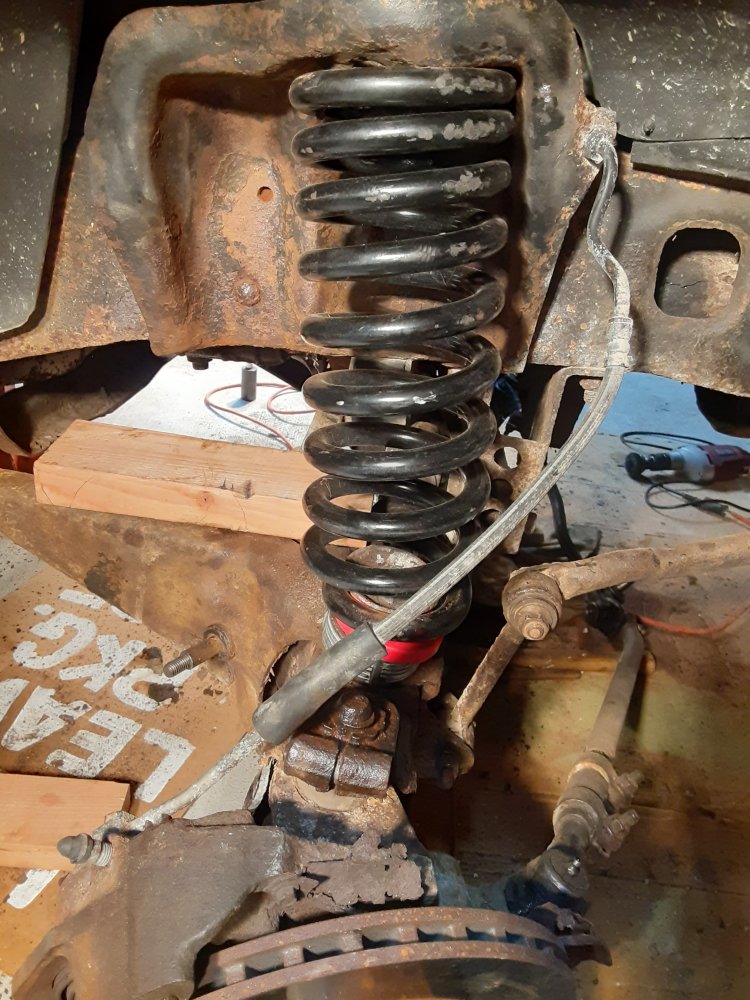

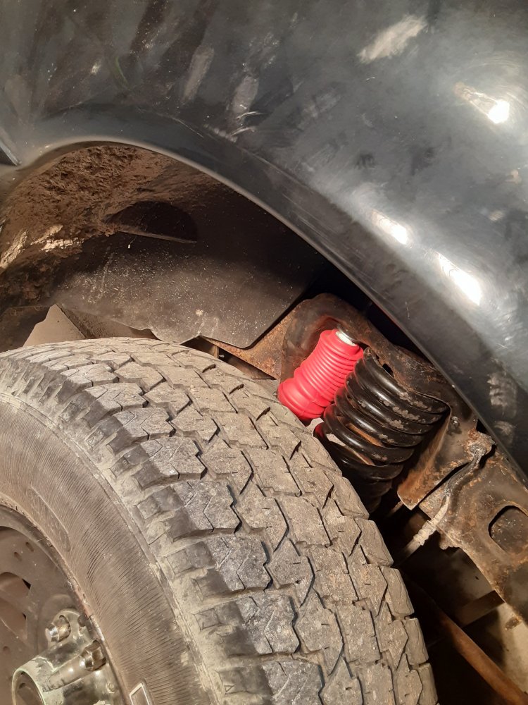

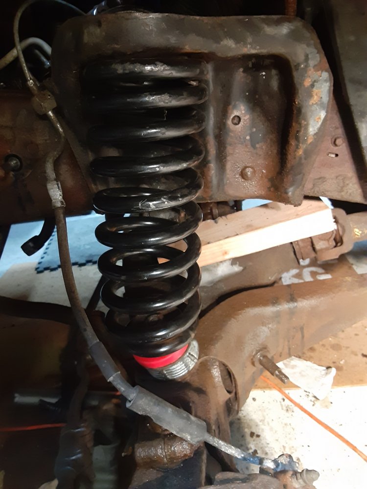

The springs arrived yesterday -- big thanks to Uncle Gump for the great price he gave me on the springs and shocks.
Anyway the springs are installed with a 1-inch washer lift which. by all accounts, should give me a 1-1/2-inch lift 🤞.
The shocks will be here on Monday which is strange since both packages (the springs and shocks) arrived at the UPS Distribution Center on the same truck and were processed two minutes apart.
Shocks arrived yesterday.
Finished late last night. Today I have to go back out and see what kind of mess I made of it all.😬
