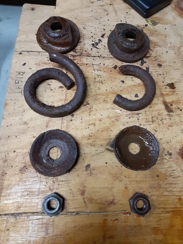

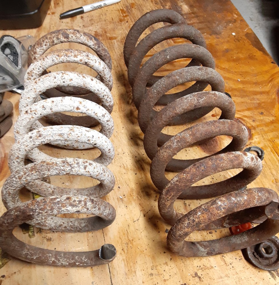

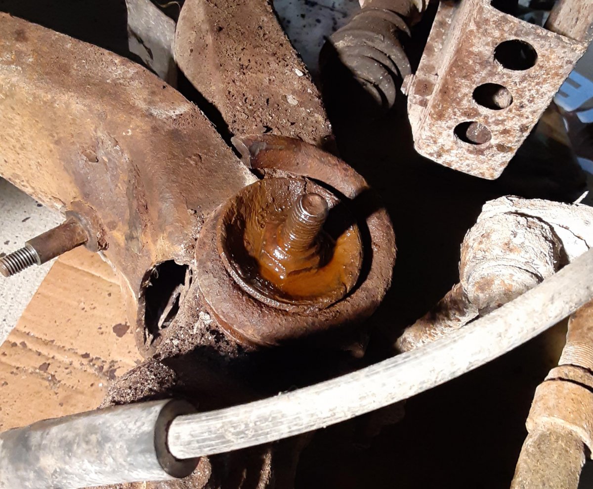

Removed both springs today --- lemme restate that...removed one spring today. I pried the top loose and it kinda fell out cuz it was broken at the last curlicue that wrapped around the seat. The other side wasn't broken so I broke it with cut-off wheel.:p

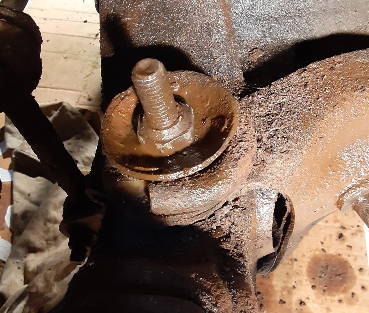

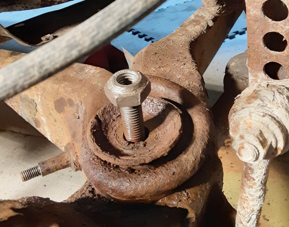

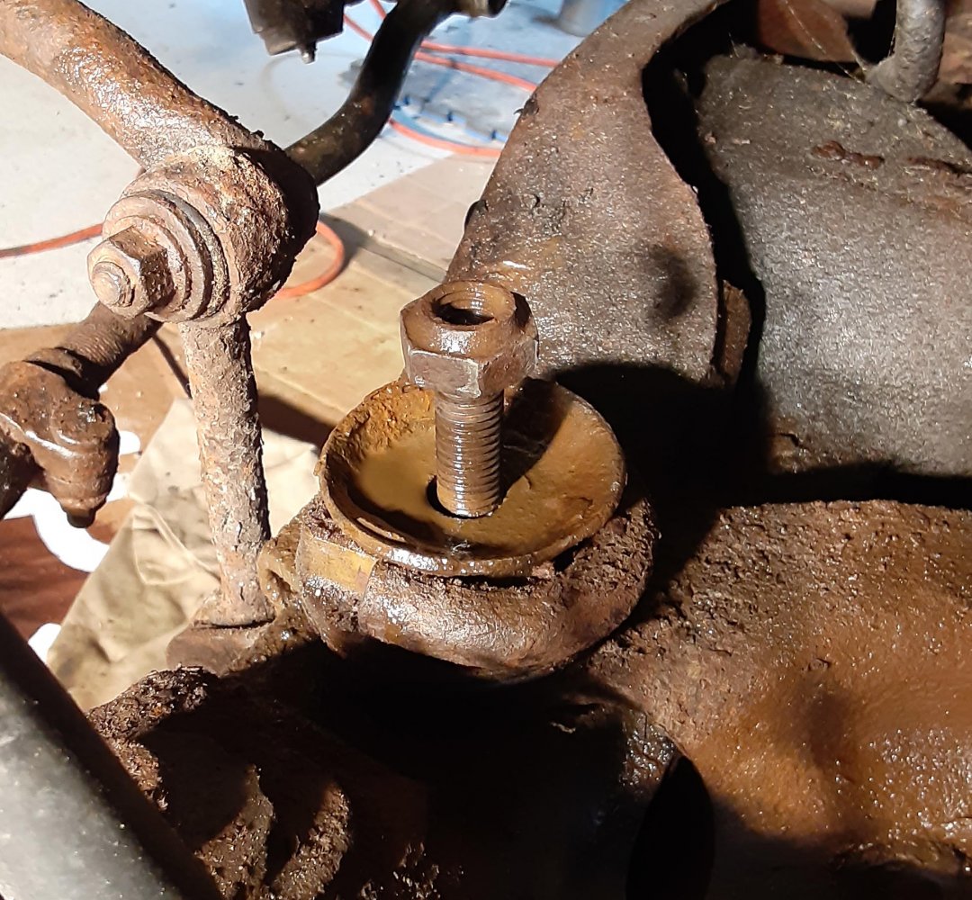

How in the heck are you supposed to get at that stud with the coil in the way. And of course the studs on mine are pretty corroded. Regardless, with or without the spring in the way, it looks like a deep well 26mm socket. 1-1/8 is too big. 1-1/16 is too small.
Tomorrow I'll be working on the studs and getting the nuts off and everything cleaned up.

It was 1 1/8
You can buy a super deep...I usually just weld two sockets together....or cut and extend with pipe....wire wheel the hell out of those threads....want me to bring you one? My daughter is in Rochester hills...need to pull her x mas lights down..
Torch is handy.
I appreciate the offer, but that would take all the fun out of it.
I used an open end/box wrench to measure and it was a bit loose so I'm gonna get a metric socket to see if I can get a tighter fit. The last thing I want is to have to replace those studs. :(

I think a 27 mm is closer. But a 6pt 1 1/8 is what I use....usually with a HD breaker bar to crack loose..then zip it off with a long extension. 3/4 or 1/2 in drive

My memory is hazy, but I think I just used a bigass deep socket and heavy duty 1/2" impact gun. I soaked em in PBlaster for a while...didnt need heat.
The extenders just go on top of the stud.
I have actual oem cast spacers somewhere too ...the 150 have them on certain packages.
The stud itself has heat release locktite in the beam. Not that it matters at this vintage in the rust belt.
Shit that rotten .. hard to say. I just break em loose with a breaker bar or a pipe on an end wrench ...then buzz em off with the impact and long extension....as the spring is usually still on.

You would have liked the ride. Next time, please let me know and Ann and I can arrange a proper welcoming party. Got one off using your prescribed method. Gonna do the other later tonite. Still in the barn but will upload images later...1and 1/8th impact and time worked damn good. Safe journey.

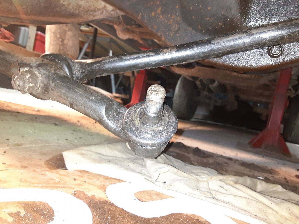

Well....it looks like I damaged the threads on the zirc fitting on the drag link...this one:
Haven't looked yet, but will prolly have to replace it unless I can file the threads open enough to get the nut on.
Still in the barn cleaning stuff...dammit. almost made it with no casualties
I have a drawer of zerks, they get smashed, many of the ones that come on stuff are cheapos. Swapping shouldn't be a problem, just mind the super coarse threads.
