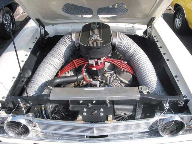

That was true...common practice in the days before CAI. Also they were available as "cool cans" and had the fuel line already mounted with inlet and outlets already installed. Still available from Jegs and Summit. Also many used to run flexible tubes from under the bumper or from behind the grill to modified air cleaners with cut-outs for the tubes. Brought air almost stright in from the outside.
Look up some photos from the old Ford ThunderBolts and you'll see the inside headlights were removed and replaced with 5-6 inch flex tubes running straight to the air cleaners.
The Olds 442 with the W30 and W31 packages also had a neat CAI system installed at the factory.
