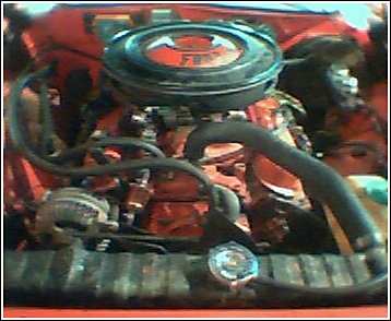

That is my second favorite Mopar induction system.

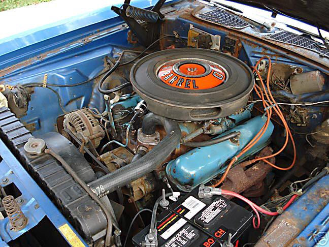

This is my 3rd favorite.........with number 1 being shaker naturally...

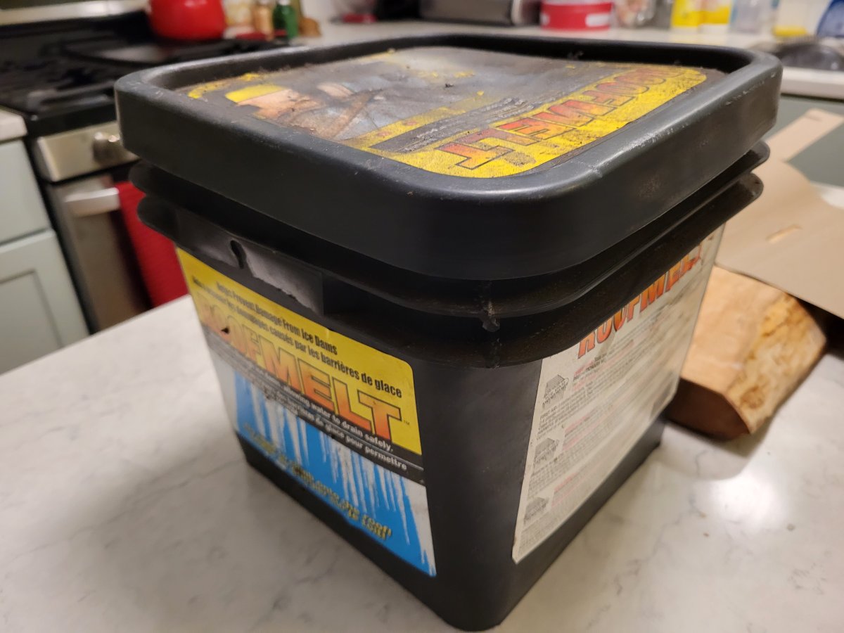

My plan was to use this two gallon square black plastic pail. It fits the space just perfectly. Then cut out a hole on the front side for the cold air intake just behind the headlight on the passenger's side. Then cut a circular hole for the snorkel opening and attach the filter inside. It's a little cold here right now in Minnesota (2 below in my garage) but I could start soon downstairs in my basement.
Be sure to put a baffle in front the hole behind the grill so rain water can't come in directly

Yes thanks, also a couple small weep holes in the bottom of that bucket to keep any moisture out.
