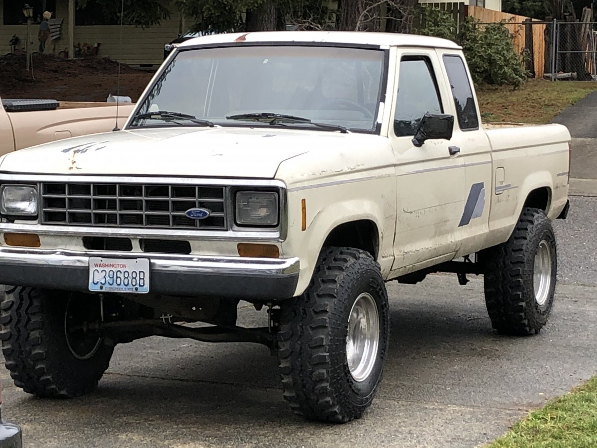

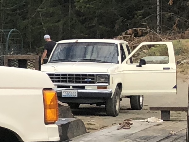

Here’s how it sits right now with a skyjacker 6 inch stage two lift with new radius arms.33 12.5 Swamper radials on 15 by 10 wheels. And a before and after pic. The fenders are trimmed very slightly. It’s not only the clearance issue it just does not sit tall enough For my preference. Iv decided to put a 3 inch body lift and some mild bulge fenders.

Even with the added lift I think more trimming might be your only answer for those tires.
I have the first flat land cut off on my fenders and I have 31s that clear fine at stock height.
With the bulge fenders that I am going to put on there will be no clearance issues.
In your first post you said you had a 3 inch body lift... are you saying you are adding another 3 inch body lift?
Sorry I didn’t see I wrote it like that until you pointed it out. I do have a 3” body lift I just have not put it on yet. I was going to try and get the lift I needed with a 2” spacer or an 8” coil spring and a 3” body lift before seeing the bulge fenders and felt there would be no need for additional lift the spring or spacer provides with bigger fender openings.
OK... it didn't look like you had a body lift in those pictures. Made me go back and confirm what I thought I'd read.
You have lots of options to get it where you want.
I would think if you have it handling well where it's at... you go bumping up the suspension... you just opened up a can of worms.
