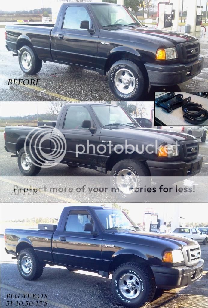

Truck: 2005 Ford Ranger XL 2WD
Lift: Spring Tech 2" Coil Space & 2" Shackle (copy belltech 6400)
Cost: $65 Shipped Ebay, Install: $150 Local Shop
After adding the costs of new tires and lift parts I decided to keep it cheap instead of the more expensive yet better option, spindles. Wanted just enough to tuck 31's. The back shackles were set on the 1" lift to even out with the front instead of 2". Will have my BFG's AT KO's installed tonight. Priced them at local Sams @ 161 per, Pepboys matched their price and beat them 5%. $152 tire. 31x10.5x15". Alignment looks good. Ride is good. More pics tomorrow with tires installed. Also since pic was taken, front bumper painted with Krylon Satin black, correct center caps installed, plastic bed liner, and tool box. Cost $85.
New to me 15" OEM Chrome skinned wheels, same tires.
Warn Trans4mer Winch Mount / Brush Guard with a Harbor Freight Badland 6k lbs winch
That should look great with 31s. The stance looks about right in the after picture. Have you checked your pinion angle after the shackle lift? I am still mid way on my own shackle lift and have not gotten around to checking for a change in pinion angle just yet.
I haven't looked yet. The fella that installed the kit for me told me it would be a good idea to add longer shocks for a better ride. Going off road last night made it apparent it would make for a more comfortable ride for sure. That will come later on in the year.
Added tires pic. Another plus of Pepboys match plus 5% is they offer free rotation with tire purchase every 5k. Defiantly satisfied with the tire installer/provider. Only time will tell if these spacers will be solid.
Looks great with the BFG KO's. I have them as well and love the way they handle and have almost no noise on the roads. Good looking truck, Bro!!!
I would be careful on the longer shocks. You may end up needing extended bump stops if you run lift shocks. I plan on running stock length shocks with Expo springs, extended shackles, and rear hangers moved forward 1-2 inches. I hope to get my rear suspension assembled tomorrow and get some better measurements, but then again I've been saying that for half a year now, so we'll see. Your truck does look good with the 31s.:icon_thumby:
Picked up the Chrome skinned steel 15" wheels this week from the bone yard for $40 a piece. Sold the Explorer wheels for $25 a piece. (Pic attached above)
