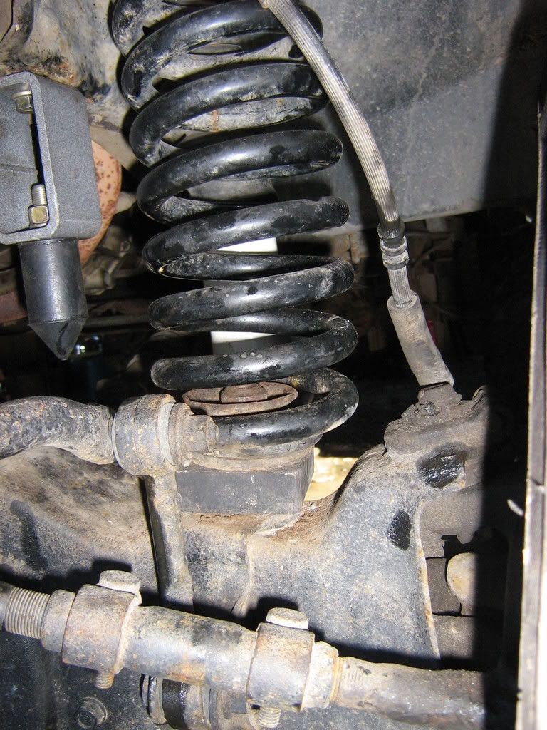

Just installed a set of one inch coil spacers i made, cut a square of inch steel plate and burned a hold in them with a torch... guess i got approx 1.5" of lift?? leveled out the truck pretty good though, and gave my swampers a little more clearance...
spacer:

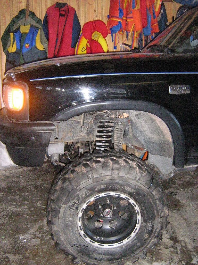

on jack stands:
leveled????
don't worry, sj extreme drop pitman arm is on the way along with an align
Yeow! :eek:
Yeah, that's not gonna handle well on the road at all, the arm will make all the difference in the world on that.
BTW, it should settle down some more once you take it off those jackstands.
haha yeah i know, i'm not driving it until i get that pitman arm on... scary stuff... yeah i had it down on all fours already too check out the stance... looks better IMO... just resting it on jackstands to keep the weight off the bias plys while its stored for the winter months...
Thats funny!!! Cuz when I initially lifted my BII my jeep buddys freaked at how tall it looked before we dropped it and rolled it. And yeah good luck with the extreme drop pitman arm I bet it still wont level it completley. Looks sick though I love the black.
