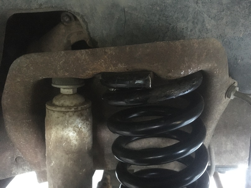

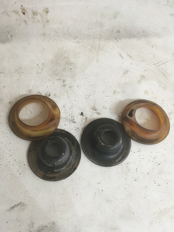

Broken coil spacer and tired springs. What would you do?
Do you know if they are the same on all TTB rangers?
Somewhere in my build thread there are a few pics of different seats. Ranger vs f150. I dont have easy access to the pics or i would post them.
And its been so long i dont remember the differences...
The ones on my d35 are same as the ones on my d28 so 83 to 97 ranger explorer at least you can still get the isolator via lmc
I think they are all the same

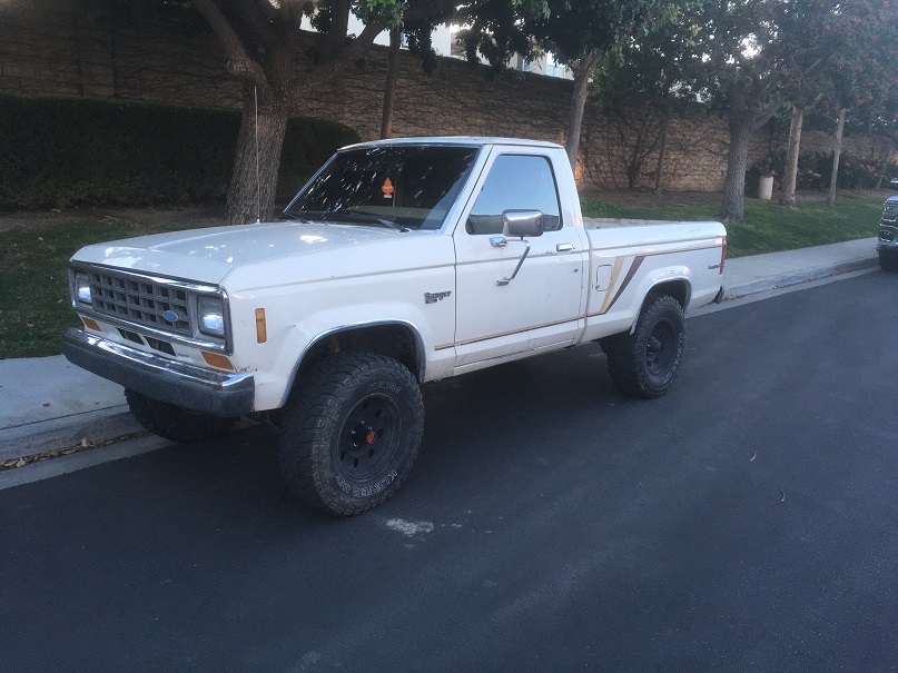

We got it all put back together and it sits pretty awesome! So far it is slightly higher in the front than the back I am measuring from the top of the body line, not the wheel well. I'll get pictures later today.

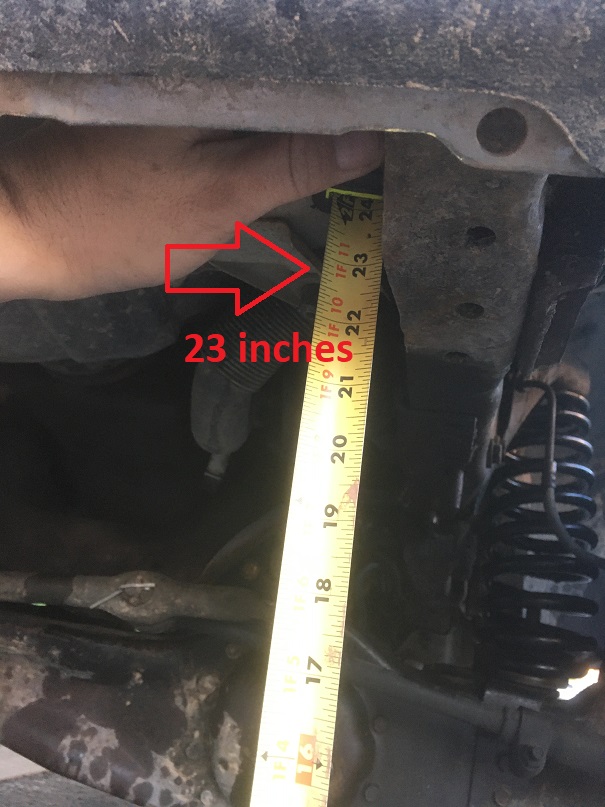

Here is the driver side frame rail to the ground:
72425

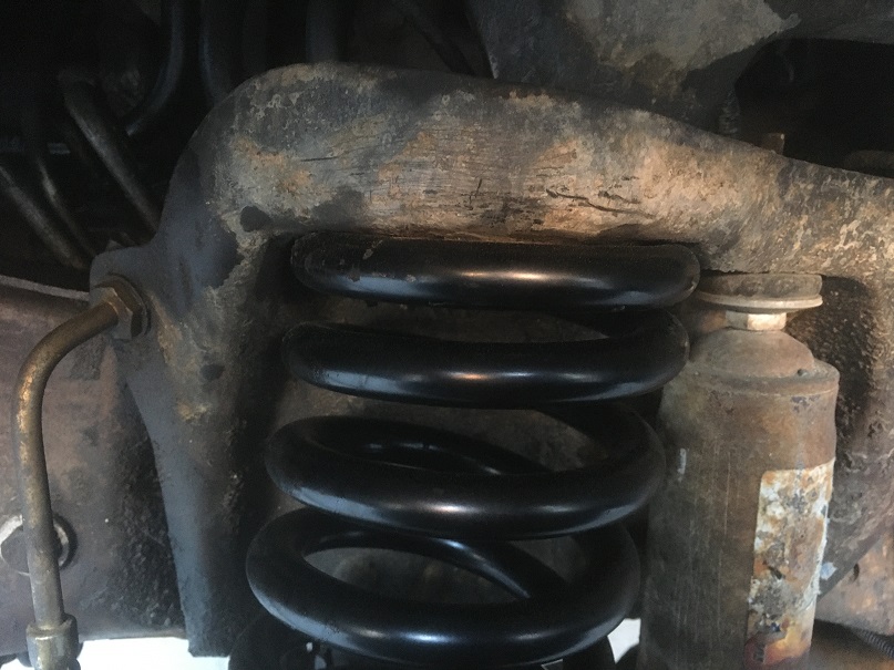

Driver side spring upper and lower mounts. These look correctly seated to me.
72426
72427
And Passenger side (I say 22.5 inches but really, as you can see in the pic, it is a little over that):
72428

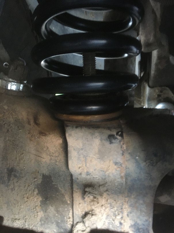

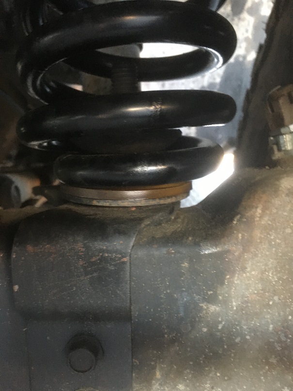

upper and lower spring seats:
72429
72430
I am posting this more so I have a "before" off-roading. I'll re-post similar pics next week when we get back. Anyone see anything we should address before we go?
Adjustable bushings? Did you ballpark the alignment?
I ballparked mine, but can't test it yet cuz it's freakin' Michigan.
It looks like it is "sitting pretty," as they say. If anything, you might have a little positive camber (listen to me -- I've done it one time and now I'm an expert o_O).
Check that alignment The bearings on D28 don't like misalignment and 31inch tires
