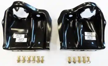

looks like I broke a coil bucket on the passenger side. are the 4x4 buckets different than the 4x2 buckets? I seem to remember that they are, but I found an online supplier that says they are the same.
That is what I found... any other sites suggestions?
Also for those that have done this job... what am I getting into here? anything I need to know? do I need a spring compressor? any other things that will need to be removed to get these changed? obviously the shocks... I guess it would be a good time to change them out...And if there are any walk throughs for this job out there, they would be greatly appreciated.

If TTB, it doesn't seem like it should be too bad of a job. Get frame up on jack stands. Remove wheel. Support axle beam. Disconnect shock. Disconnect brake line. Remove nut holding bottom of spring. Then lower axle beam down until you can get the spring out. Then grind the heads off the rivets and drive them out with hammer and punch or pneumatic hammer. Install new bucket with bolts and re-asssemble in reverse order.

Thank you Eric! it is indeed the TTB. I was hoping that your answer was the way it is supposed to go. Now for the million dollar question... do 2wd and 4wd buckets interchange?

2WD Bronco II or 2WD Explorer buckets will interchange with a 4WD Ranger, but 2WD Ranger buckets I recall do not.

Well it is now. This is the one I kit bashed out of a 2wd and a 4x4. The only thing I had to modify was the holes for the brake lines weren't shaped quite right. A minute or two with a Dremel and a rasping bit fixed that well enough.
so the truck did have a 4x4 frame then... I may go ahead and drop the 160 bucks on them. I don't have welding or deep fabrication skills or the shop to do it, but a little bit of fine grinding is not an issue. I just want the main mounting holes to line up with minimal cussing and rework
