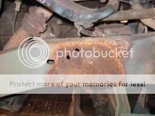

Here is a pic it snuck in on, looks terrible don't it :D
That doesn't look that bad to me... Maybe I'm just not seeing it. :dunno:
Check behind the bucket where it's up against the frame, and on the top around the 'fingers'. Any severe rust/cracks/holes in those areas would be bad, but what I see there some rust converter & paint should fix.
I pulled a 1-1/2x1-1/2x3/16 piece of metel out of it, it left a corrisponding hole with dead sharp edges right behind the shock. No way to get a pic of it without pulling the shock.
It is crap getting behind the bucket that caused it, 95% of the part looks fine to me. The 5% worries me enough to get it added to the to-do list though.
I know whereabouts you're talking (crap gets into that 'pocket' behind the mount and traps moisture in there). Yeah, I'd definitely replace it if there's a hole through it.

When I removed the buckets on my race truck I found very thin metal in the frame. Thin enough that I punched a hole through with a hammer and punch without trying. The bucket was good tho, so I welded some plate to the bucket and bolted the buckets and plates back on. It's lasted so far.
Posts 41 and 44 in my race truck thread give more pics.
That is a concern... and why I want to get it fixed as soon as I can.

The JD buckets are a bolt in replacement. If you have frame problems fix those first. If it's not too bad I'd hit it with a wire wheel and some POR15 or similar. The JD buckets will house either RBV or EB springs and can be run in a stock application. They allow you to run dual shocks if you choose but a single shock can be mounted if that's what you want. They require eye to eye shocks so you can't reuse your factory ones.

The more I think about it the more I like the Duff buckets, by eliminating the pocket it actually fixes both the problem and the cause. Not sure when I am going to get to it but that is the current plan.
